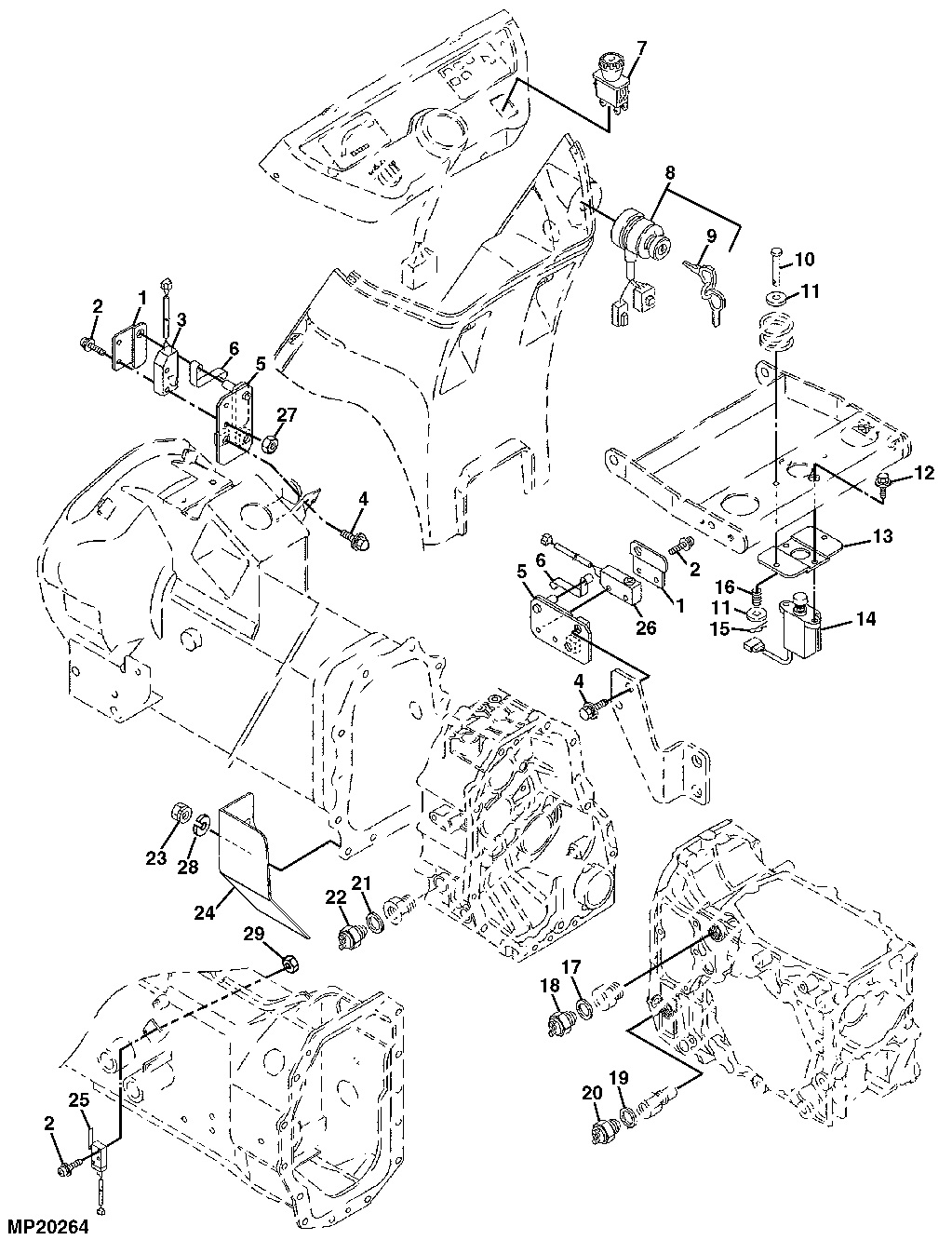

/ John Deere 4100 will not turn over #13
here's a picture of the parts breakdown, it says number 20 is the neutral safety
switch on a hydro:

that neutral safety switch should be easy to test.

Well hot dog!!!!!!! I just got it to turn over! The schematic really helped. The neutral safety switch had come unplugged. I plugged it back in and as soon as I got it all out back together, She fired right up. Huge Thanks for all who helped and posted. I learned a tremendous amount about my tractor. I just hope it will help somebody else too. Again thanks for the help
