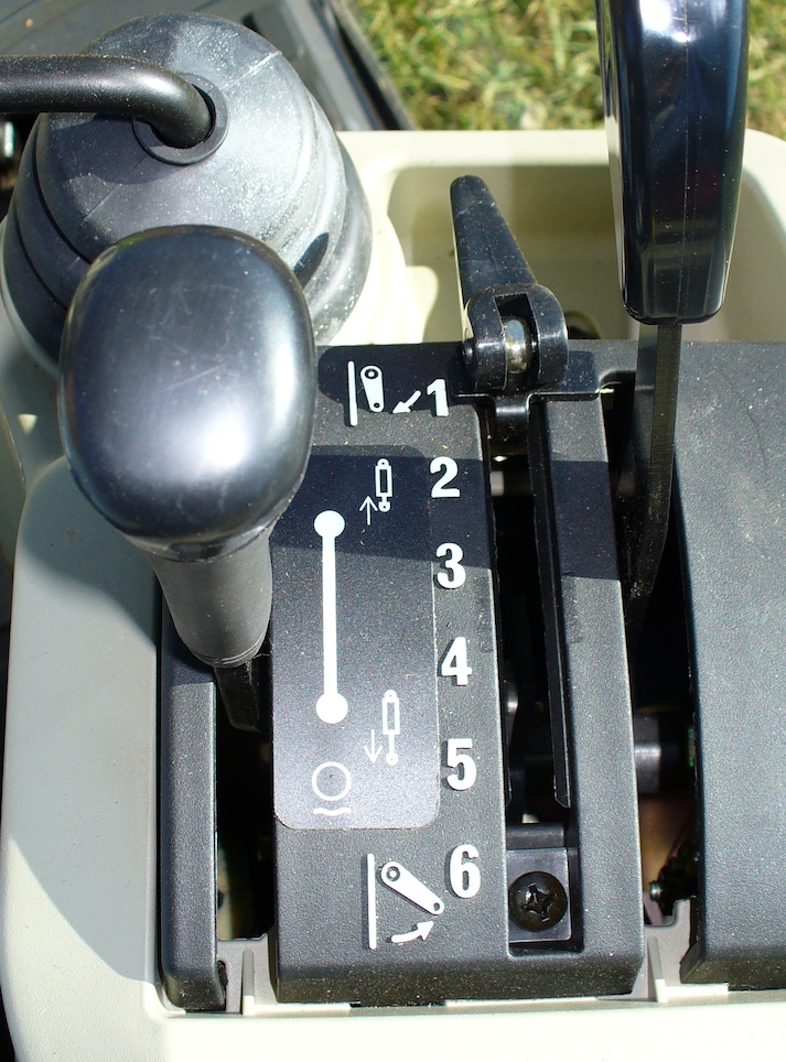

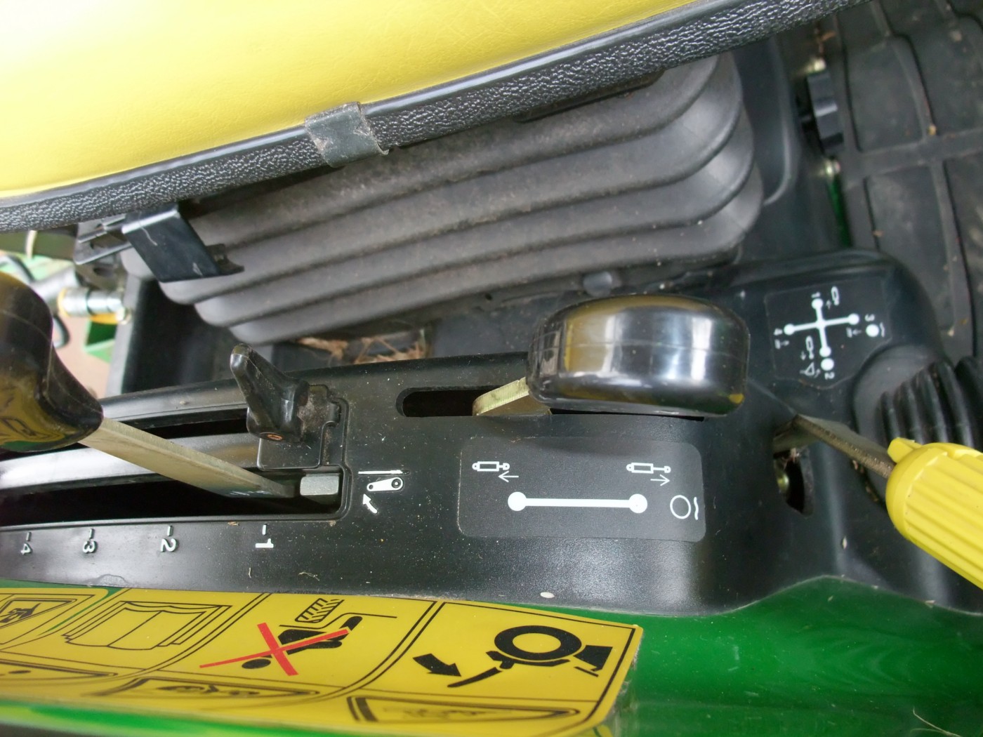

With the tractor OFF, Try rotating the mid PTO by hand and have someone move the lever untill it falls into place. I had the same problem when I first got my 3520, and this seemed to resolve it. The internal gears may be out of sync.
That did it!!!! Thanks for the information. I also corrected the problem with the Rockshaft Lever Control by loosening the nut some at the Rockshaft housing. I purchased my radio yesterday so now it's time to get it installed.
