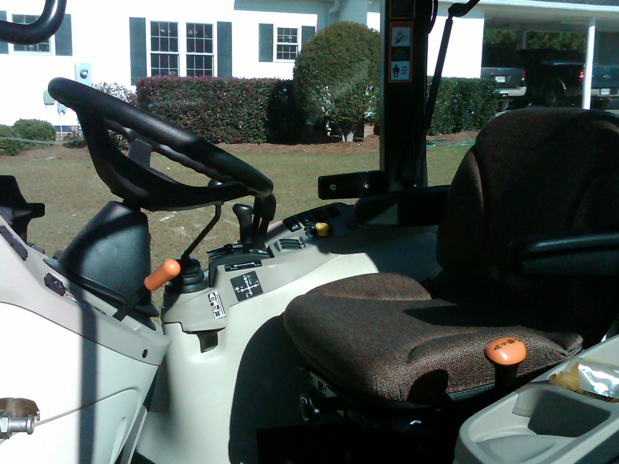

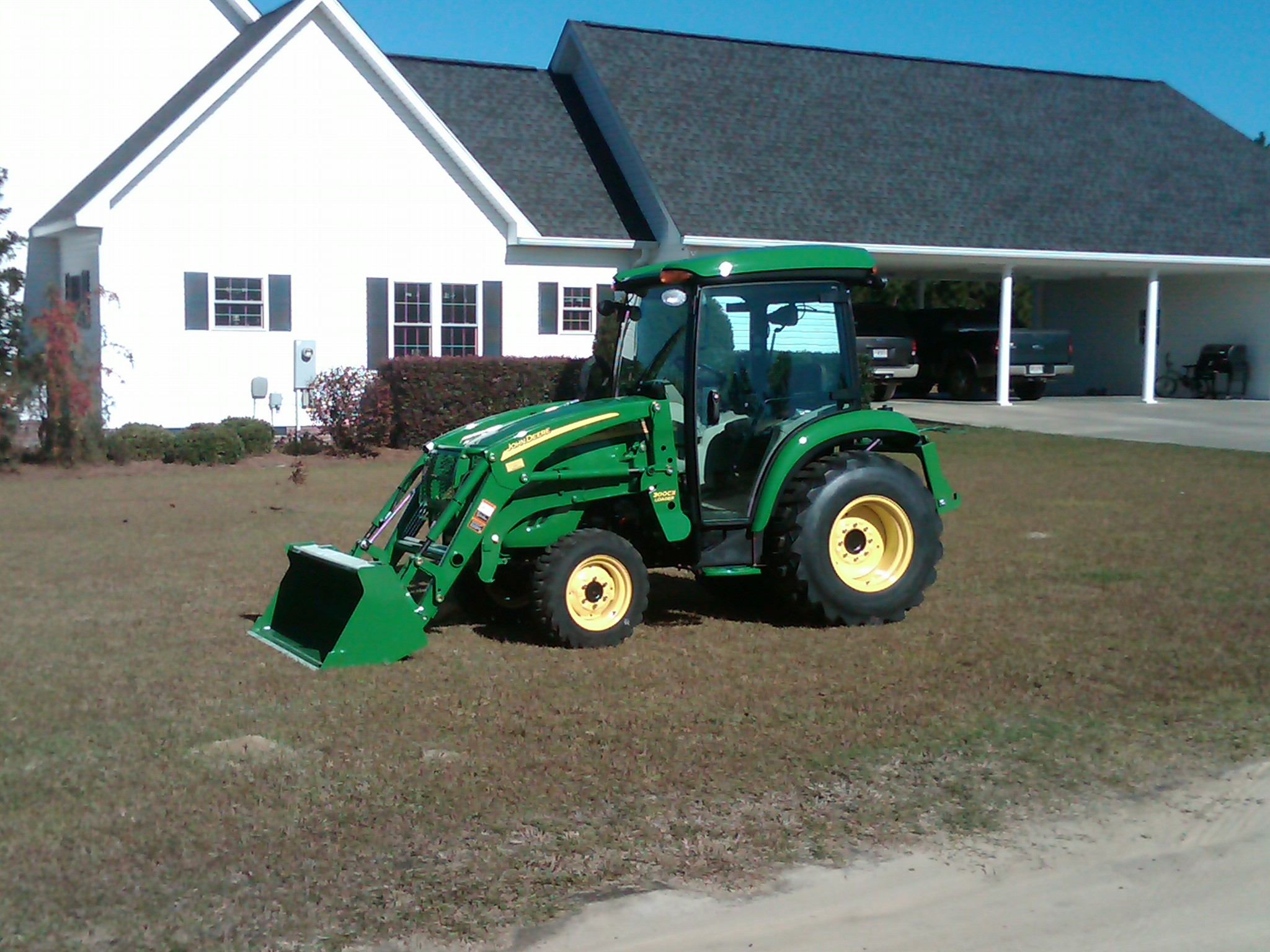

Here are the pics of my new 3520 with cab.
   / John Deere 3520 with Cab on Order #30
Clint,
Very nice setup you have there, looks like a good base to start from with the QA fel and IMatch. Enjoy your new tractor.
