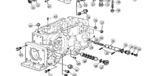

Tx Jim, Thanks for the information. I'll see if I can find the 28-31 hyd relief valve and remove it, clean it etc. From the drawing it appears it is near the screen ( to the right) of the screen. Thank you! Mark

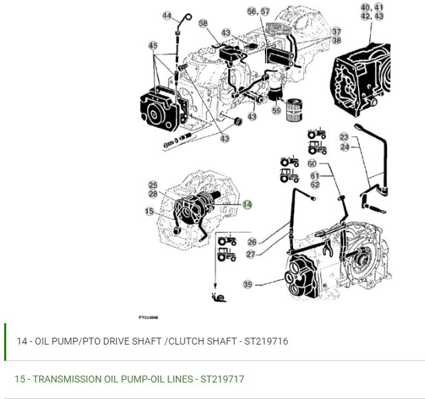

Back to "sump" which is the transmission case. I had the PTO clutch line break. All worked fine until the PTO was engaged, then all hydraulics failed, since trans pump was only pumping to sump via the broken PTO clutch line.

I finally after 6 months got my tractor back from the repair shop in Bostic NC... The issues were... The brakes were just about to be metal on metal..They replaced the brakes.. They found a pipe inside had cracked / split. The rear pump was supplying plenty of fluid to the front pump but the front pump was not building and flowing enough. They removed the front pump and found nothing but decided to replace the housing and that worked. They then found the valve( forgot the name) just under the brake pedal was not working and repaired it.. So far she is running and flowing... Thanks for all your input... This was a huge job...
