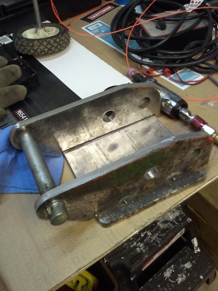

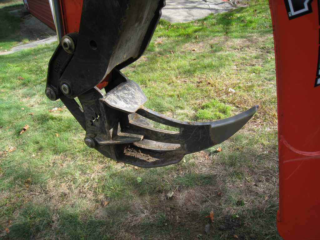

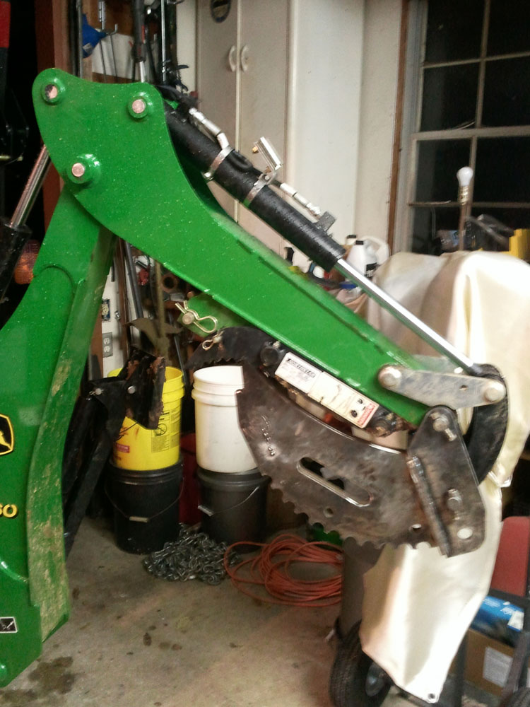

I took mine to a shop and had it professionally welded after I tacked it together. Here's a photo of my ripper that I bought from MetKit. Your design is very good and I'm curious to hear how it performs for you. Nice work.

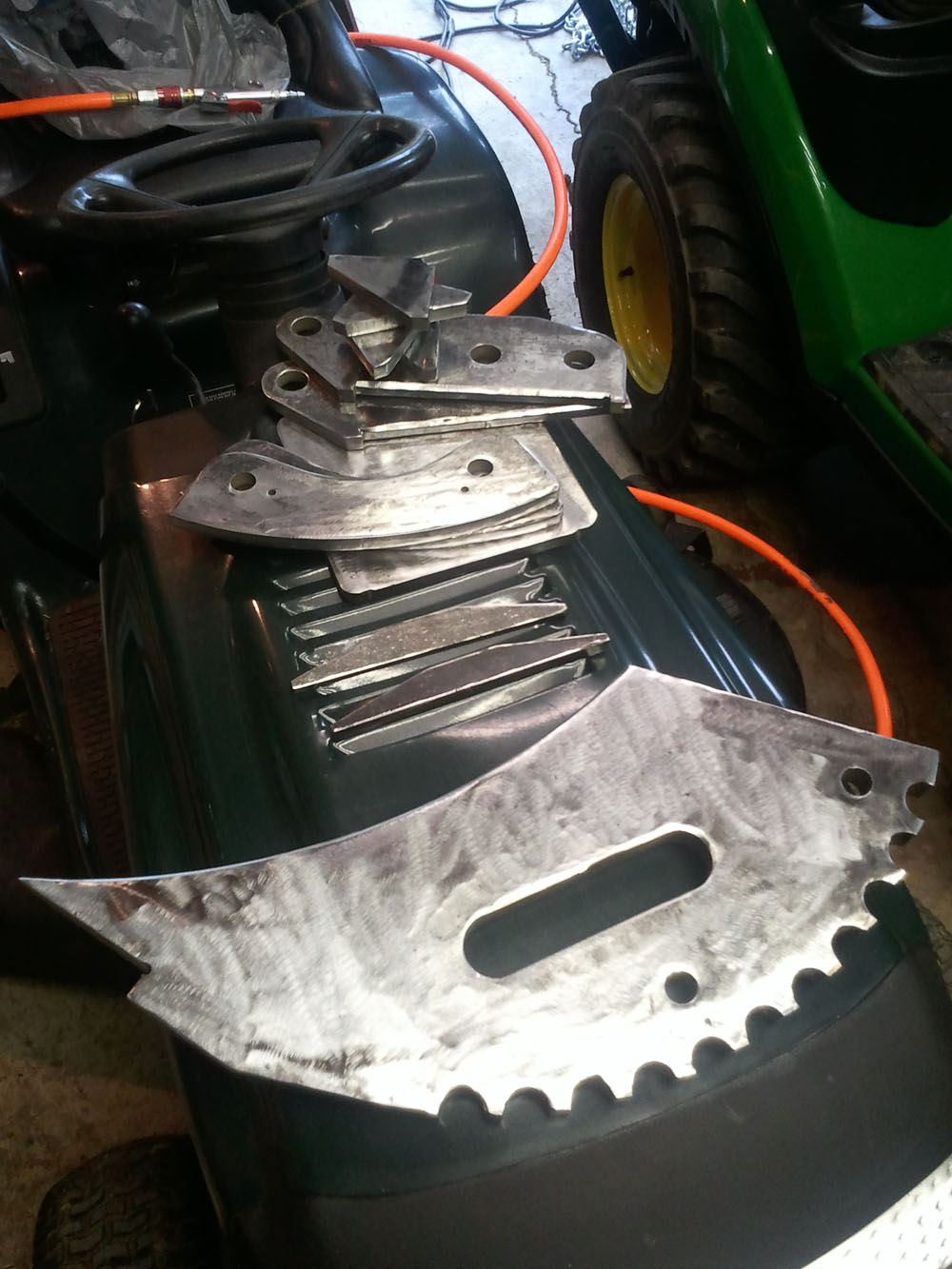

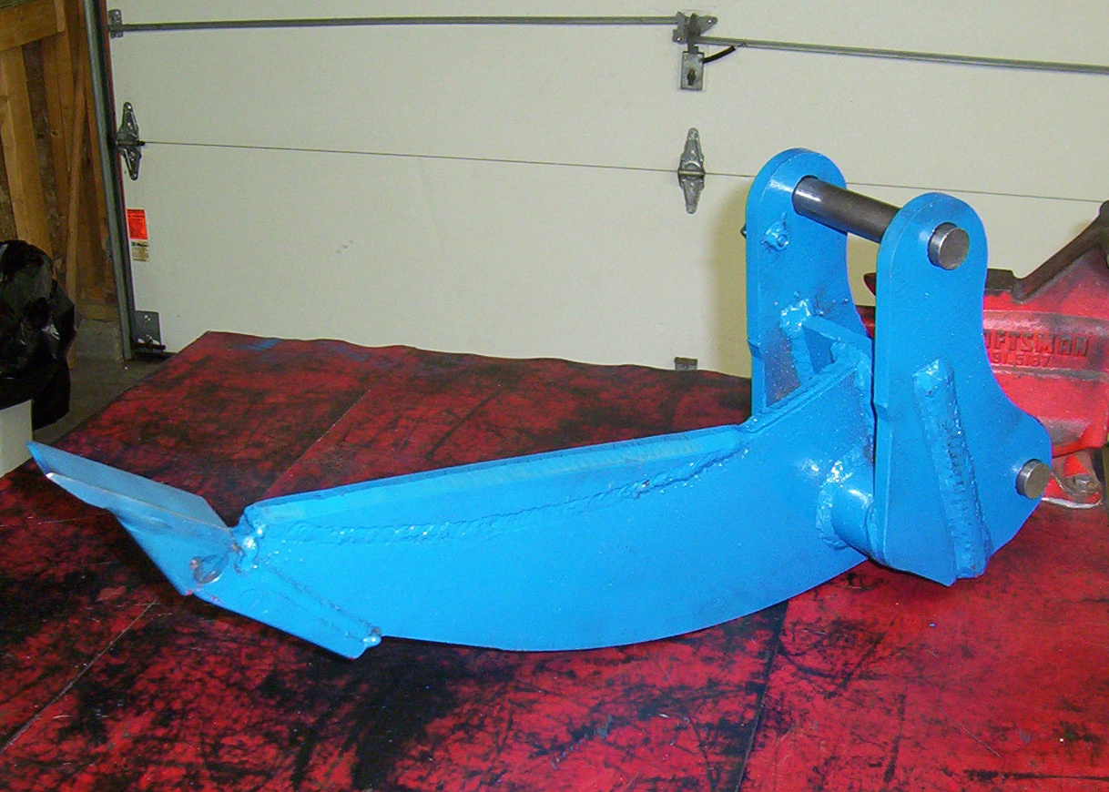

I got the knife edge ground on the front and used the welder to cut a bevel on my ar400 cutting edge.

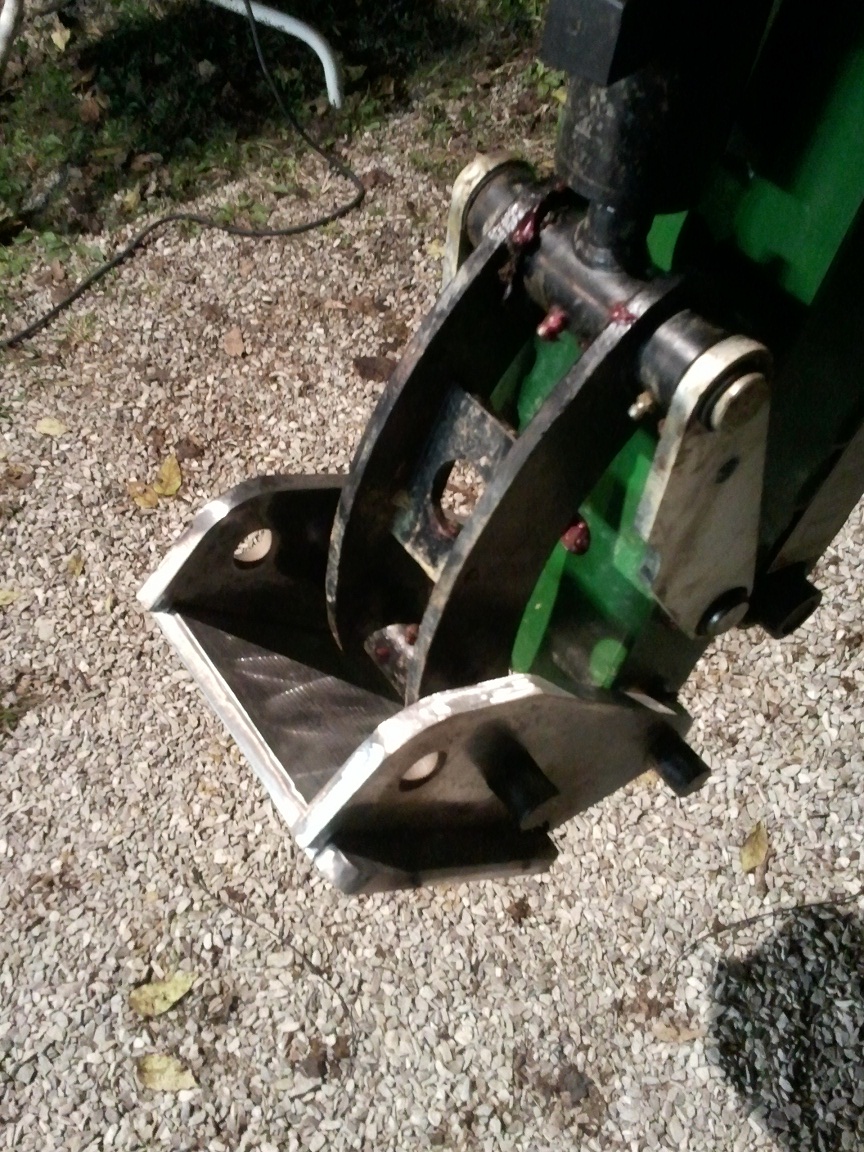

Here are some pictures from when I had it tacked together to test its range of motion.

I put a convex grind on the ripper knife edge, hoping to get more durability and less work with the grinder. According to this website it is a very good design for what I'm doing...

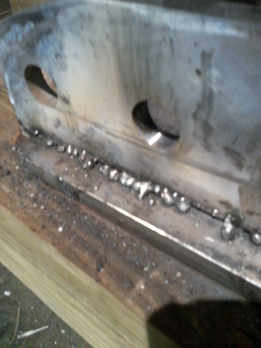

Are you using an AC or AC/DC welder? I assume you know about 7018 not liking AC you need 7018 AC rods.
With that out of the way the recommended range for 1/8 7018 AC according to the box of Lincoln electrodes is 90-135 Amps. On my welder for the same electrode the range is given as 90-160 Amps. Either way you look at it 155Amps should be plenty.
I agree with the guys who recommended you take this project to a professional and learn to weld on something else. Or you could burn up a bunch of rods on scrap metal before welding on this fantastic looking ripper. Because it looks just that : fantastic.

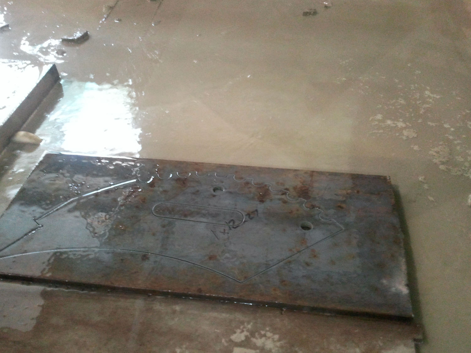

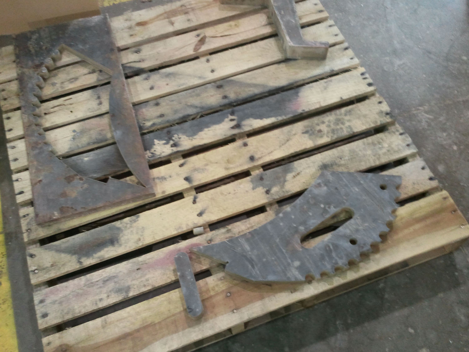

I've got a couple of requests for a dxf file which is attached. I modified the teeth to provide more of a rake angle and a larger gullet for chip clearance.

Here's a gif of the changes to the teeth.

That last dxf file was in autocad 2007 format and cannot be opened by earlier versions of autocad. Here's an autocad 2000 format file for the older software. By the way, I fixed my welder and did it myself. It looks pretty decent and works great. I tried to break it but nothing happened. I still need some 1"ID x 1.5" od tubing pieces to retain the pins. If anybody has some scrap I'll buy it.

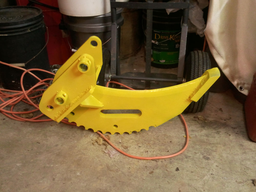

I just finished the bushings to retain the bucket pins and sprayed on a primer coat because it was starting to get rust spots.

I assure you the paint will be removed with your first couple of stumps. And, after developing a thin coat of rust, another stump job will shine it up again.
Don't get paint in the pin holes or it will be a pain to mount.

I got some paint inside the pin holes but I plan on taking it out with my die grinder.

The ripper didn't work as well as I wanted it to. The breakout force is much better than the bucket 12" bucket, but I had higher expectations from reading everyone else's posts about the brotek. I never built the pin-on cradle for the back of it because I was waiting until I made contact with somebody who could bend 1/2" plate. If it had the scoop on the back it wouldn't sink into the ground as bad. Right now it lifts the front of my machine off the ground when I curl behind a big root. The teeth will chew up a root, but it's still slower than using a sawzall with a tree pruning blade. If the tooth geometry was optimized it may work better, but they get bogged down because they are so wide if you don't take light cuts. The pruning blade doesn't get dull in the dirt like a chainsaw blade. The battery powered dewalt I had wasn't up to the job. I had to put an extension cord on my milwaukee to cut up about 8 roots that were over 12" in diameter yesterday. A trencher would be better if you could rent one, but since I already own the backhoe, it works well. I haven't tried to pull any stumps with it yet, just cleaning up the trench as I dug it. I guess i'd give it a 7/10 given my high expectations. Worth doing, but not as great as I had hoped.
As far as the dimensions, they were a little off. I measured a lot of points with a tape measure on my backhoe to draw it. It doesn't hit my boom, but when fully curled it touches my thumb.
Concerning future design changes, I am going to change the chipping tooth geometry to provide a more aggressive cut by introducing 3 serrations into the front edge. The teeth on the back are okay, but could be better if they were a finer pitch since it's 1" thick. I think 3/4" or maybe even 1/2" would be strong enough for the swing on our 260 backhoes. This would improve cutting ability.

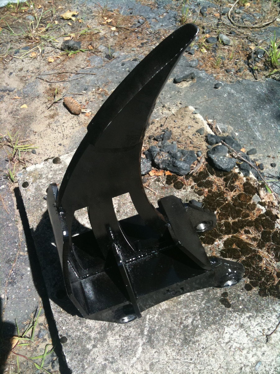

/ john deere 260 backhoe ripper #38
I had a ripper fabricated by Michigan Iron and Equipment that includes a backplate which serves two purposes. First is that it scoops out the spoils kind of like a hoe and therefore allows me to dig with the ripper. The secondary function is that the backplate prevents the ripper back from sinking into the dirt and therefore when I curl it actually excerts upward force on the root. I've attached a few photos. It would be easy to modify yours.
I also have a thread on my ripper in the attachments section if you search on ripper and Island Tractor.
I like the rippled cutting edge you put on the back of your ripper. I would put a few similar divots on the top of the front blade to snag the roots that are not cut with the first pass. That would cut a chunk out and make the next pass more effective.
