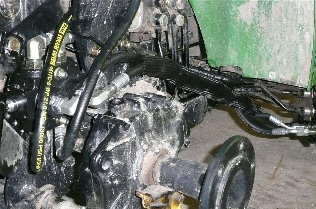

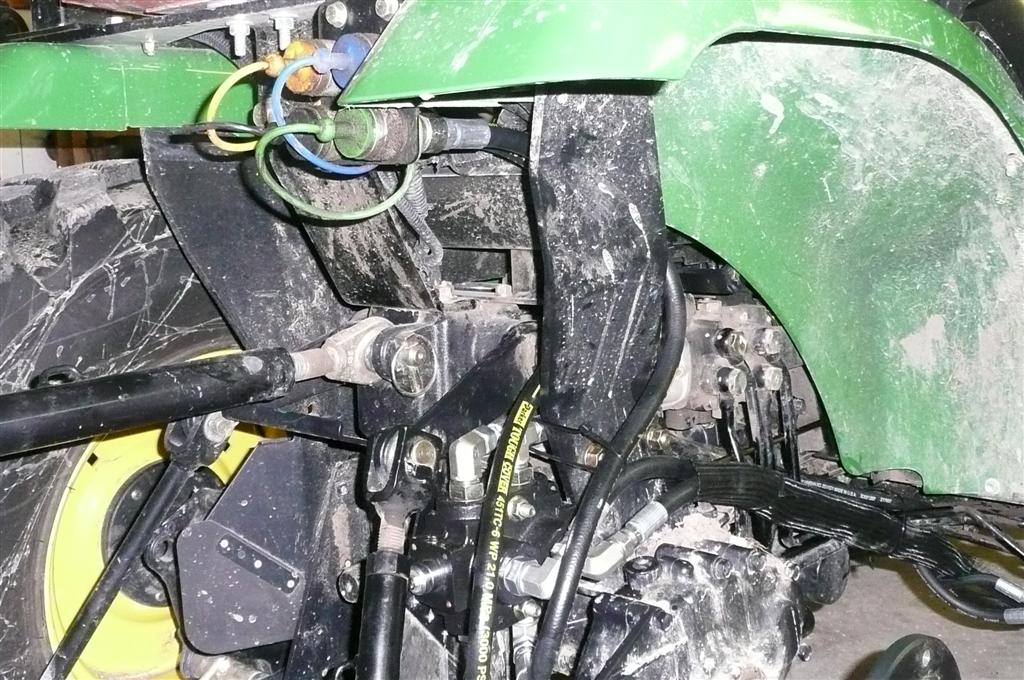

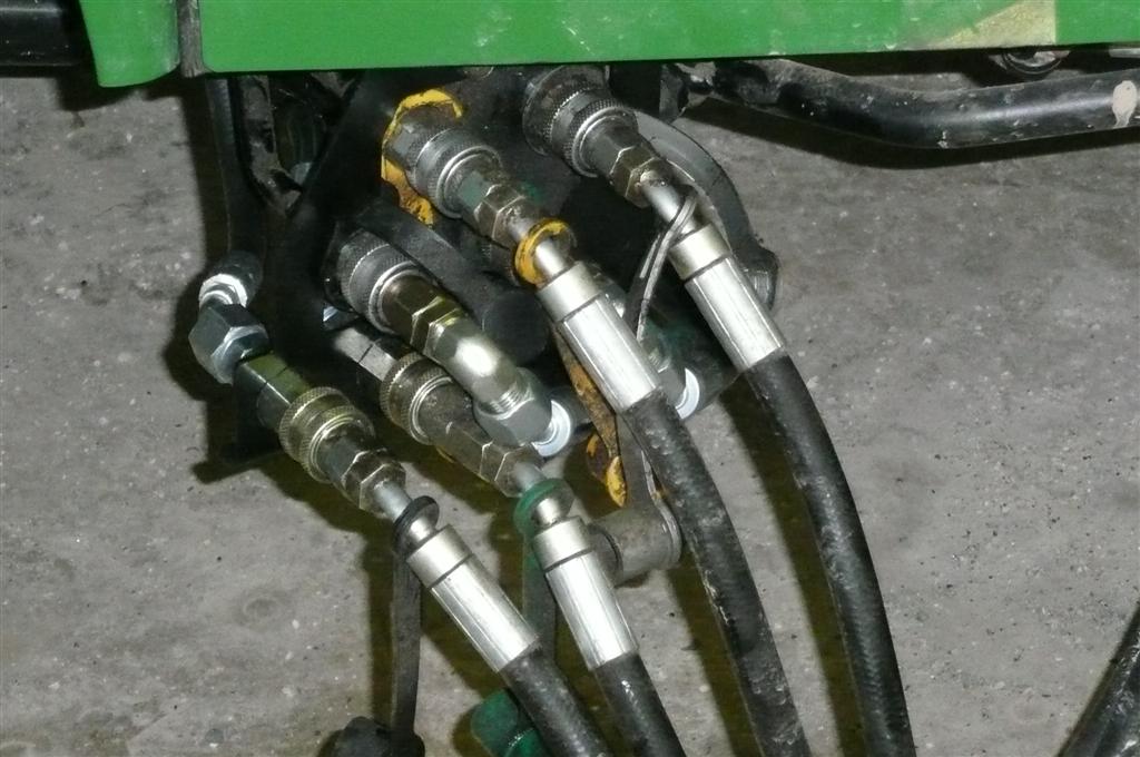

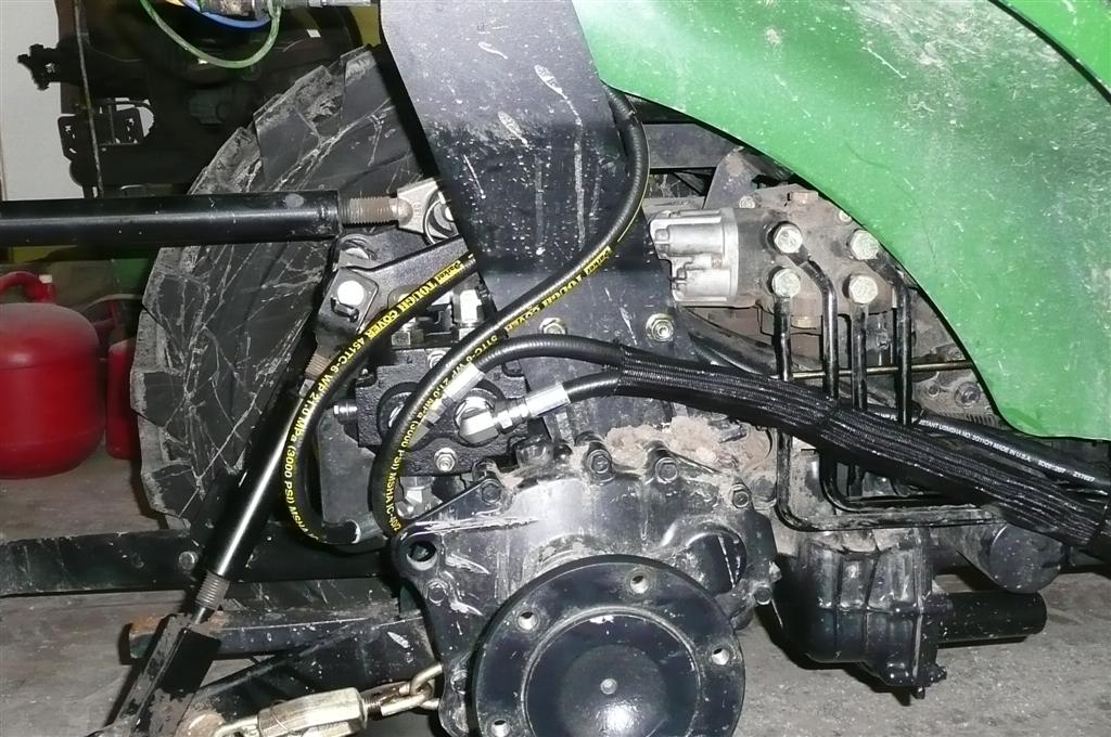

Put the kit on today. Went well, only one trip back to the dealer for some different fittings. This kit will allow me to have the loader on and hooked up and also have my pull type box scraper at the same time. When I want to use the hydroaulics on the scraper I pull the handle by my right foot and disable the raise/lower function of the loader and now have raise/lower function of the scraper. I may also install a cylinder on my rear blade for next winter.
Picture 1 shows the valve. The two hoses that run up are going to the rear outlets of the re-router kit that I already had on tractor.
Picture 2 is another shot of the valve and hose routing.
Picture 3 gives a shot of the rear outlets.
Picture 4 is what my mid SCVs look like now with the loader hooked up.

Hey Nate, The rerouter kit is four hoses that you hook into the mid SCV and has 4 outlets to the rear. The outlets in the picture on the back of the tractor are from the rerouter kit. You have to unplug the loader in order to use the rerouter kit.
The diverter kit gives only 1 extra function. Like I said in my situation, I will be able to have my loader hooked up, and have my pull type box scraper hooked up all at the same time, however, in order to raise or lower the box scraper I have to pull a lever by my right foot and divert one function on my loader (the raise/lower on loader) to operate the box scraper. Your situation, would be the same except you would only be able to run one of the cylinders, unless you could Y it somehow and put valves on both and switch that, if that makes sense?
