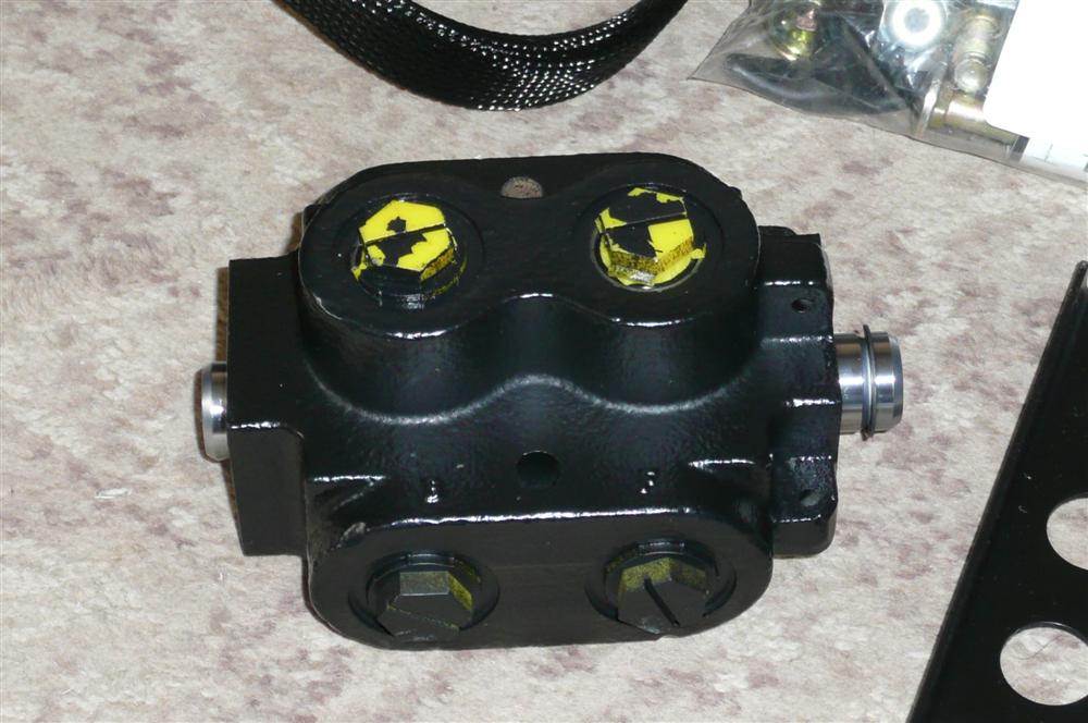

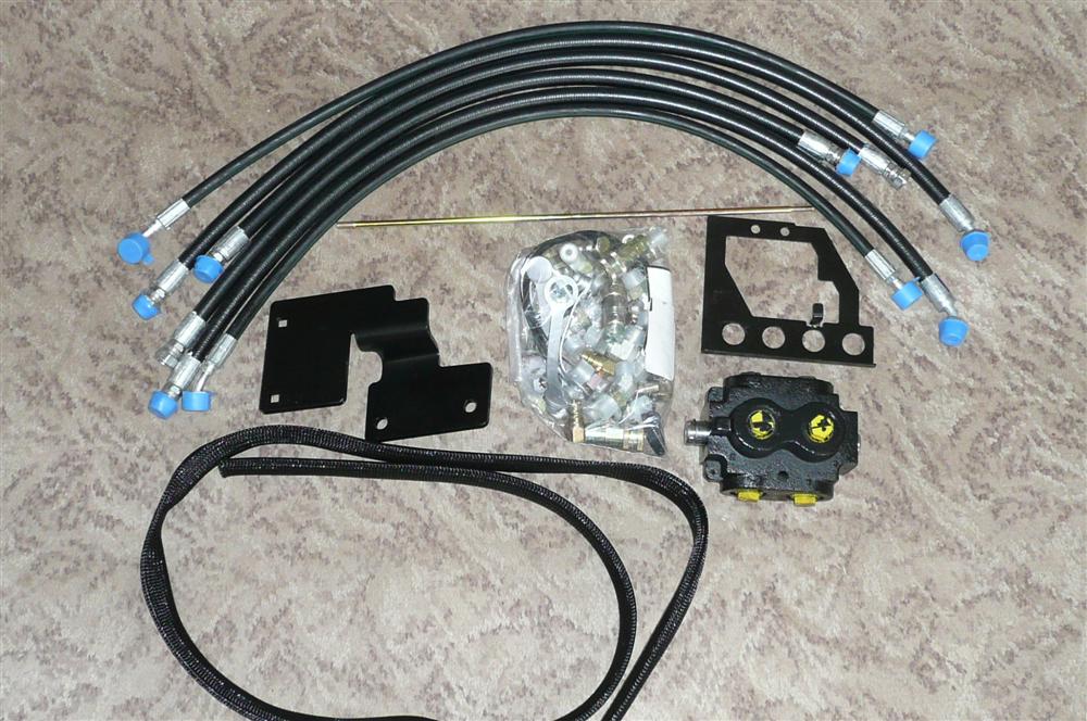

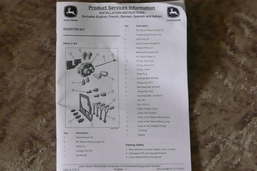

Got my kit today and took some pictures of the kit. I will install it next week hopefully, will take more pictures. Stay tuned!!

Wow, you are SO lucky. The kit for the 3x20 tractors look to be much more involved. This is 90% of the kit, there are a few more peices not pictured here.

Part No. LVB25823 $393
It will give a extra pair of couplers but you will lose either the up/down or roll/curl of the loader when switched to it.

No, its manual. There is a push/pull T-handle that is located behind your right heal.

The kit has a bracket that mounts the extra 2 ports next to the mid SCV. Just to let everyone know, it only gains one pair, so you have three pairs of SCV ports. When you useing the third SCV you loose one of the orginal functions.
For my use as an example, I have a pull type box scraper that I use and want to be able to use the loader if needed, so all I will have to do is pull the knob. I am going to mount the third ports on the rear of the tractor.
The kit I got had the wrong size fittings (the elbows that thread into the valve) so had to take back.

Put the kit on today. Went well, only one trip back to the dealer for some different fittings. This kit will allow me to have the loader on and hooked up and also have my pull type box scraper at the same time. When I want to use the hydroaulics on the scraper I pull the handle by my right foot and disable the raise/lower function of the loader and now have raise/lower function of the scraper. I may also install a cylinder on my rear blade for next winter.
Picture 1 shows the valve. The two hoses that run up are going to the rear outlets of the re-router kit that I already had on tractor.
Picture 2 is another shot of the valve and hose routing.
Picture 3 gives a shot of the rear outlets.
Picture 4 is what my mid SCVs look like now with the loader hooked up.
