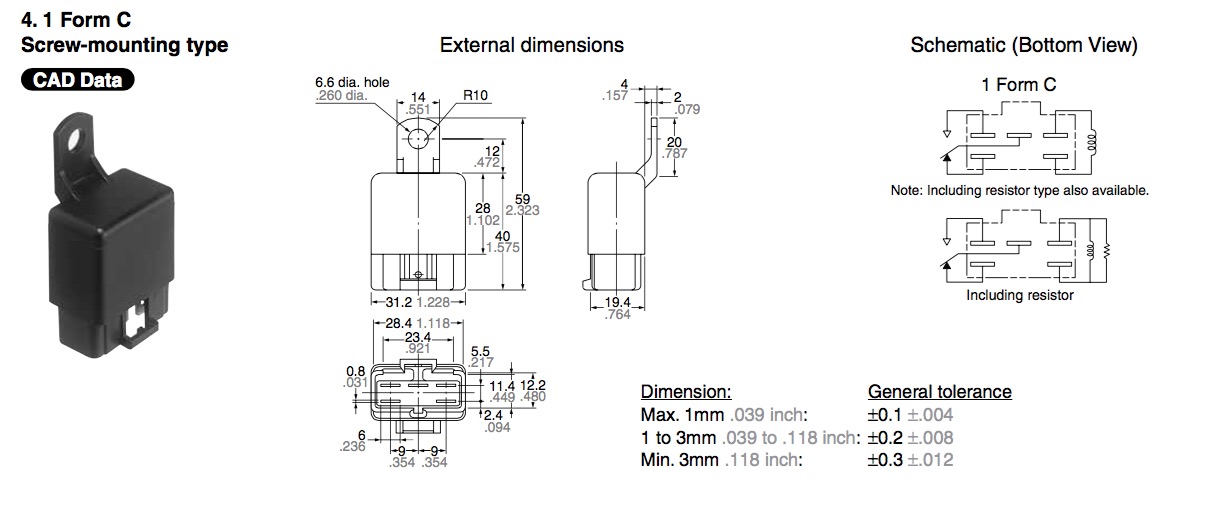

I know that this an old thread, but I wanted to chime in an share the word that if your K5 Safety Relay tests to be defective, you can save a lot of money by buying the relay from an electronics supplier. My local John Deere store wanted $100.80 for this part, but I found it online with a quick Google search using the manufacturer part number (CA1-DC12V-N). The average price of this relay from electronic parts suppliers (Mouser, DigiKey, etc) is about $7.00.
This part is not made specifically for John Deere; there is no custom name, sticker or markings on the relay. For John Deere to mark up the replacement part nearly 1,500% is insulting to their customers.
The K5 Safety Relay is located near the left side of the tractor behind the panel. You will need to unscrew the instrument panel and then unbolt the plastic panel. On my tractor, the K5 Safety Relay was taped with black electrical tape to the same cable harness that connects to the voltage regulator.

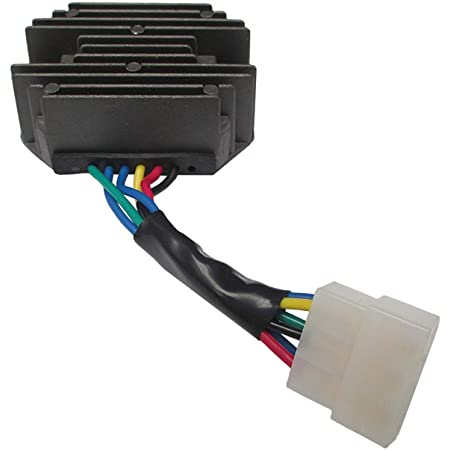

My experience with charging issues on my 2305….My problem solved..
Not charging at all, would keep battery on a tender, start tractor, use it, wouldn’t restart without being on a jumper or charger.
Tested relays and fuses and everything seemed good. Purchased a 255-2725-ND 6 pin relay which from what forums say is the K5 saftey relay, and a voltage regulator off ebay.
The john deere version relay was 95$, found a non JD brand for 8$. The JD regulator was over 100$ found a generic one off ebay for 20$. When I got the regulator it didn’t work immediately, then realized the wiring wasnt matching up to the OEM colors. I matched colors as best as I could. There is 2 blues, a red, a white, a black and a green. The ebay regulator doesn’t work if u pin them just like the OEM. I google a pic (pic below) of one and pinned it like the pic and boom…I have 13.5-14.5v.

Im assuming the glow plugs were staying on, over driving the alternator and voltage regulator causing the regulator to blow. It had melted some of the rubber insulation on the back and smelled burnt. I also think it has hurt my battery since it has been cycled to below the power level it likes to live quite a few times.
Hope this helps someone…..this was racking my brain!
