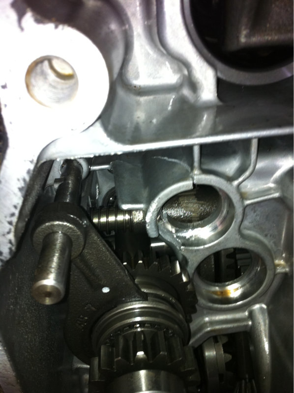

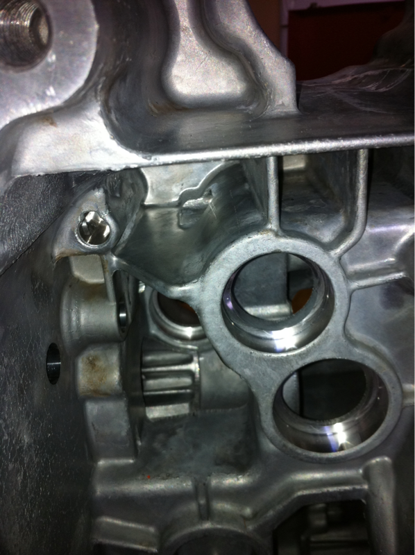

G'day
I'm from Australia , I own a 2305 and the rear pto went on me as well. Cost $2500 for parts only. Have photo of new housing and old housing. 2006 model only 264 hours on it.
John Deere knew there was problem with that area , rectified it but failed to recall the tractors.
I'm giving john deere a hard time see what they got to offer.
Regards Terry

Can you confirm the transmission was redesigned after 2007?

Is there a way to visually tell if a 2210 has the newer or revised transmission housing. Im looking at a 2004 with about 250 hrs. but i dont know when they started using the redesigned housing.
   / John Deere 2305 Compact Tractor Transmission and rear PTO failure #30
Especially since they have re-engineered it to make it heavier. That's like an admission of deficiency. They should at least supply the parts at cost in that case.
Just so us guys know the heavier case did not completely solve the issue, I broke mine. No help from JD.:confused: I had a hard time but I upgraded to 2320 for pto use.
