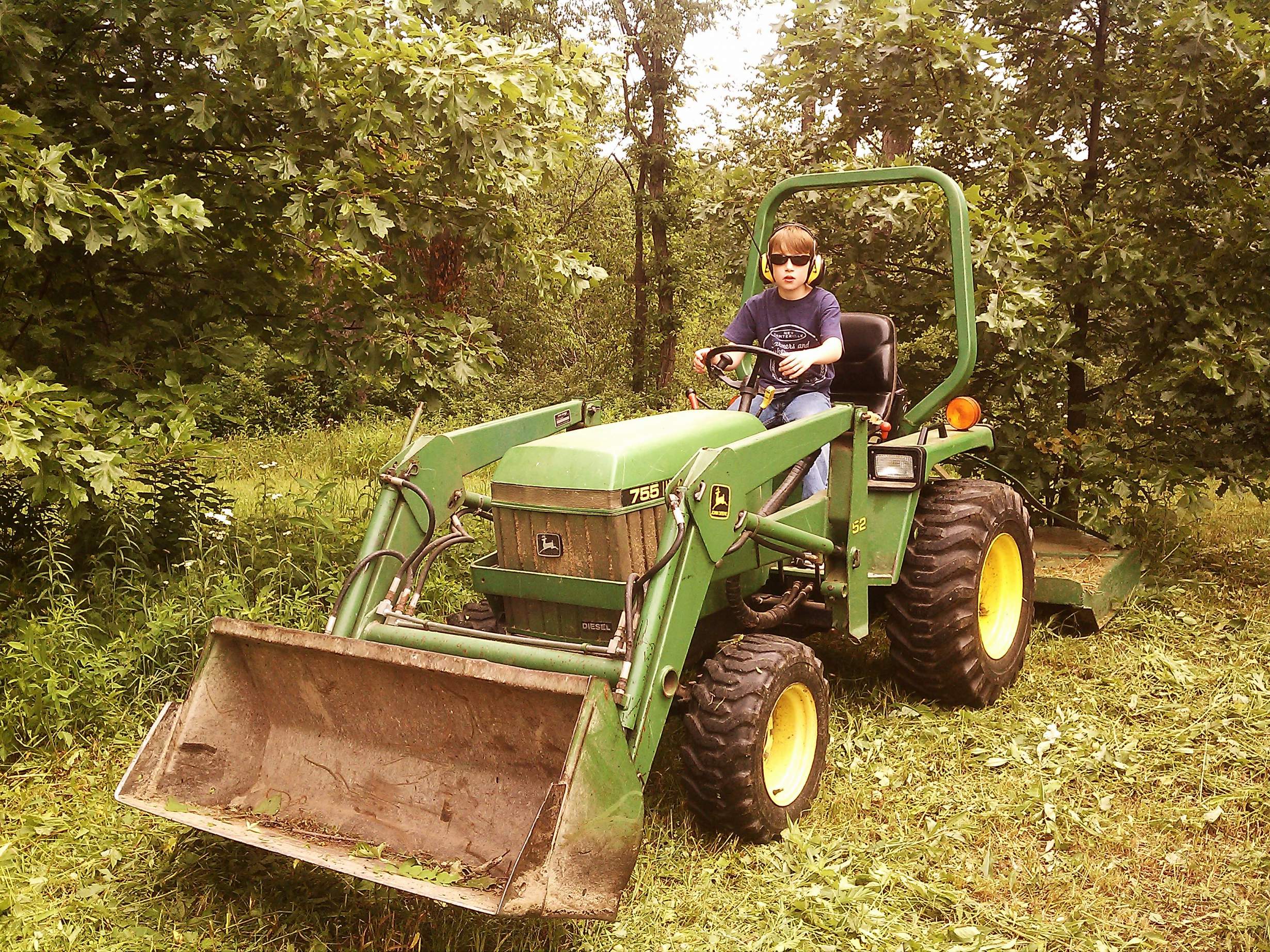

phone 075.jpgI gotta say all the newer Deere stuff doesnt impress me, I looked at 4300 used, 4310's with E-hydro (electronic this that and the other!!) with the dumb lag time on the peddle, and the aluminum rear housings are BAD, BAD, BAD. I bought a low hour 955, simple tried and true. Also, bought a used Bobcat 763 to abuse on my construction type work. I could not believe how durable my old 755 was, I used it like a DOG for loader work. **** of a unit.
