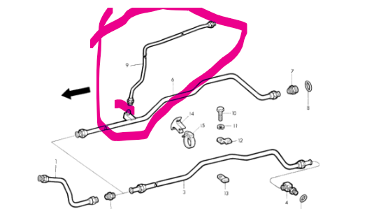

I did notice a small power steering leak, at the bottom cover (in front of the shift lever, above the brake pedal, at the botton of the steering column basically). Could a small power steering leak stop the hyds from working? If so how can I cancel the powersteering (do i just plug the line at the flow divider?) I think it only leaks if I turn the steering wheel, but when I get the chance I will test.
/ John Deere 2130 hydraulics scheme #10
I think a small external leak won't affect hyd performance. I suggest to isolate power steering from hyd system by disconnecting PS supply line(item 9) & cap fitting at pink slash mark to check if power steering is the hyd problem

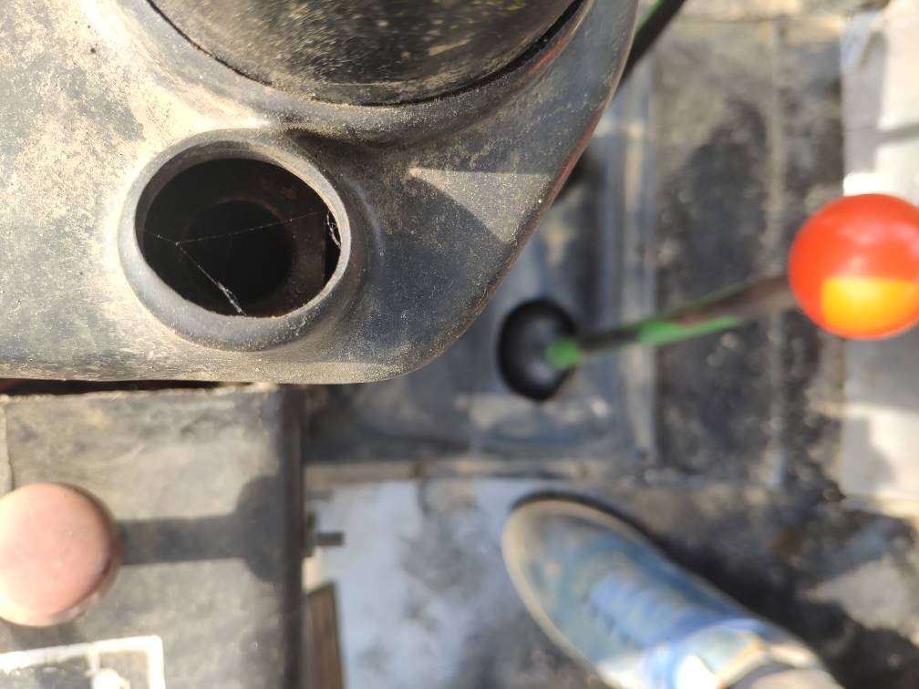

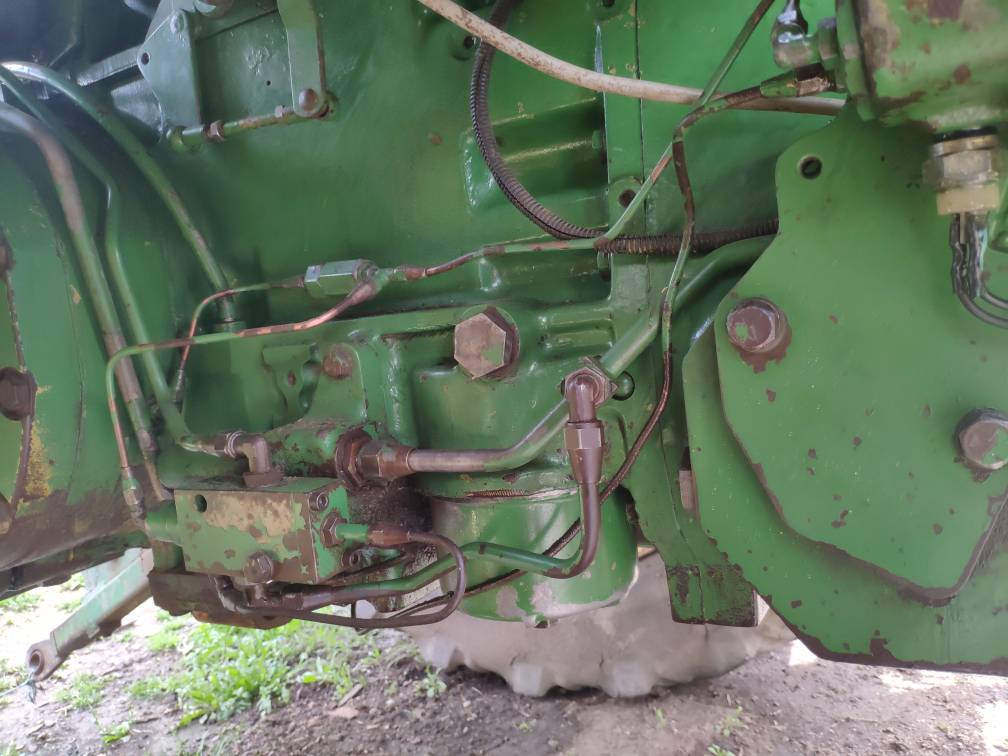

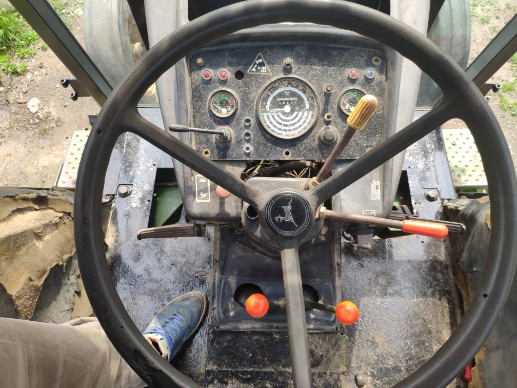

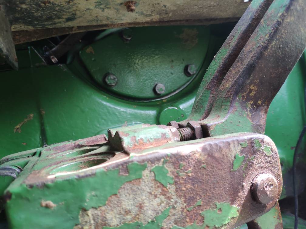

Hi guys. Today I got to see the tractor again. I think I might have the Hi Lo unit (but the dash lever is missing, second photo). If the Hi Lo is broken, could this also cause loss of hydraulics (no oil returning to the auxilliary tank). Thr third photo shows where the small leak is located (that cover with screws).IMG_20200501_110828.jpegIMG_20200501_110838.jpegIMG_20200501_110915.jpegIMG_20200501_110927.jpegIMG_20200501_110950_1.jpeg
/ John Deere 2130 hydraulics scheme #13
The hi-lo is one of the low pressure funtions that works from the gearbox pump. The others wil be 4x4 and IPTO.
There wil be testports for them ...all on the shiftcover.
U need to fit gauges on that testports and test them one at a time by starting your tractos and engageing and disengageing those funtions and noting down there pressures. In the hi-lo you have to note down the hi pressure and the lo pressure.
The same with the IPTO and...
/ John Deere 2130 hydraulics scheme #14
DLTTrekkers
And to think all the yrs I thought JD utility tractors hyd systems of this era on tractors built for sales in N america were complicated. The hyd's on JD tractors I'm acquainted with won't come close to be as complicated as their European cousins.

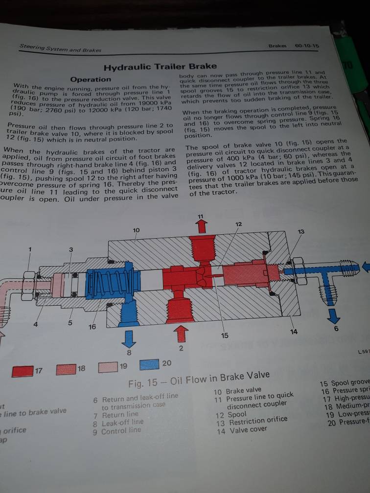

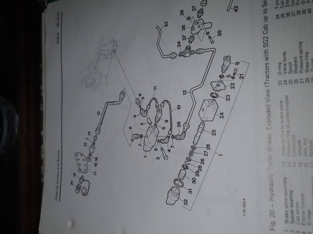

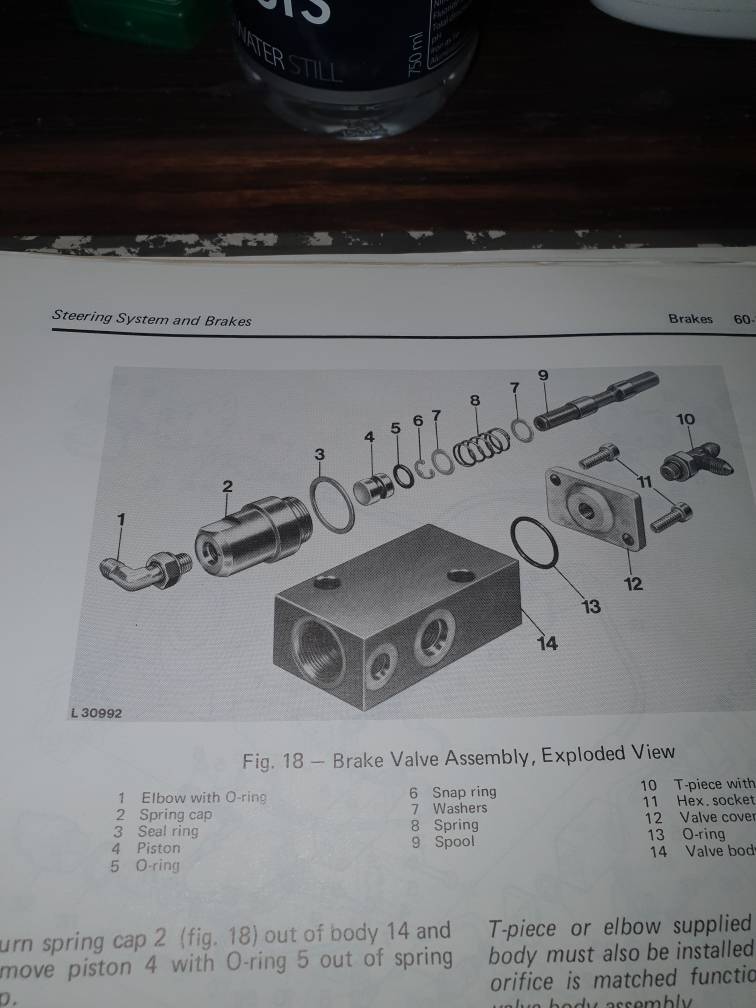

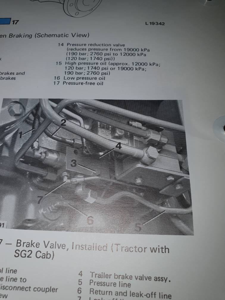

May I ask the function of the rectangular valve body in the photo? It resembles a valve body on tractor with open center hyd's.
Thanks,Jim

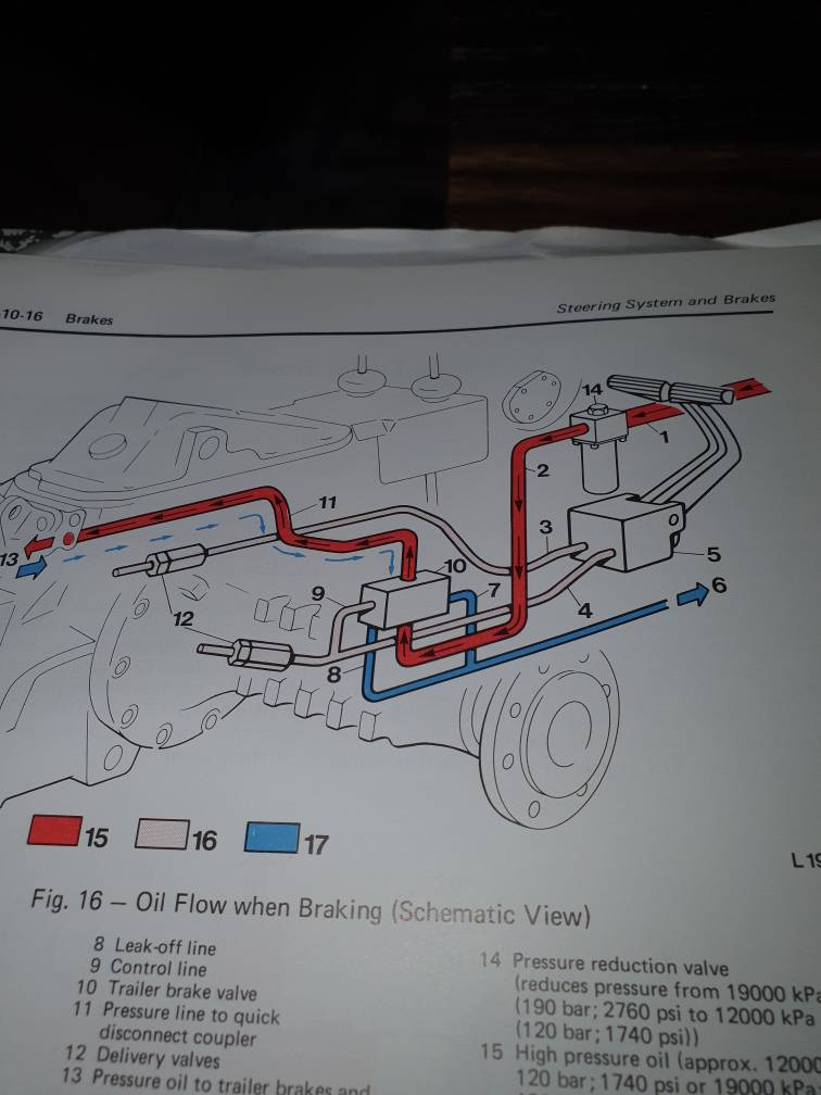

/ John Deere 2130 hydraulics scheme #15
I do not know that valve ! My gues is that the tractor is equeped with a trailer brake sisteeme and that thin pipes is connected to the brakemaster silinder ?

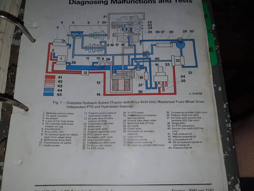

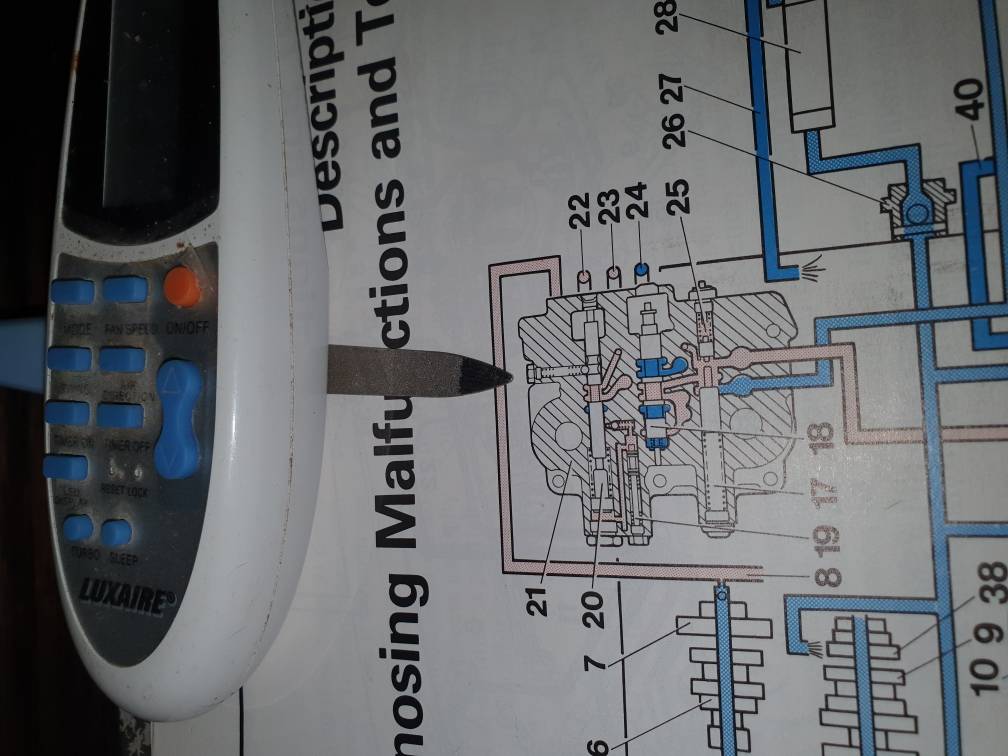

#19
Thank you very much, for the help!
The 3140 hyd scheme looks almost identical to the 2140 one that I found online.
Ding-Ding I think you're the winner. I see a pipe attached from valve in question to brake valve.
