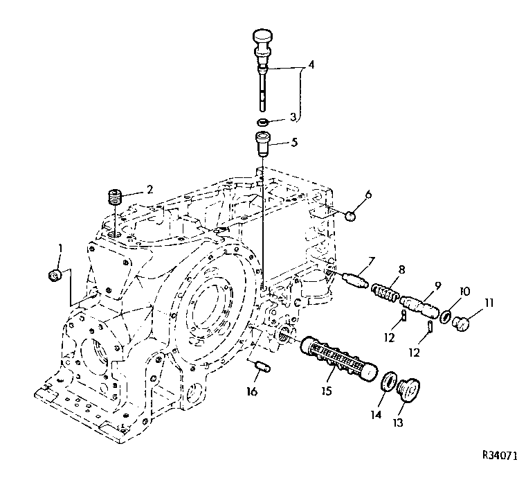

Hi.
I just bought a John Deere 2120. Its in pretty good shape.
I was wondering if someone can tell me how to check the hydraulic oil? Also what type of oil do they take?
I can't find a dipstick on it anywhere.
Thank you very much for any help.
Dan
/ John Deere 2120 #2
Welcome to TBN
JD 2120 has the hyd oil dipstick(parts key 3) on RH side of trans case. IIRC one should check hyd oil with engine running. JD Hy-Gard or it's equivalent for type of oil
