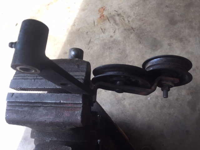

First like to say I'm sorry for the two posts for the same problem. Here is where I am now It is the wrong belt so I will have the correct one soon. Second I think the tensioner arm is bent. Its the arm that holds the two pulleys that the pto belt goes to the deck. I will remove it and take a pic. Does anyone have a picture of a good tensioner arm?

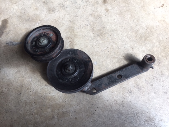

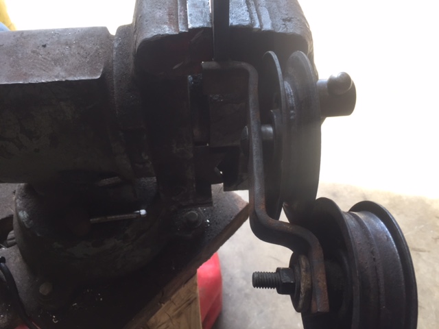

Do any of the tensioner bar angles or the pully alignment look off? IMG_0338 (1).JPG

Chaz: Now read very carefully... Your weird camera angles are not very conducive to determining straightness or otherwise - But the 'end-on' view in the third pic seems to display a curved arm at about the 'V'-pulley mounting bolt.
Now - In words of one syllable - You did not read the first two threads you wrote did you ? If you did you would see the pic I put up of the arm with a belt guide. Go find that pic.
Find that pic and compare to yours and you will see the missing parts. The guide that keeps the belt on.
Going from your X300 thread you don't seem to have much knowledge of belts, idlers & bearings. I can almost 'sense' the bearings in these two idlers are dry and noisy. I suggest you find the belt guide plate (or make a new one) and replace both idlers at the same time you straighten the bent arm.
That you fail/refuse to answer reasonable questions means it is frustrating trying to help you. Good luck.
