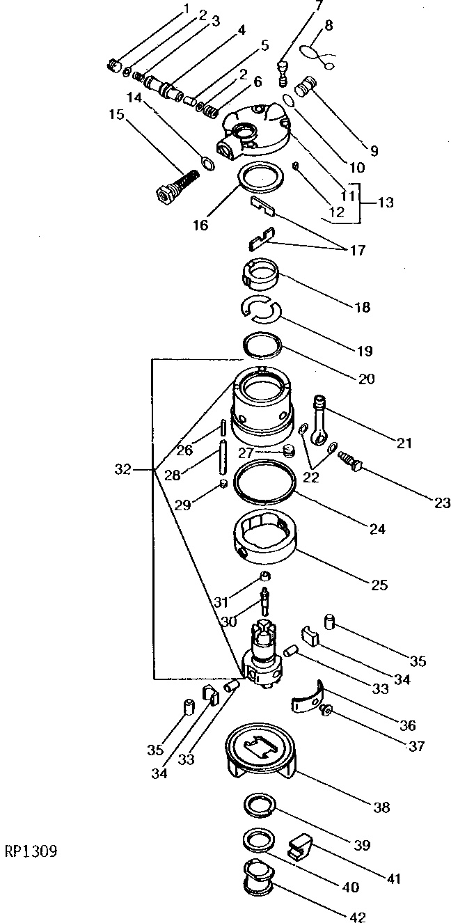

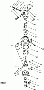

Where and what does the fuel lift pump look like and does my JD Model 2010 built in 1963 even have a fuel lift pump the reason I ask I own all the Tech Manuals for my Model 2010 and I have read all 700 plus pages over and over and no where do they refer to a fuel lift pump (Primer Pump) they only refer to the injection pump, another question I have can (where is the screen in the inlet side of the injector pump) is this screen under the top of the injection pump and will I hurt the pump if I that the four screws out and remove the top off the injection pump?
   / John Deere 2010 Diesel trouble #10
As I previously stated JD 2010 tractors had no fuel lift(transfer) pump when they rolled off assembly line at Dubuque,Ia. The fuel tank is located above IP/carb therefore gravity is utilized to get fuel from tank to engine. IIRC screen is parts key 15 and can be inspected by removing line then turn fitting CCW with no need to remove top of IP.
