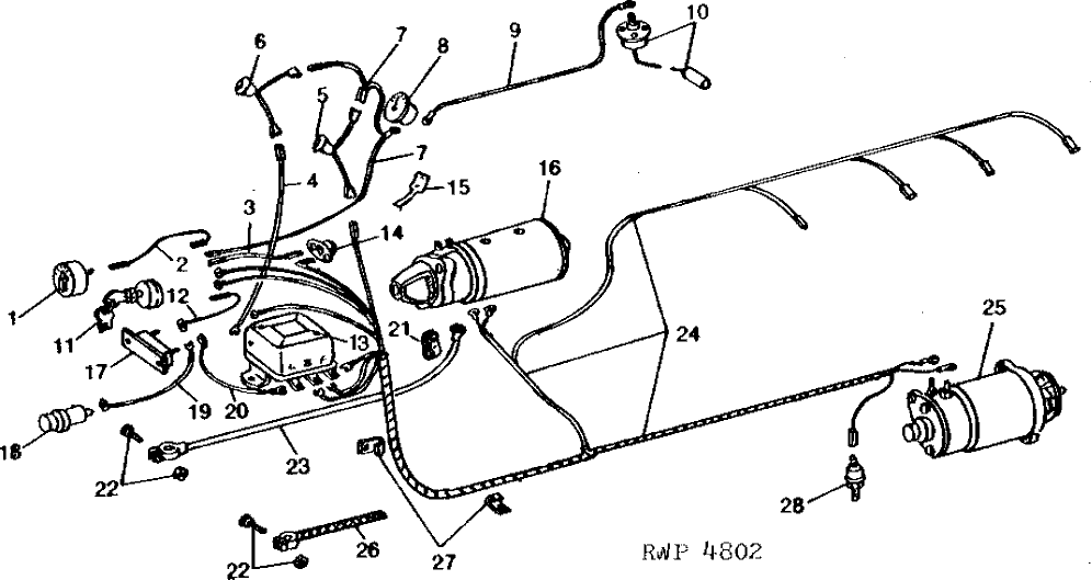

Can you post a photo of this "solid state relay" as I don't remember seeing one on a JD 2010?? Are you referring to circuit breaker(parts key 17)?
   / John Deere 2010 Diesel trouble #15
Sorry the correct name for the part that I'm speaking of is a "Voltage Regulator" Part Number 1118779 made by Delco Remy.
Thank you
   / John Deere 2010 Diesel trouble #16
Does the voltage regulator supply power (Voltage) to the glow plugs and aren't the glow plugs what start the tractor well other than the Starter? I guess what I am asking when I get on the tractor I turn the key counter clock wise to warm the glow plugs and after a minute or so warming the glow plugs I turn the key clock wise to start the tractor "at this point do the glow plugs do anything in order to get the tractor started" is my question?
