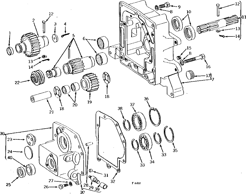

What part of the PTO drive train "isn't working" ? Are the problem 2010's with the double clutch option for live PTO?
/ John Deere 2010 Bad?? #9
2010's didn't have dual stage clutches for pto similar to the later models. 2010 had a gear type engagement(parts key 22,2nd photo) plus engaging a clutch with a hand controlled lever. Just look at all the moving parts that can wear out and most are probably NLA.

2010 brakes weren't very good when they rolled NEW off the assembly line and age didn't help them. Hyd filter can be difficult to clean & expensive to replace(AT21513 Filter Element ELEMENT ,OIL FILTER ADD 163.31 USD) .PTO engagement is unique and normally noisy as it engages a mechanism know for wearing out & a clutch plate simultaneously,hyd rockshafts have a long history of leakage and the control linkage on the inside resembles an "erector set". Hyp pump is located in the bottom of the clutch housing and is very difficult to R&R. Engine have an expensive deck plate with cylinder liners attached and lastly 1010/2010 diesel engines were known for hard starting,excessive smoking and prone for cyl head cracking and pre-combustion chambers getting loose. Because of limited yrs of production new & used parts are scarce for them.
