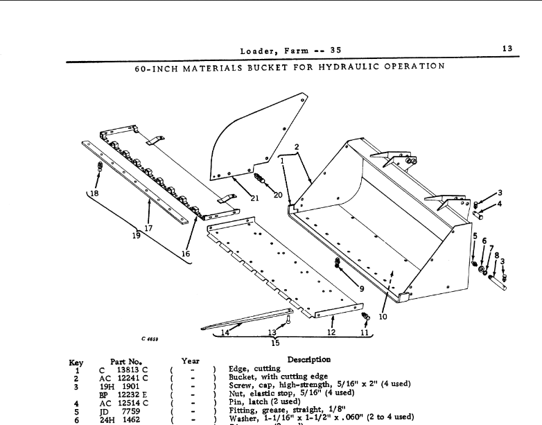

I have an old model 35 series 1 front end loader . I am guessing 1961 because of the year of the tractor . What buckets will fit on this ? It has a manure bucket on it I am thinking a regular bucket would be nice to have.
/ John Deere 2010 Bad?? #35
It wouldn't surprise me if a materials bucket that will fit your model 35 FEL is very easy to locate.
