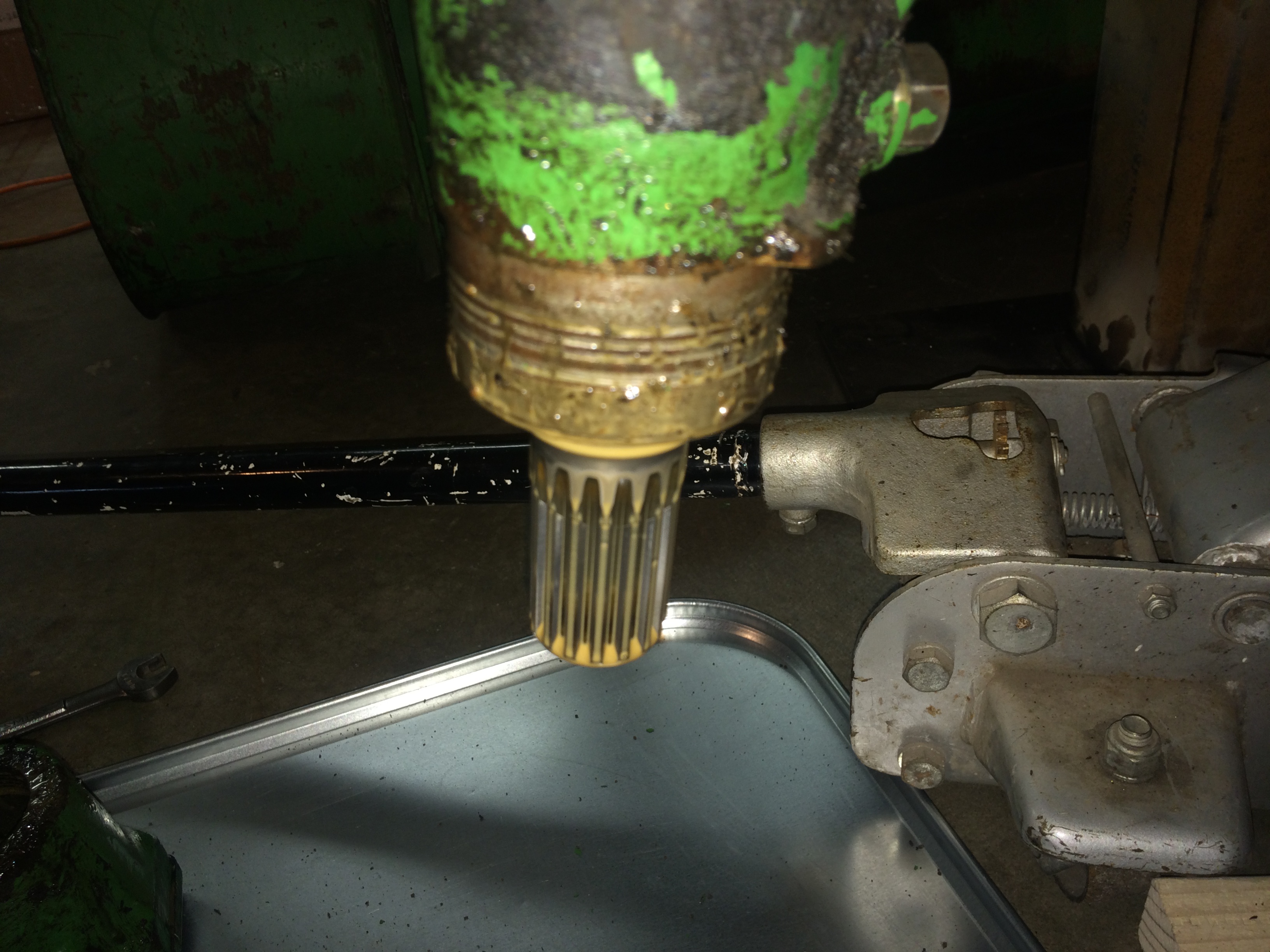

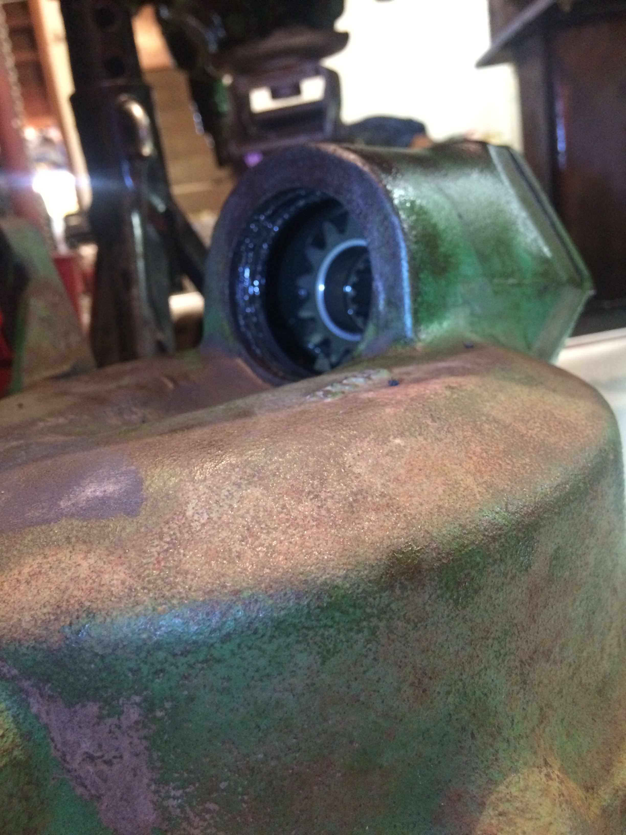

Hello all after reading many posts on here i finally decided this was the forum to join. Some what recently i acquired a later model 1050 4wd and it is in contradictory to say but shes in good shape, and then other point shes in need of replacement, wheel bearings, pinion seal done right, brakes, precautionary hydraulic line replacement.
the left pinion seal is brand new but it seem there is a missing sleeve or wear collar as when you pull on it bottom out top in and then back again you can see maybe 1/16 of play on each side. to me that shouldnt be there. but what type of seal does this one use? does say weaver sell a different one from hoye? and if the wheel bearings were replaced is there a reason the front of the stubshaft (where the wheel bolts too) to have a lot of play, like 1/8" anyway you push it(with the wheel off)i know this is no joke for the gears inside which is why i am not pushing her until i figure this out (need your input guys) the previous owner replaced the lower gear housing, i guess new bearings and all inside which i believe him, i think with no expirience he didnt know to order new seal kits and all that jazz.

Go to Hoye Tractor. look in the Tech Center for "Knuckle Seal Replacement" then look under YM336D (same axle)and there are very good instructions.You are going to have to pull the stub axle to see what's wrong(don't loose the shims)

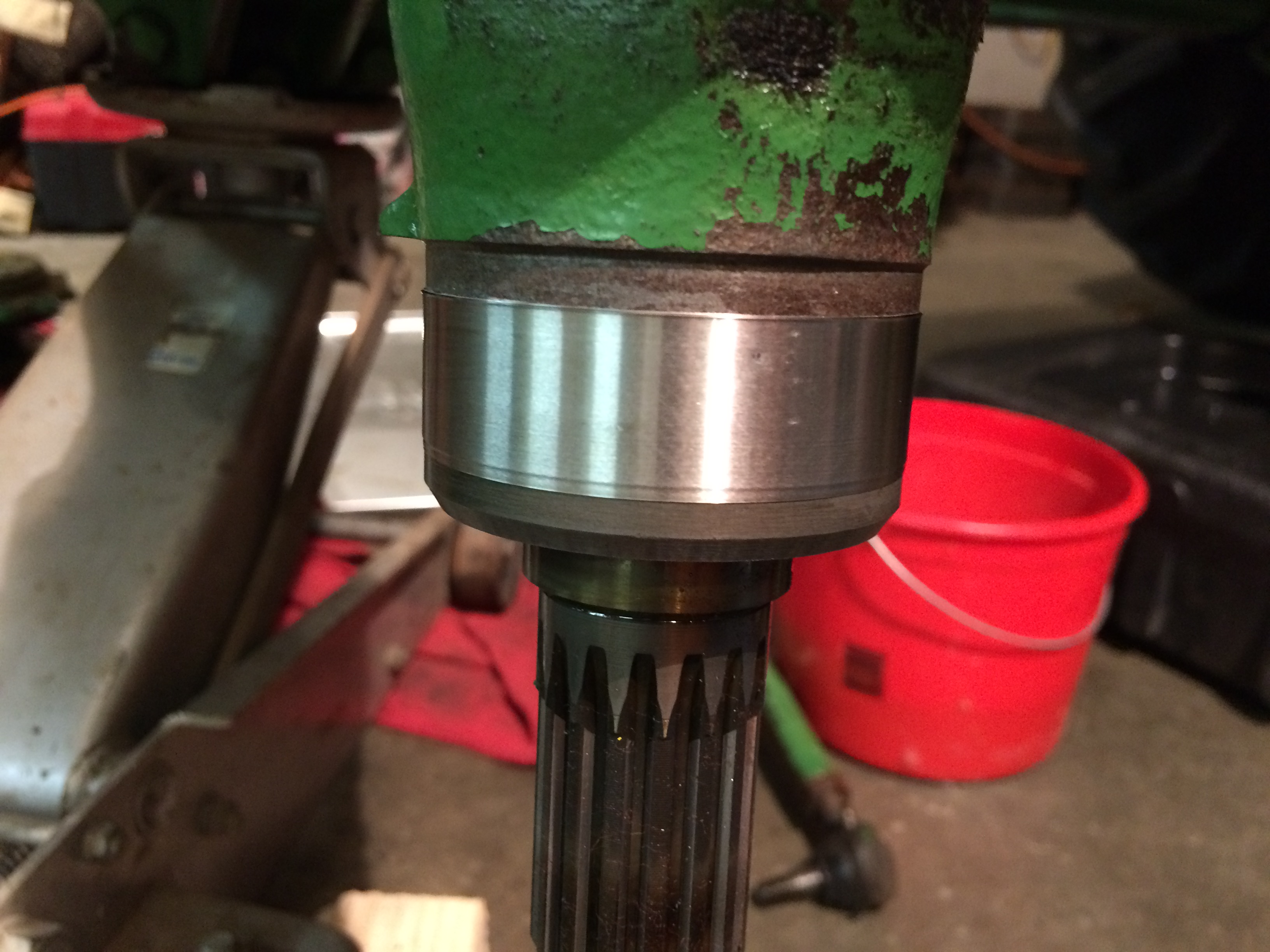

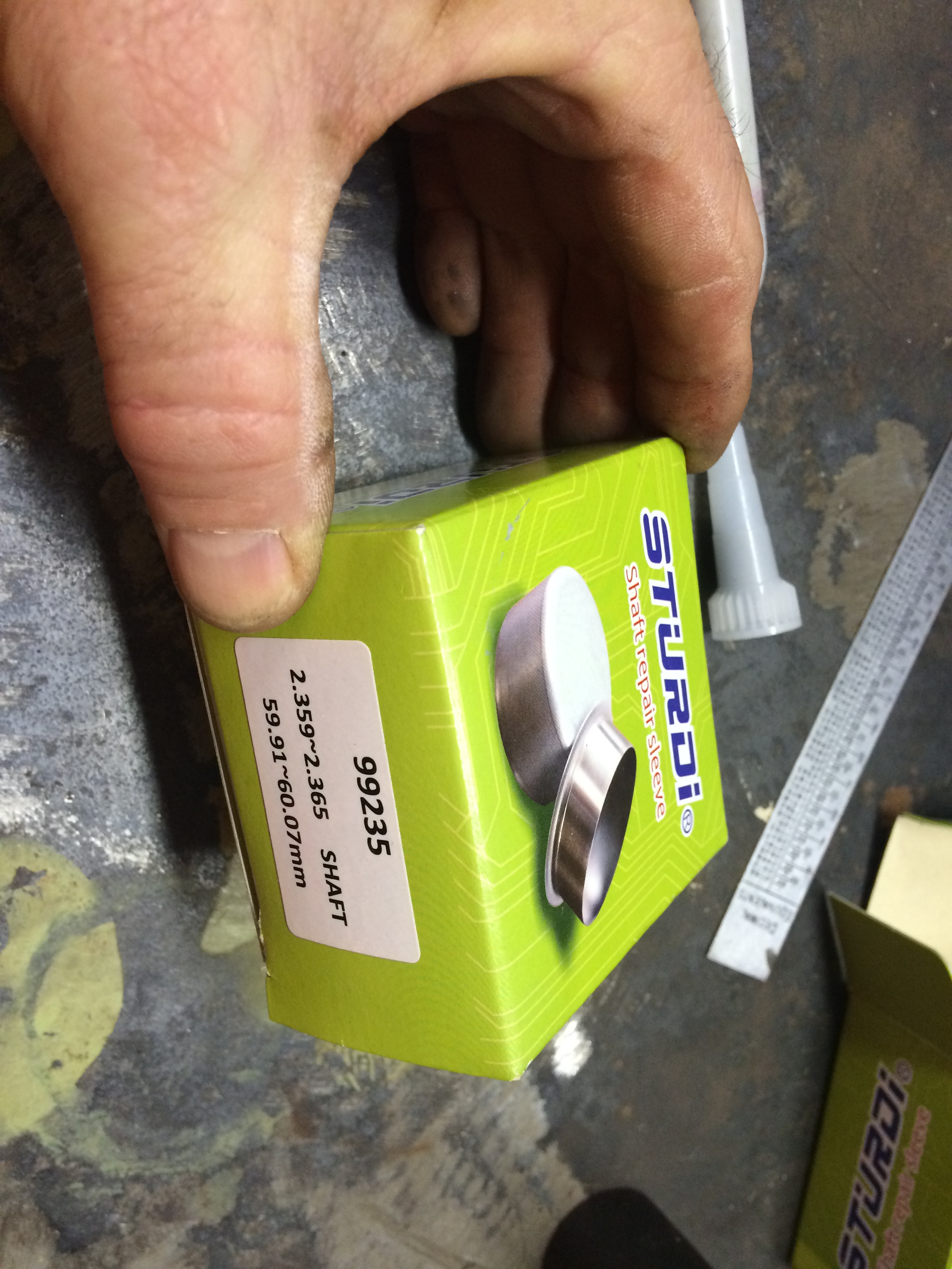

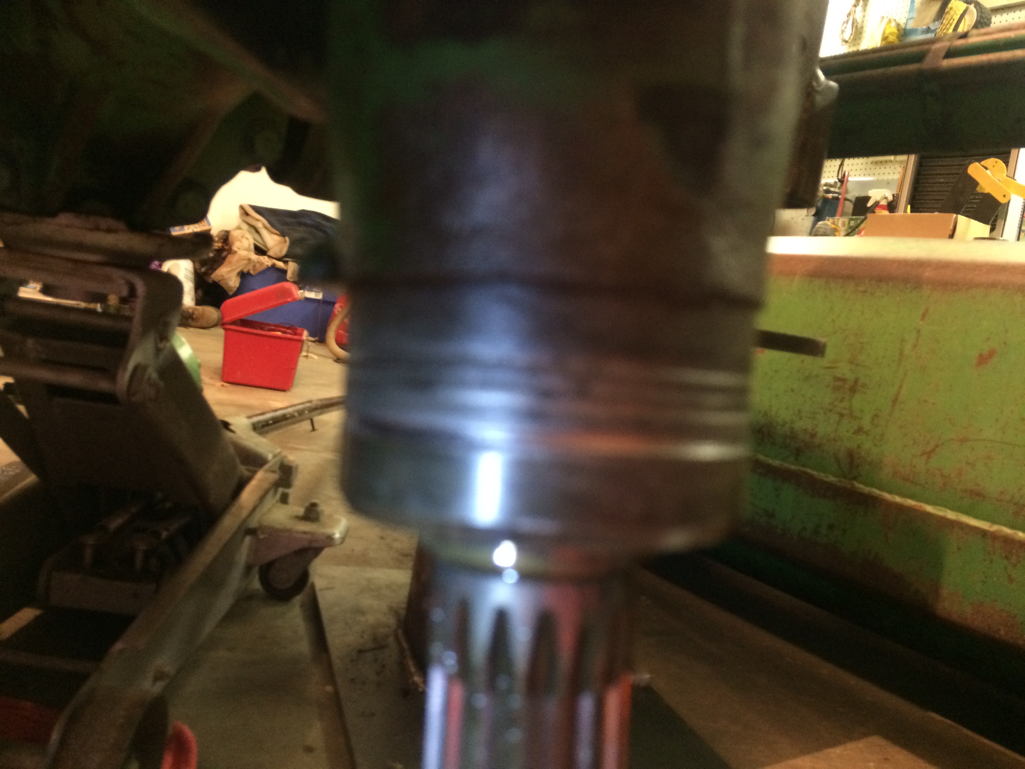

Are we talking about the front spindles? I've done them on a 950. More than likely the spindle will have grooves and you will need to install a repair sleeve. I didn't like Hoyes sleeves as they would have required machining the hubs. I bought a thinner repair sleeve and it worked great. My spindles leaked like a screen door on a submarine before the repair and don't leak one drop now. I'll have to look at the book for the hydraulic oil that is called for.

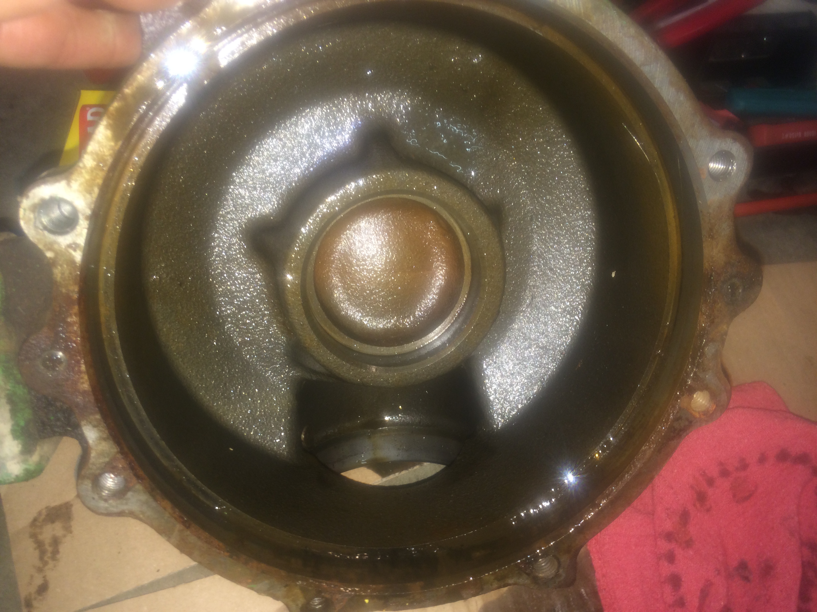

The design of this spindle seems weird to me as the oil seals from housing to housing, as opposed to just sealing where the shafts exit their respective housings. As I recall, there is a bearing in the lower housing which supports the pinion gear. I don't recall a brass ring but I'm not looking at a parts manual. All the spacers are important as they establish the correct backlash in the gear train. The manual goes thru this in great detail. When I did mine I simply kept good track of the spacers and returned to the original condition. Here is a pic of the lower hub. The issue I had with the Hoye spindle sleeve is that the OD of the sleeve was larger than the hole in the lower hub, preventing the install of the lower hub unless the hole was enlarged.
As I recall there are two different seal applications. Some hubs use a single seal while others use two seals on each hub. You might need to take yours apart to figure out which you have.
With respect to the sleeve you'll want to measure but I'm guessing you'll need that same part number. That sleeve is designed to work on existing OD of 2.359 to 2.365. You'll need to cobble together driver but a pipe sleeve and a piece of wood or plate will suffice. I think I put a little pucky under the sleeve to prevent any seepage under the sleeve. Probably just used a bit of silicon but don't remember.

I do not run any any additives now that I have my leaks fixed. The axle housings and hub housings are really one big system as there is not an oil seal between them. The seals you are replacing prevent oil from hitting the ground but do not prevent oil from moving from the axle to the hub. I think there are separate fill plugs on the housings but that is just because it would take forever to move enough oil from the axle to the hubs to fill the hubs. At least that is the way I see the system. The correct oil is 90 weight. Even the Deere dealer was wrong on their recommendation for the oil. Below is a pic from the manual.
I have the manuals. If you send me a private message with your contact info I can send you copies if you need them. Hopefully your side play is just in your bearings and your housings are good. Probably be easy for a machine shop to repair the housings if necessary. You may need to adjust shims to get the correct backlash. The book goes thru all that.

timberhole brought up a point I forgot, the sealing sleve repair. He is right, mine were toasted just like his. I have a lathe and it wasn't much work to make my own and shrink them on fixing them with a new running surface. I just run JD 90 wt gear oil and after the repair, not a issue.
.it's running at a farm in Twin Falls Idaho now My "new to me" JD 970tlb runs the same 90 wt and it's just fine.
