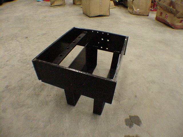

I cleaned the radiator...didn't appear to be too clogged with seed, chaff etc. but haven't had any more issues with overheating...not even certain that was the problem since it never boiled over. I would like to move the battery for more air flow...anyone done this and if so where did they relocate it? I would also like to change the filters soon, they've been changed at least once in its life because they are dated w/ hrs on them but appear to be OEM and was hoping someone could tell me the NAPA, Wix etc equivalents of fuel and oil filters.

I had a pair of 25 hp Jinmas years ago, and had the same problem with crap collecting behind the OE battery. They didn't last long anyway. But rather than relocate them, I just bought lower profile batteries (look at the Group 49 or Group 93 at any auto parts store).

I fabricated a frame extension and relocated my battery just below the front fiberglass. While brushcutting the temp remains constant, regardless of load.
Hey, I was wondering if you could post a pic of th battery relocation? I have a few ideas in mind for mine but so far haven't built anything. Would like to see how you did yours.
Thanks.
/ Jinma 284 #20
