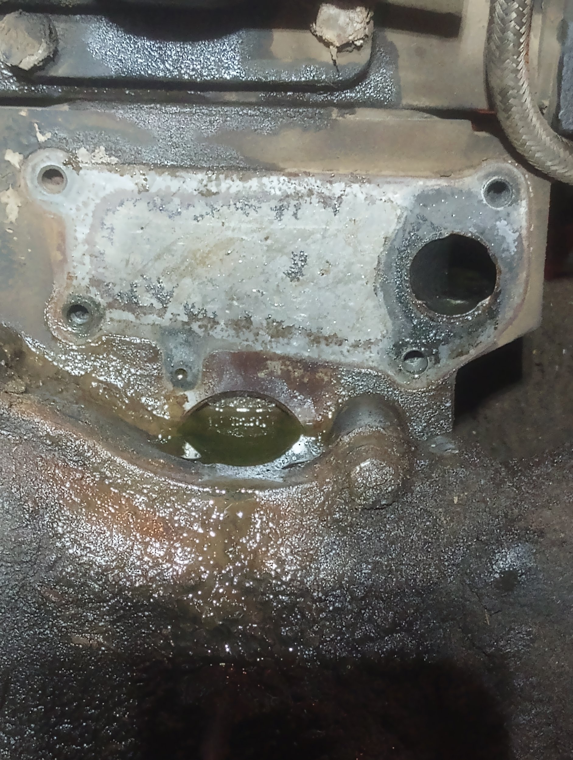

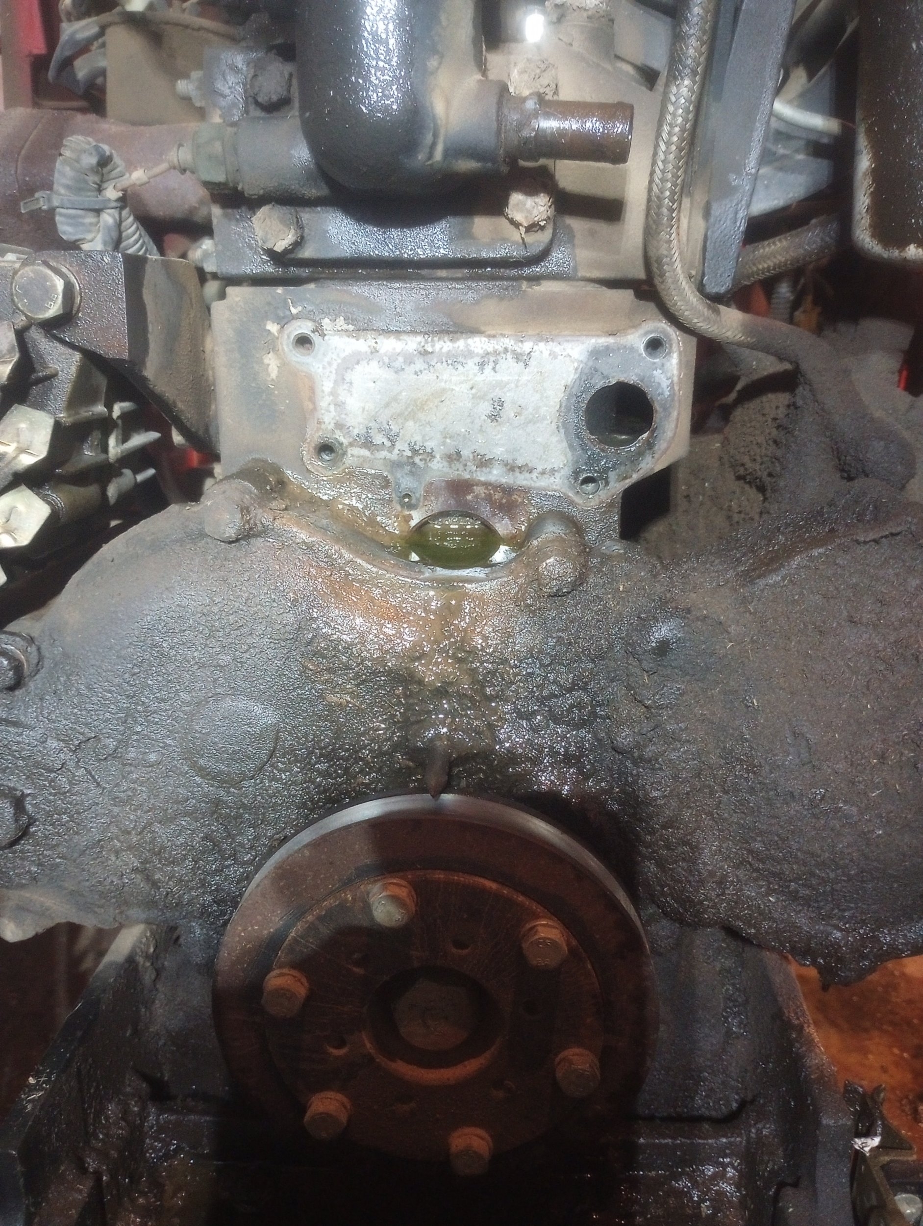

Hi all, long time member 1st time poster. I have a 2007 jinma 284 with a coolant leak. Noticed a leak coming from the water pump area. Thought it was the water pump leaking out the weep hole. After pulling the the pump the pulley didn't show signs of a bad seal. Did notice coolant coming from a cavity behind the water pump and at the bottom of where the pump sits. See photos. Any ideas what that cavity is or why there would be coolant leaking from there would be greatly appreciated.

I'm pretty sure that is a soft plug in the front of the block.
You are going to have to pull the timing cover, gears and case to get at it.
Before I went to all that work, I would try and fix up a plate for the water pump opening and block off the rad hoses. Then put some pressure into the block to see if you can confirm a leak at that plug.
Do you have a parts manual for the engine? If not, several dealers have them online for you to look at.

I agree with Piper. That's a cup type core (casting) plug. But I would clean that area thoroughly to make sure it's necessary to pull off the front of the engine.

Sorry for my ignorance, but if the plug is behind the timing gear case, why is the water coming out above that location? Wouldn't the water seek it's lowest level, that being the plug as it is lower than the pictured cavity? I'll try to pressurize as piper 184 recommended and see what happens.

The leak is coming from that cavity behind the water pump but it seems to be above the timing gear assembly. Could it be that it's got a leak at the head gasket and it's working its way down to that cavity somehow? The head gasket had been replaced a while ago. The hour meter stopped working at 164 hours so it's been broke for a while. I'm out of town for a week and not able to investigate much more. I'll jump back on the thread when I get back into town.
/ Coolant leak jinma 284 #16
That cavity has the soft plug in it. My bet is the plug is rusted through and it is leaking. The coolant pools up against the back side of the timing case until it reaches the top, then flows out over the case.
