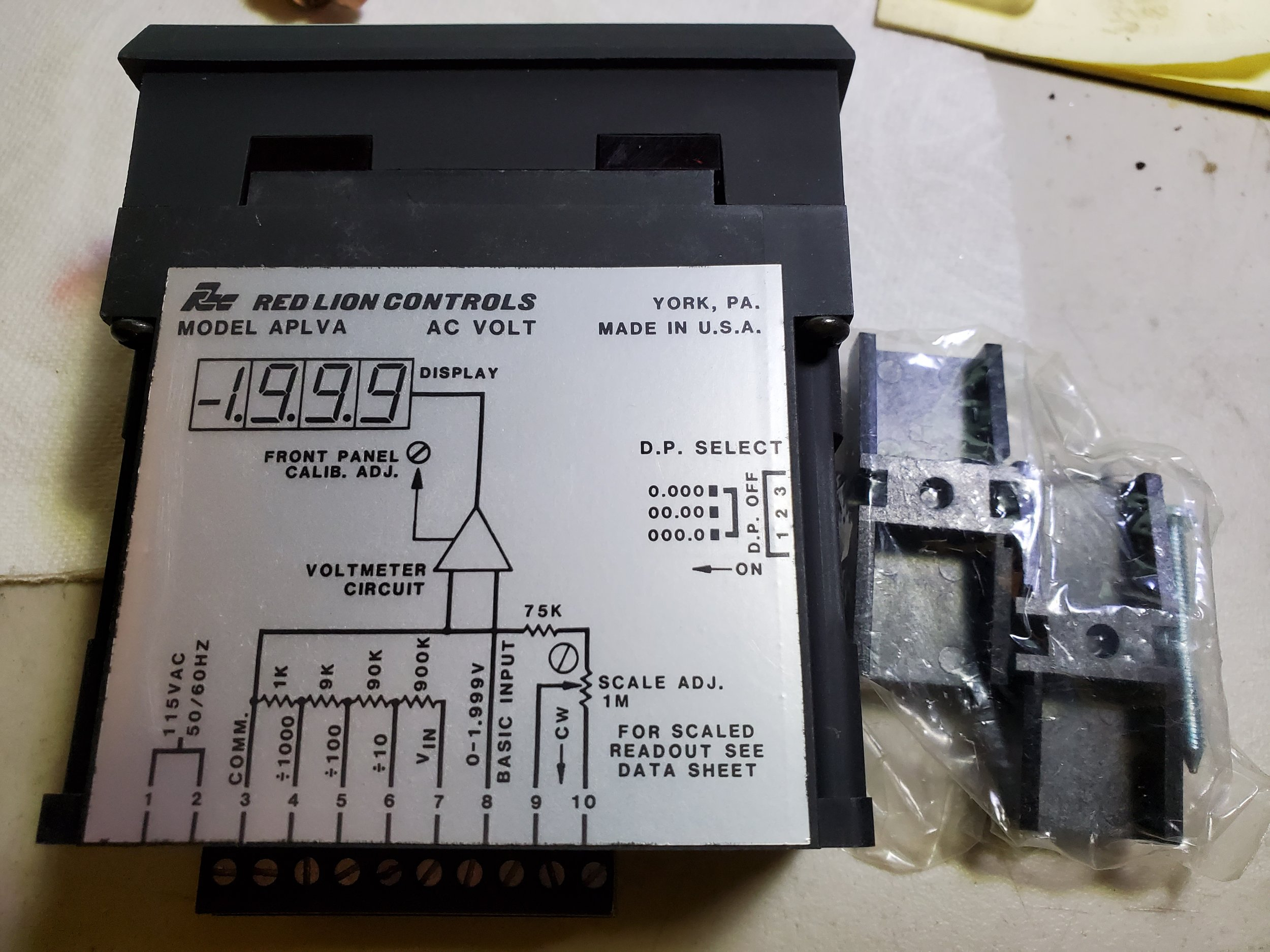

Thanks Bob,
From what I can tell the DP20 only reads Hz up to 100. If I used a 60 tooth trigger (one pulse per second @ 1 RPM) it would display as a direct RPM number but would only work up to 100 RPM.
Any trigger tooth count other than 60 would require a conversion factor to RPM, which I didn't see in the manual. Easy enough to make a wall chart for reference...
I'm pretty sure the Jinma reluctor puts out a pretty steady voltage and the tach is calculating off of the frequency and would be accurate only for a ring gear with the same number of teeth. Did I miss something?
When I get time I will look at the Murphy site to see what kinds of displays they have.
Thanks for all the info.

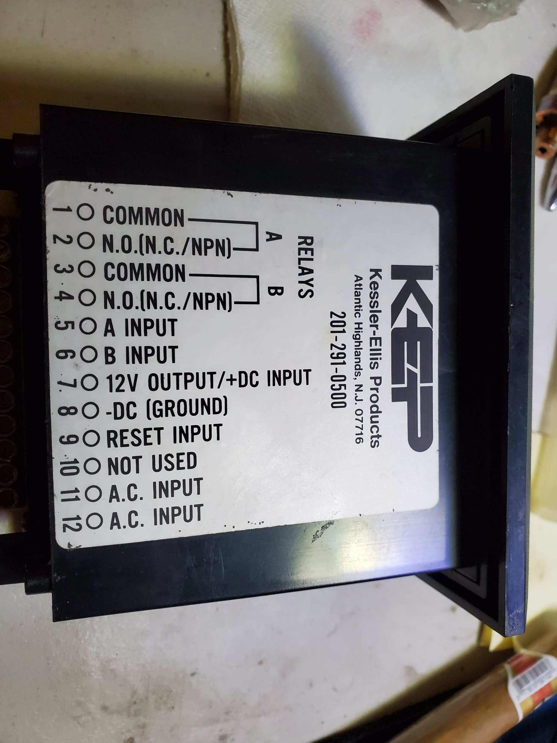

   / Jinma 284 Tach died #15
Sorry. What I have is these:
KEP m/n MRHA3M
Red Lion m/n APLVA
Actually, I don't think these would work either, but let me know if you have a use for them.

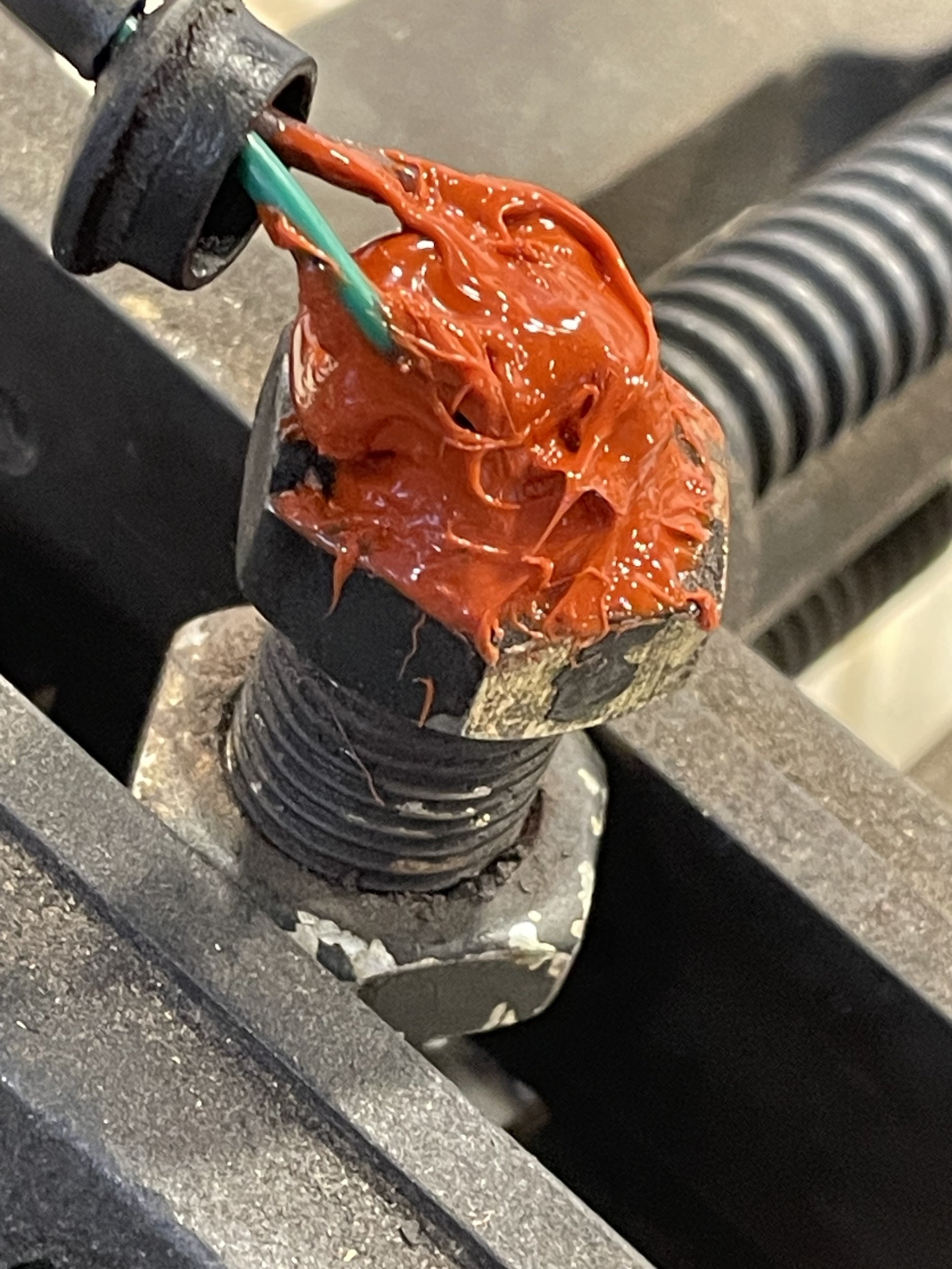

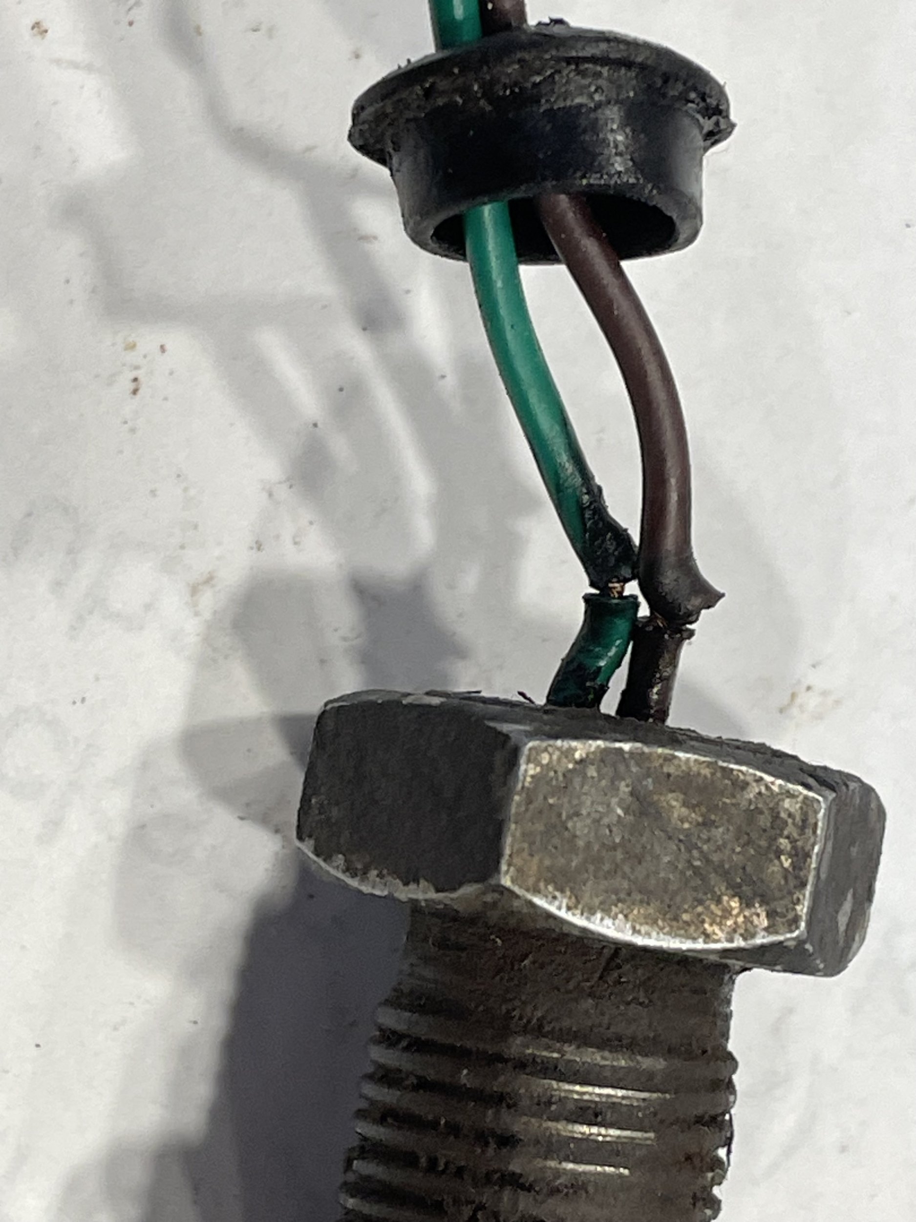

I have a 2010 JM284. The tachometer recently stopped working. This tractor has the cluster instrument panel. The hour meter is integral to the tachometer. All the instruments powered up including the hour meter. So I concluded that either the tachometer sensor unit had failed or the associated wiring/connector had an open circuit. I contacted the dealer who stated the sensor was a common fail item and that there really wasn’t a way to bench check it to confirm a failure. With shipping, a new sensor would be about $45.00. Not a big deal but I figured there had to be a way to determine whether the sensor had failed before spending the money. Then I came across Piper184’s little trick with the drill chuck. Brilliant! On the work bench I connected a DVM to the sensor wires, spun up the drill, and moved the sensor to close proximity of the chuck. I got a voltage reading but it was variable and intermittent. So the sensor was faulty and would need to be replaced. I noted that the wires enter the sensor through a soft rubber cap or plug that fits the end of the sensor unit. Out of curiosity I pried back the plug and discovered the insulation on both wires at the same location had cracked exposing the internal conductors (see photo). I separated the exposed wires so they couldn’t short and repeated the drill trick. This time a steady consistent voltage reading. I wasn’t sure how I was going to repair the wiring because of where the break in insulation was located. I ended up using RTV silicone gasket maker (it’s what I had on hand) to fill the hollow end of the sensor and built up enough silicone to encapsulate the exposed wires and immobilize them (see photo). I allowed 24hrs cure time and reinstalled the sensor. The tach works perfectly.
