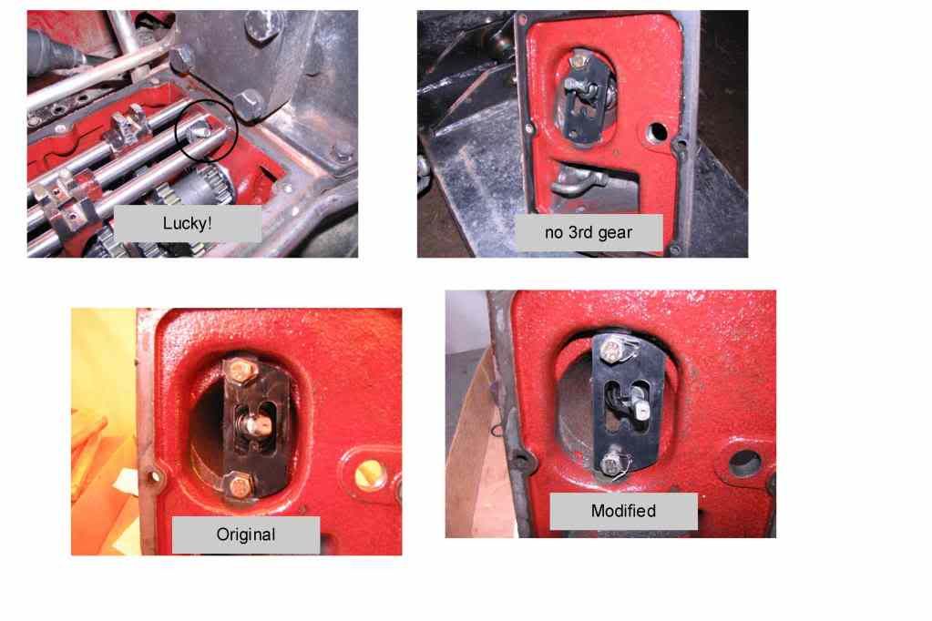

With the shifting problem, I pulled the tranny cover that has the gear selector lever in it and found that a bolt had fallen out of the shift guide plate that's bolted to the under side of the trans cover so the shifter was moving all over the place and wasn't always engaging the shift forks. Luckily the bolt had fallen between the fork shafts and gotten hung up there. I was lucky, if the bolt had not gotten hung up there, it and the locking washer would have fallen into the gears of the transmission. Dodged a bullet there.
learned about this problem on the internet so 284 owners beware, if the shifter seems sloppy and the tractor won't go into 3rd, better pull that top cover and check it out.
/ Jinma 284 diff lock won't disengage #8
Shift Plate Bolt Retainer Repair
To fix the problem I drilled two small holes near each bolt hole in the shift guide plate, drilled a hole through the head of each bolt, discarded the retainer clips, installed a lock washer on each bolt, tightened the bolts and safety wired them to prevent them from coming loose again. This was a simple inexpensive fix.

thanks erj, it was your post on the internet that prompted me to pull the tranny cover
