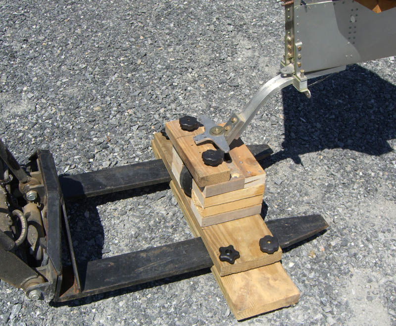

#202
Here is a shot of the attachment that I made that allows me to move the aircraft around that I am building.

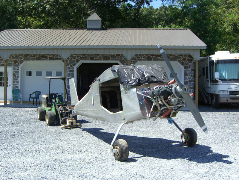

#203
And here's the 425 with the aircraft attached. I'm able to move it in and out of the garage. Another benefit is that the PT can hold down the tail when I run the engine as without the wings on the airplane, the CG is forward and it will tip over with the engine running.
Another cool use for the 425!

/ Jim's new projects #204
Nice body work on aircraft. Are the wings completed as yet?
Using the tail wheel to move around with the 425 should pivot on a dime.
PJ
#205
Yep, I have the wings and tail section complete. This was only the second run up of the engine and it started like a champ!
It took a little getting used to when maneuvering the aircraft around with the 425 because the front end does not swing like you would expect due to the articulated frame. Combine that with pulling and pushing a tail wheel aircraft around and it becomes interesting until you are used to it.
I was afraid that the 2"x4" blocks that I put together would get hung up in the tail post, but it worked out perfect. Of course the PT never had a problem in moving the airplane, even with the engine just above idle.
