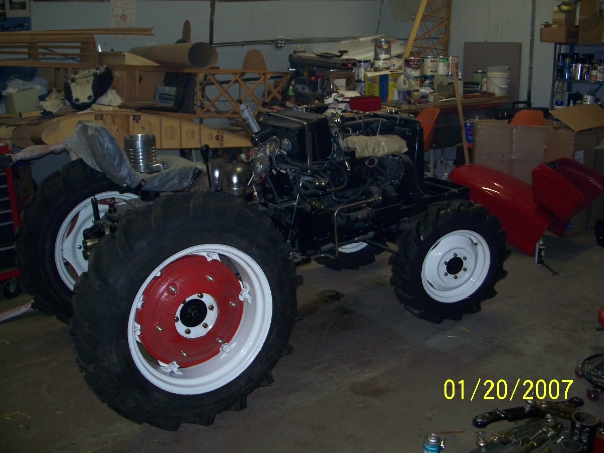

Here is the way I mounted the wheels. I put the valve stems out for convenience and never thought about trying to make it wider. Not sure how the rear wheel weights would work if the rims were reversed. Unless lifting a load high or off center, stability has never been an issue as most of the work I do is on fairly flat ground. I have lifted a rear tire off the ground a couple of times but was working slow enough it was not an issue. Impressive that the FEL could apply that much twist to the tractor and not bend out of shape.

I dont have a pic but i have the valve on the outside and the weight on the inside and also flipped the centre hub so its the widest it can be. I used this as a guide. Except when i did the 5th setting i found tyre rotation was the wrong way so I didnt need to alternate left and right. Maybe i had too many beers. Those tyres are heavy. Rear Wheel Width Positions | CHINESE TRACTOR WORLD FORUMS

That is interesting. I knew there were width options but hadn't considered all of them. Mine came out of the crate in position 2 from the chart. with that setup I am still narrower than the 3 point snow blower, so probably won't be going wider unless something changes in the way I use the tractor. The FEL bucket won't cover the rear tracks but that will change as soon as I weld up a new bucket. Been on my bucket list for years... (rim shot, ba-dum!)
