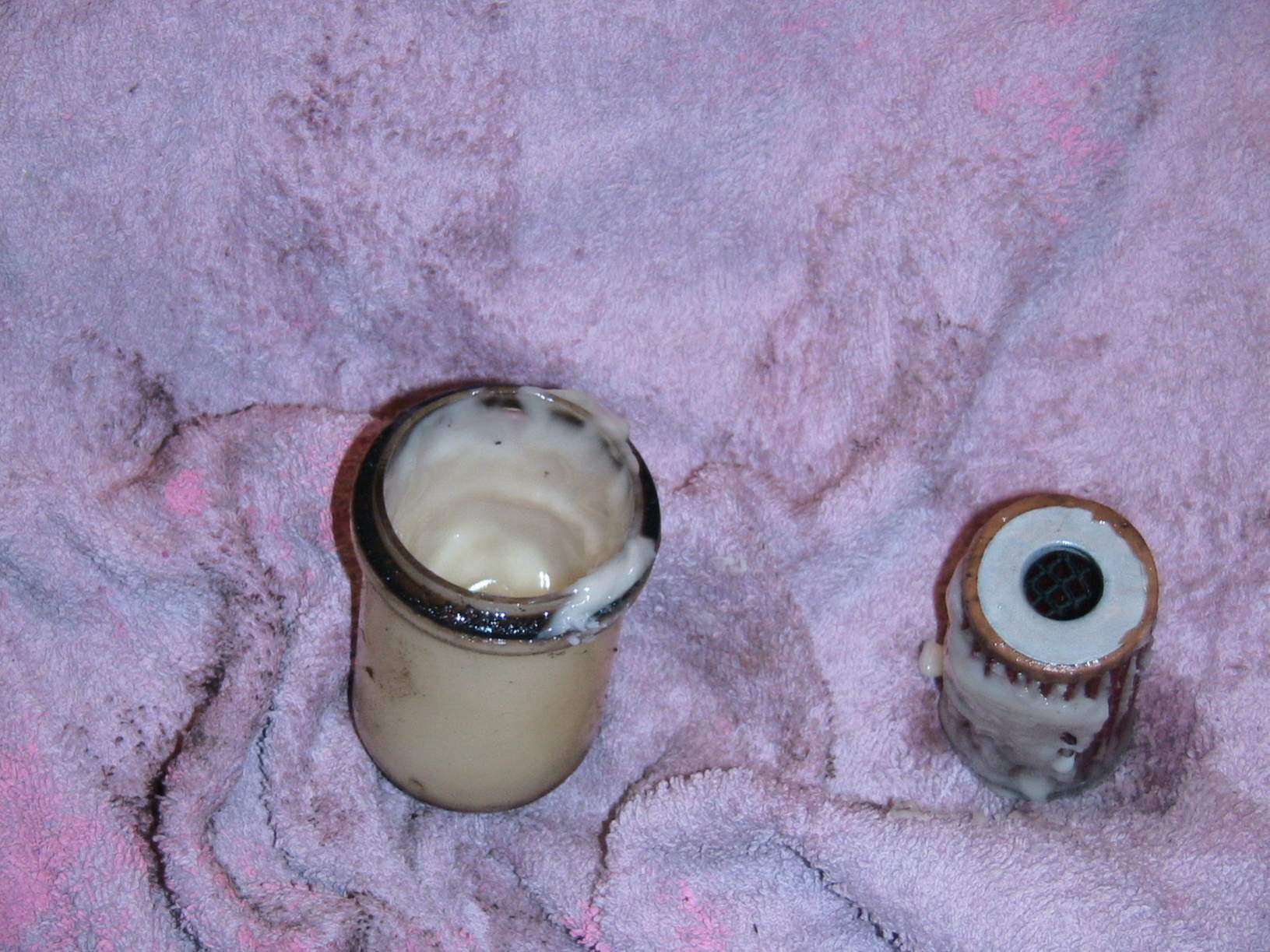

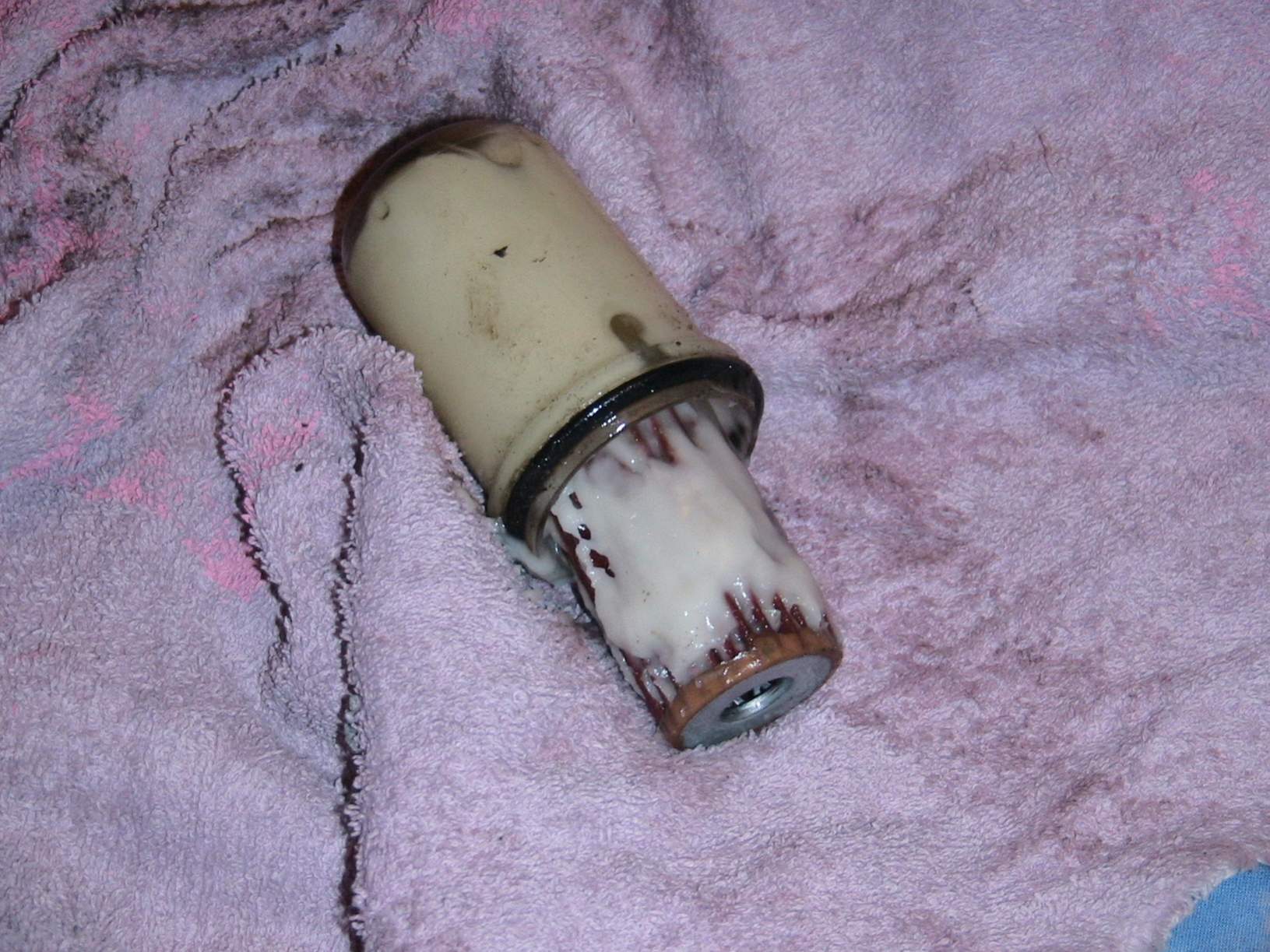

Whitish slime is when paraffin drops out of diesel fuel in the cold. I have had that problem too many times. I included a picture from last year when "winterized fuel" from the pumps did not like the -20 C (-4 F) temps. I used a healthy dosage of an agent to help lower the temperature range, cleaned the filter and re-installed it.
