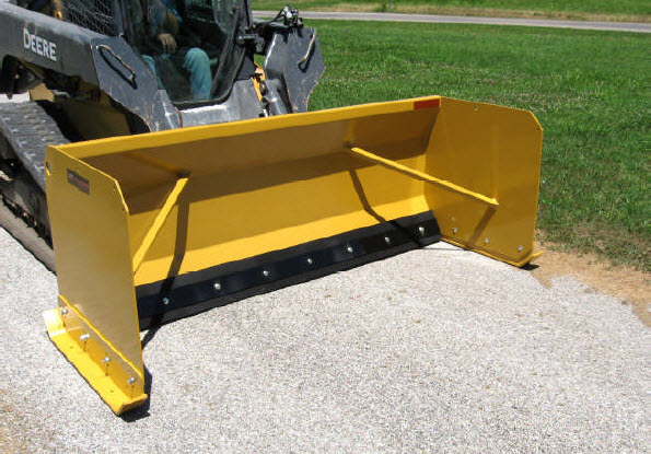

Looks like this:
I bought it already with JDQA brackets welded on but they were crooked and not reinforced so they cracked the back all up. I cut them off, reinforced, and welded back on straight.
