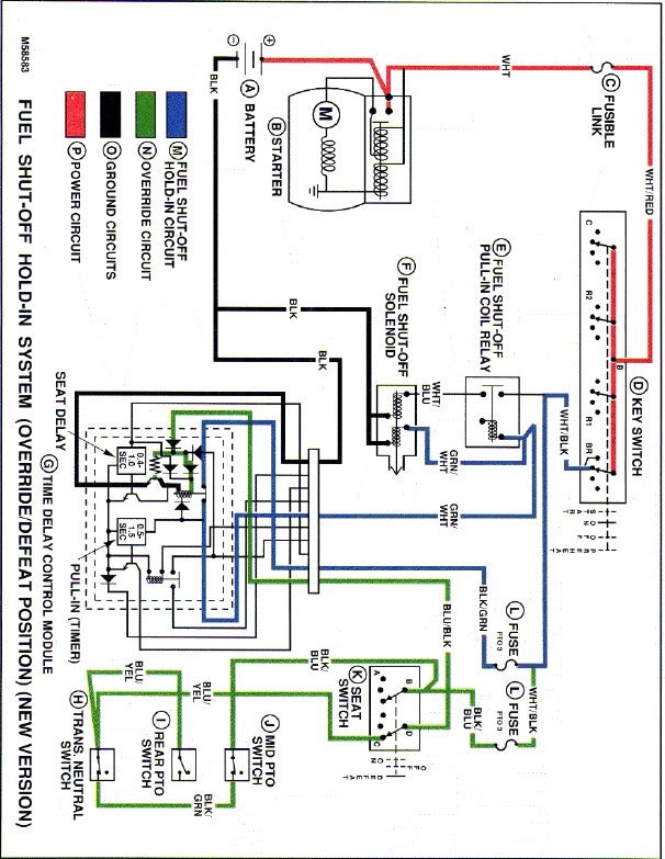

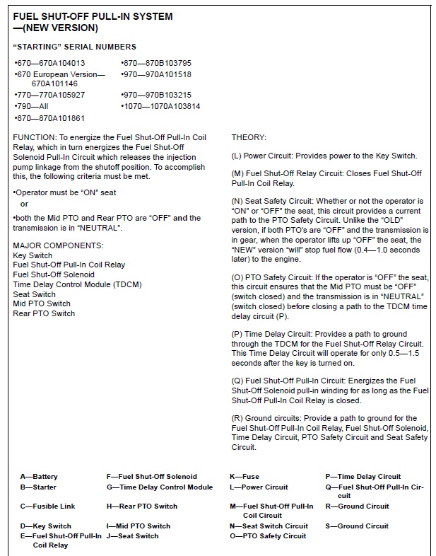

There appears to be an "old" version and a "new" version.. is your 870 above or below serial number ending in 103795 ?
/ JD870 Will Not Start #22
I'm not sure, are you talking about the engine serial number? That's all I can find.
/ JD870 Will Not Start #23
S/N 142787? I think that may be the S/N you are referring to.
/ JD870 Will Not Start #24
That is the tractor s/n, and it is above the break indicating the "new version" for the fuel solenoid.

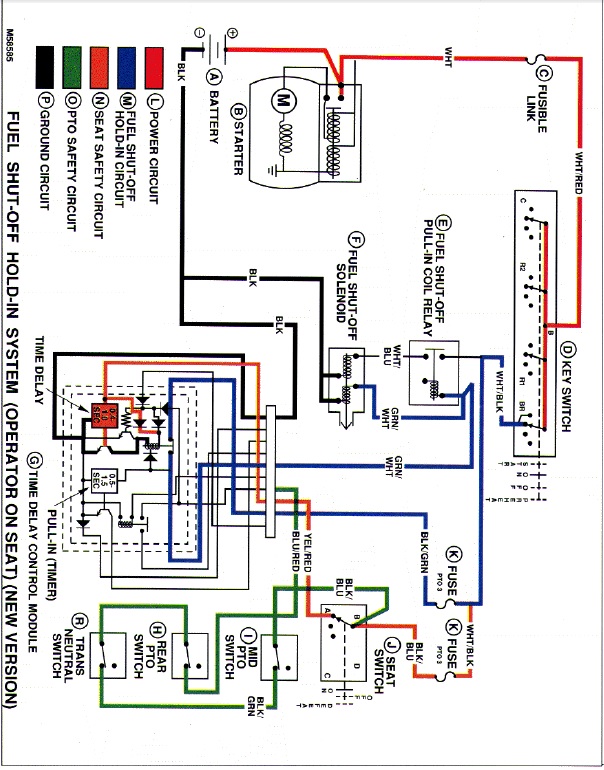

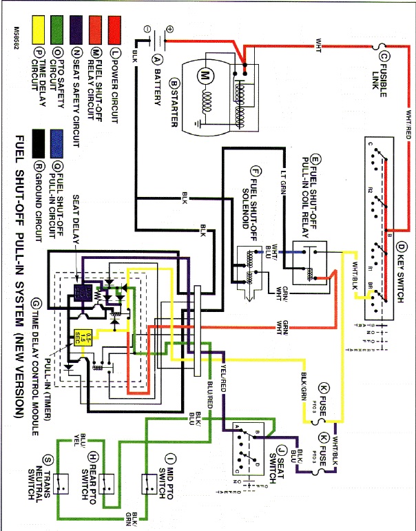

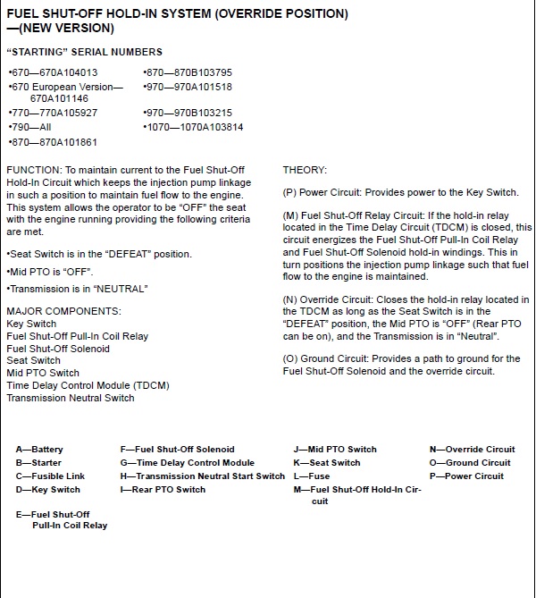

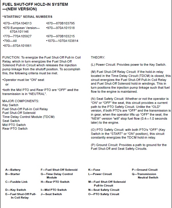

Attached are "theory of operation" from the service manual for pullin, holdin, and override holdin that may be helpful to you in figuring a "next step" to proceed. There are corresponding circuit schematics to each of these three conditions. They may not help, but should give you some thoughts to ponder.
These didn't post up in order that I put them in, so some sorting will be needed on your part.

SUCCESS!!!!!! It finally starts. :D In a nutshell, here's what happened since my last post: Once we determined there was no voltage on the black w/red stripe wire on the Neutral Start Relay, TedLaRue sent instructions for testing the Time Delay Control Module as well as instructions for checking the "dummy" connector for the mid PTO (my 870 has no mid PTO). I disconnected, cleaned, and reconnected the "dummy" connector for the mid PTO while my husband disconnected, cleaned, and reconnected the connector for the TDCM. He went off to get the voltage meter, and I, just for yucks, decided to get on and see if it would start. Scared the you-know-what out of me when it started right up! :eek: So one or both of those connectors needed cleaning and/or one or both were loose and needed to be secured.
My thanks to all who posted there ideas. I learned a lot through this ordeal! :D See you on the forum!
