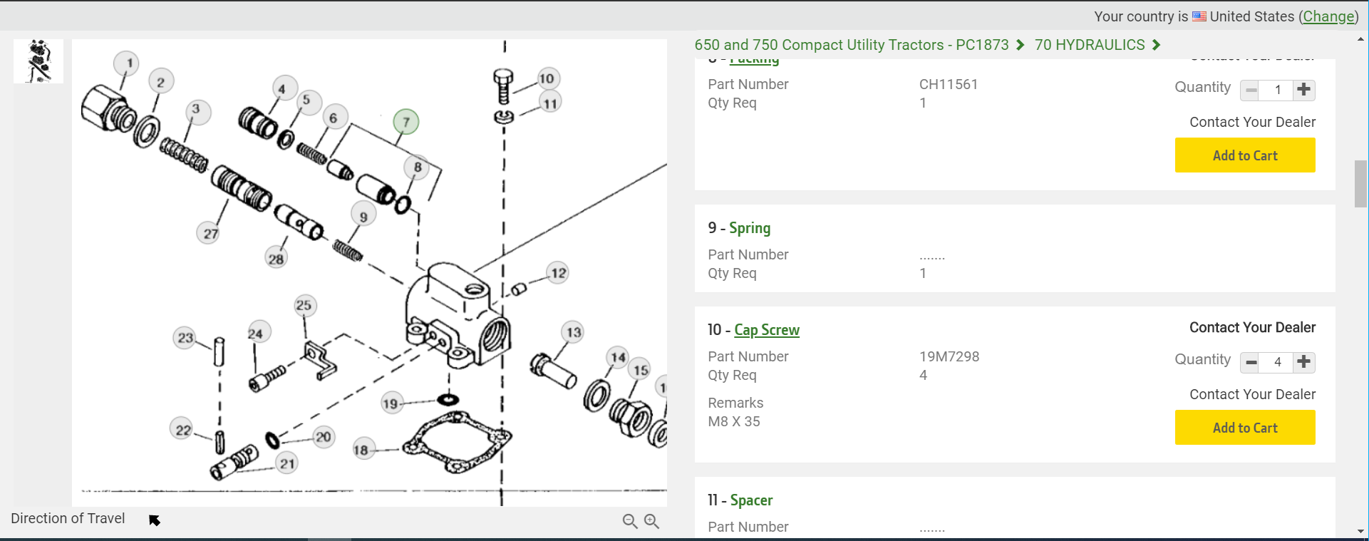

I reassembled the loader piping from instructions I was sent on another thread. They were all correct. The difference in the control valve design has been explained. It turns out there was a part change, ST571526 to ST571527 towards the end of the models life. I have the xxxxx27 and my tech manual, and many other sources, show the xxxxx26. No idea why, but mine looks a bit simpler (in terms of tiny little retaining parts and what not). it appears as though everything is there except for the gasket was pretty much gone (ordered - item 18) and there is a pilot valve return spring that looks a little bent (item 9). That little spring doesn't have a corresponding part number on the manual That I can find though. Does anyone know how I go about finding one? I doubt its the culprit but it can't hurt to get it right.

I stretched the spring a bit and tried to twist it a bit straighter (dunno if it actually worked or not) and made a quick and dirty gasket with some old head gasket material then re-assembled it all. It seems to be working much smoother now surprisingly. ill swap out the gaskets when the OEM comes and still hope to find the spring. I guess the real test will be when I start using it in combination with the front loader again.
I also effectively rust-proofed and lubricated the entire back half of the tractor (and myself) by not fully tightening one of the pressurized hoses... so I've got that going for me.
thanks for the help everyone. would love to hear thoughts on where to get that spring!
