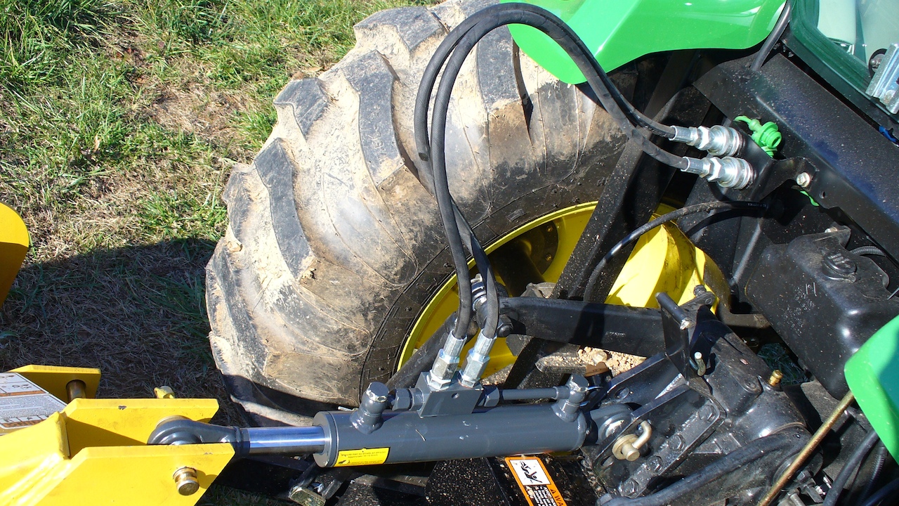

Just to get a handle on all of this, if you look just below the washer fluid tank there is a deep cavity where hoses can be run out of the way of anything.
When I ran the new hoses for the topntilt I removed the existing hard lines that go to the loader connections and filed them in the rafters minus the couplers, if one day I decide I want a loader on this tractor I can put them back. This allowed me to run the hoses from the valve with 90 degree connectors back and up over the rearaxle housing in the cavity or space. The couplers for the four hoses all nest in this space too out of the way of everything. Typically I can't see much reason for unplugging these connections but they are there and available. This frees up the third remote with mounted couplers for other uses.
Using the joystick to control the hitch then is intuitive, move joystick left tilts the hitch to the left, pull back on the joystick extends top link tilting implement back.
I am rehashing this because the space I am referring to is in the middle area and is easier to plumb your lines too than what you are doing now. If you go back to the picture I posted you will see the upper hoses are coming from the boxblade scarifier bar. If I were using the I Match and a simple implement there would be nothing plugged in to the third remote.

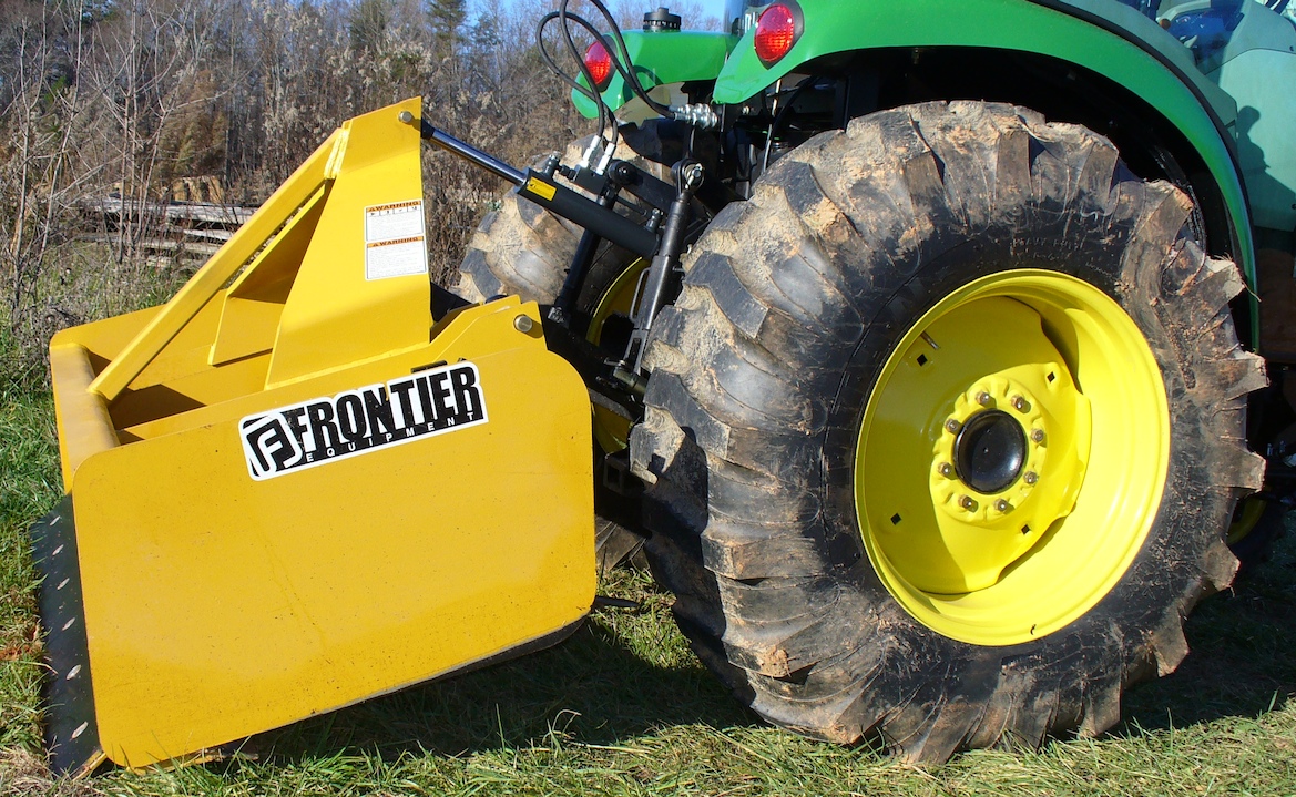

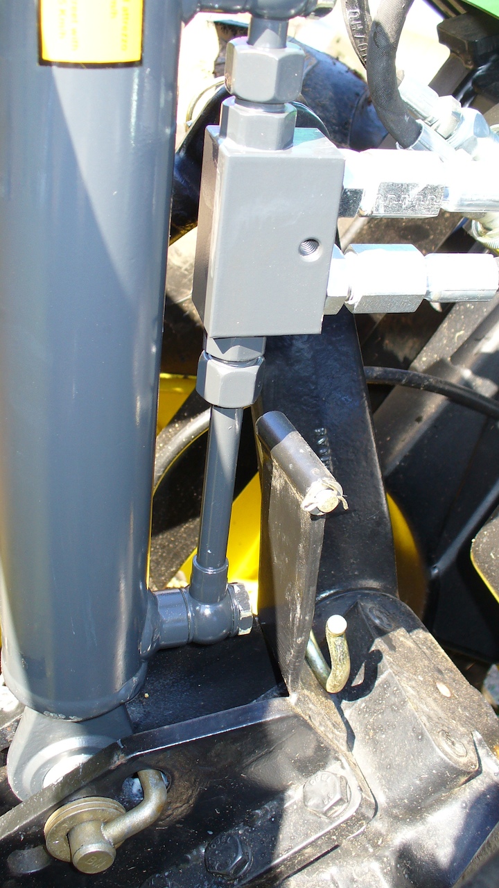

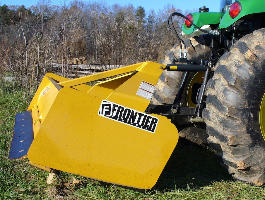

First let me say that the 110 tlb has the diverter with triple remotes each end. The 110 also has the aux circuits on the loader as well as the backhoe, and that setup was kind of pricey. Necessary if you need the loader, backhoe and top and tilt functionality for the large boxblade. Now with a 110 with all the lines in place I also have a belly pan to protect the underside of the tractor.
As I have mentioned before my reason for buying the 4520 was to have a dedicated tractor for three point work, with out a loader in the way. With this in mind having three hydraulic circuits on the rear was all I want. I thought about making up hose extentions and could have plugged into the existing mid loader couplers but then I would have to deal with these long hoses beneath a tractor without a belly pan. I knew that the hoses are tough enough to pull and twist the hard lines around if they got snagged on something, then I would have a real mess on my hands. A little pondering and it made much more sense to remove the existing hard lines to the mid couplers before they were damaged and store them away.
To accomplish the switch from mid to rear I removed the hard lines and took one of them with me to get the hoses made so the hose maker would know what type threads were needed. I had all four of the hoses made to a 48" length, this worked out perfect. The valve end of the hoses have 90 degree turns on them and the coupler ends have straight fittings. All of the hoses were installed with the hoses pointing to the rear coming off the valve. These hoses are routed up and in front of the rockshaft out of the way of the moving hitch parts on the rear of the tractor, crossing over to the opposite side of the tractor where they are shown with the couplers bundled. Orignally I had intended to make a new plate to fasten all six couplers in place as I have on the 110, but realized that these four lines running the top and tilt would remain in place regardless of the use for the tractor. The third remote is the only set that needs to be easily accessible for routine use and is installed with couplers and plate as provided. To clarify though all of the couplers are easy to reach in case you want to remove the cylinders for some reason.
In reality this is a simple job, remove the four hardlines and replace with four hoses, reinstall the couplers. Since the hardlines have swivels on the valve end it was an easy change over. Here are some pics I just took for you to see better, we have rain snow and mud here right now, when the weather clears I will get you a picture from beneath the tractor.
