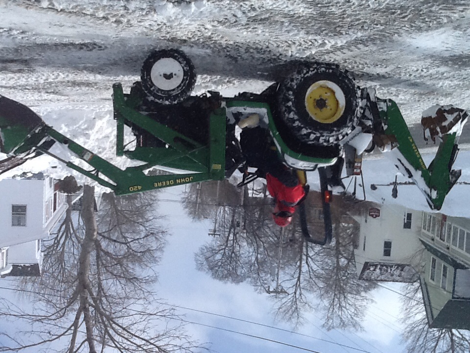

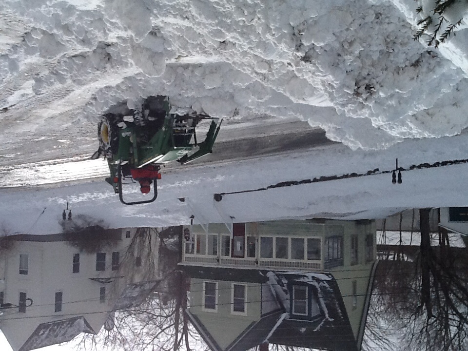

Also, on a separate note, my plastic hood broke when I had the bucket up and some ice fell on my hood. Is their a replacement sheet metal hood out there, or where is the best place to get a hood?
Get the CD-ROM version from Deere...it's cheaper then the hard copy and you can print out the pages you need for a particular task.
There are hoods on eBay. IIRC, they cost about $300.
   / JD4300 glow plug light #22
You may be able to repair the hood with aluminum and pop rivets or try fiberglass on the inside.
To prevent recurrences put an expanded metal guard on the bucket.:)
