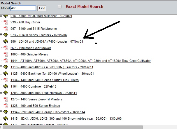

Guess you got onto the wrong track somewhere.
If you go to jdparts.com, then entering 400 in the model search box, this list comes up.
And you are correct that in that list (arrow) it is JD400. Click that and much more than bucket teeth show up. ;)

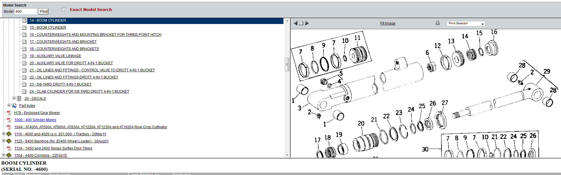

It's the second one, Loader. Under "C", Cylinder Boom Lift.
Are there standard parts, like a rebuild kit, one would normally replace for a leaking cylinder?
/ JD400 Leaking Hydraulic Loader Cylinder #8
There is a serial number & yr model break for bucket cyl repair kit from JD
