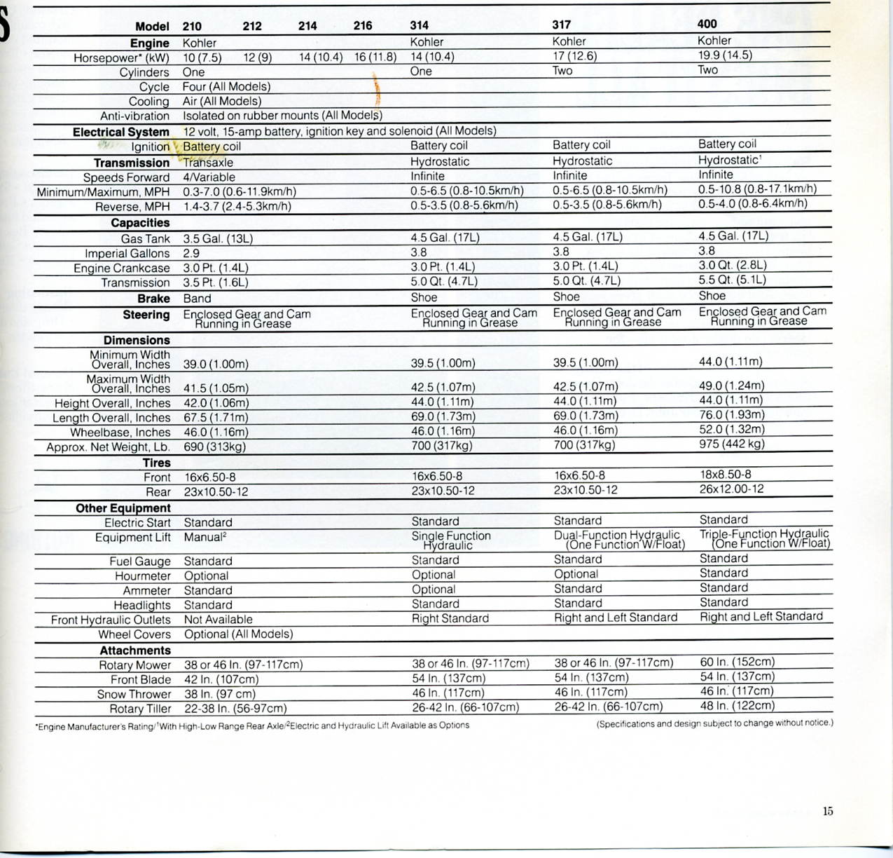

Just for fun. Two pages from a 1990 brochure regarding trade-in value of a 400, and one page spec from 1981 brochure for 400 and others.
The 318 was introduced in 1983, which was the same year the 400 was replaced by the 420. The 318 replaced the 317, and both changed from Kohler to Onan that year.

Anybody remember why 20 hp garden tractors back then were advertised as 19.9 hp? See the first picture in my previous post. This kind of stuff usually has something to do with taxes. Maybe imported engines?
