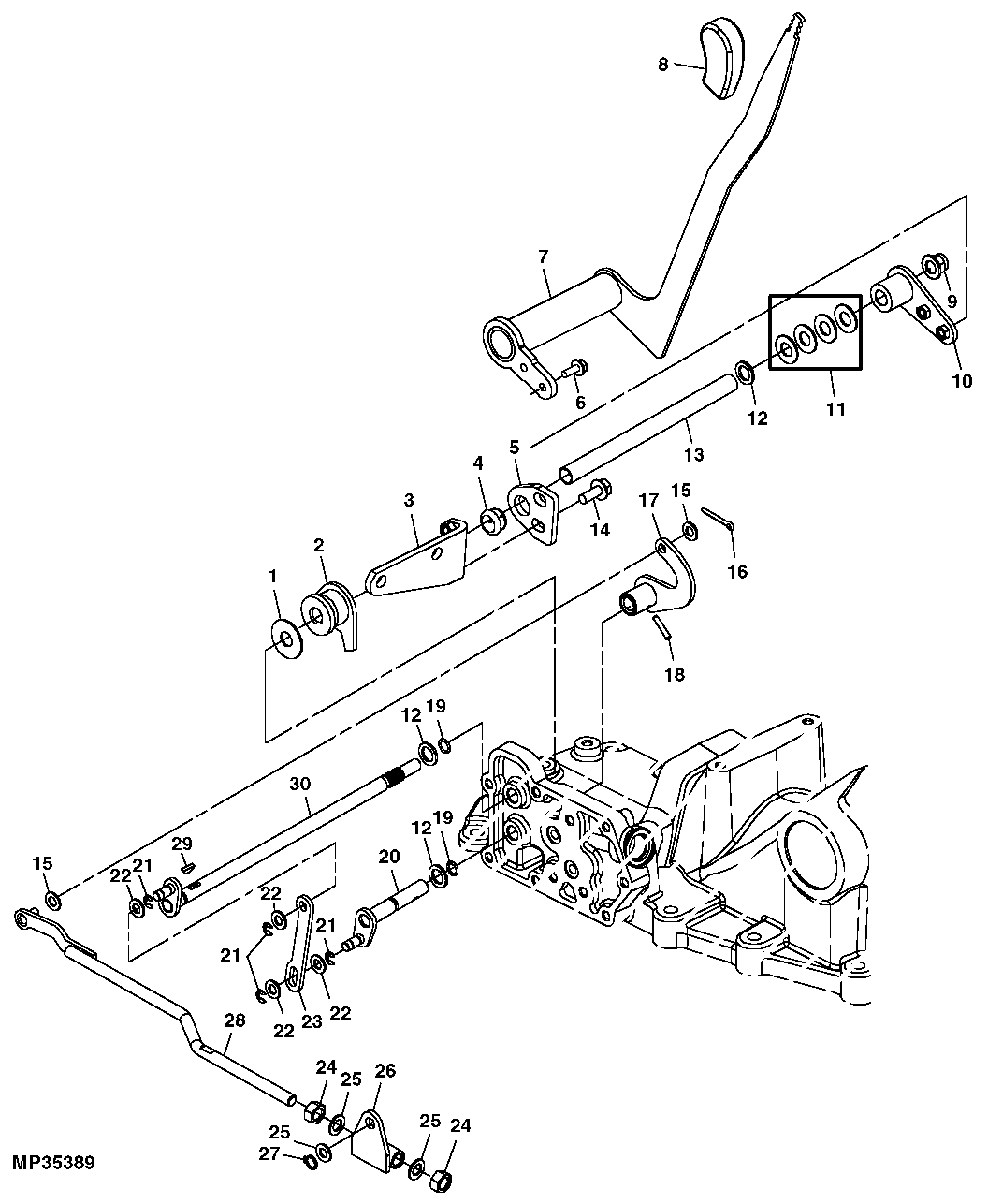

My three point implements will often slowly drift downwards, especially if the tractor is on bumpy terrain. Is there a way to snug up the lever to prevent this? It seems to have gotten worse lately.
   / JD3520 3PH lever needs tightening #2
Most have a lock nut of some type.
That said, I don't use my lock nut. Use a short bungie instead.
   / JD3520 3PH lever needs tightening #3
From the White Album.
Thanks. Now for the challenge of access to those nuts!

Do you see from the attachment above how to adjust the lever, and can give that a try?
