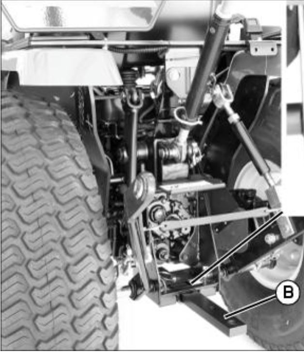

Here is a picture from the manual. Will get actual later tonight
The 18" is length of the levelling arms
Full disclosure the manual picture is not the configuration I have in my tractor, as it also has the links for the drive over mower deck.

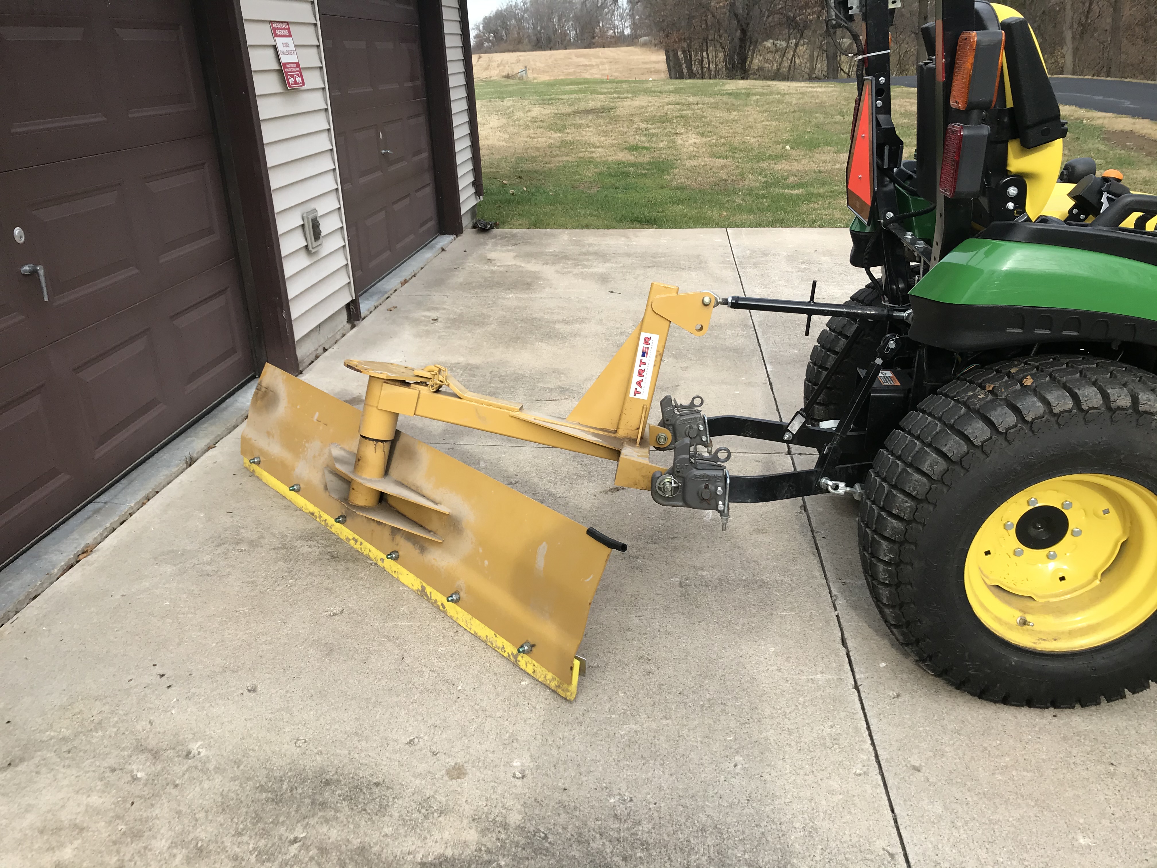

I assume you have the same problem I do with my 2025r where you have limited lift height. In your pic the right side has an adjustable link to level things. You can also get another one of those for the other side and shorten them both up. Shortening the top link helps also but may not keep the box blade level when you lower it. My rear blade was a problem for me, I angle it for snow removal. With it angled right I have to make the adjustable link on the right side really long to keep the blade flat on the ground when lowered. I now have it angled left which means the link is really short and I have a lot more lift height. In other words another adjustable link may give you more lift.

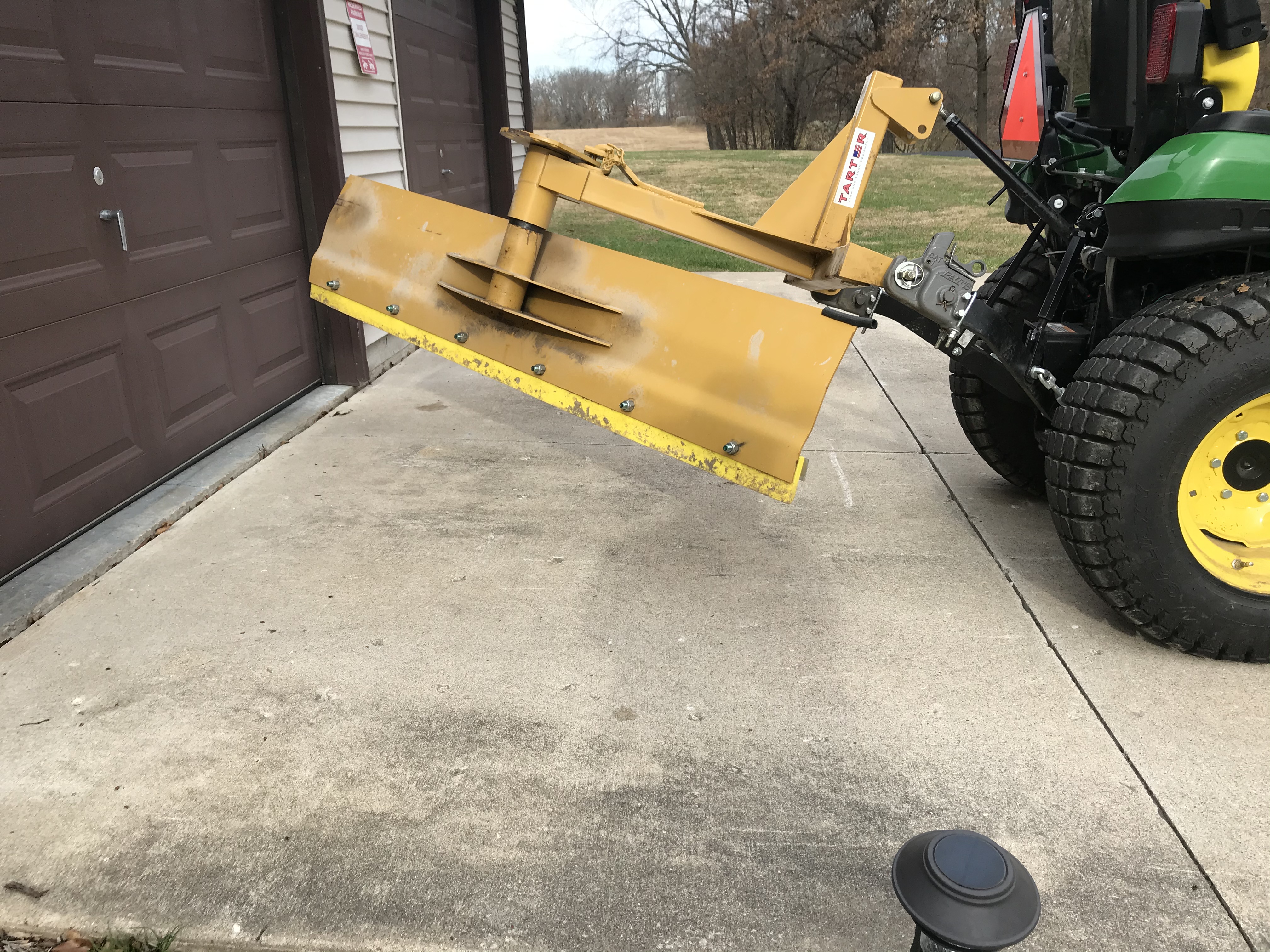

I’m not sure, they would have to be pretty short to not let the implement down. With my rear blade setup for snow removal it lifts pretty high but the angle wouldn’t be great for cutting dirt or gravel. I’m not sure what two shortened links would do to the angles your box blade would contact the ground. I included a pic of my rear blade setup for snow removal and how high it’s lifted. With it lowered you can see how far it is tilted far forward with the short top link.
