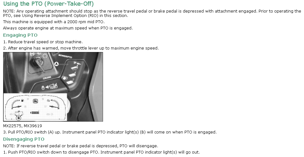

I have a question for you Deere guys. My friend just got a new X720 and was telling me the book says to engage the PTO when engine is at full rpm. Boy, that sounds like a real jolt to everything and tough on clutch pack. Darn near like dropping the clutch at drag strip.
Is this common w/JD or just this series?
/ JD X720 #2
Don't know about the book but I would read the verbage myself to make sure the interpetation is correct. I would much prefer to engage the pto at the lowest rpm possible then increase the engine speed to the pto setting. That is just me.
/ JD X720 #3
Wow, the manual does say full RPM. All the manuals for JD compacts I have seen say to reduce RPM. Maybe the X720 has insufficient power such that engaging at less that full RPM would kill the engine?

Most JD L&G tractors have an electric PTO clutch mounted directly to the bottom of the engine. I know when Deere introduced RIO they beefed up the clutches to handle full RPM engagement as it was obvious people would forget to use RIO and would back up and kill the mower and then immediately just push/pull the PTO switch to reengage the mower deck.
My Dad's 345 was pre-RIO and the manual said to reduce RPM's. My 335 and 355 are post-RIO and both manuals says WOT is fine.
/ JD X720 #11
That's how my old JD 430 clutch worked, and I always lowered the RPM as the manual said to. Your explanation of changes to accommodate the PIO switch makes sense to me.
/ JD X720 #12
The mid PTO on the X700 family in driven off the hydrostatic transmision. It uses an electrically actuated hydraulic clutch. This system provides some cushinioning effect to engagement. My X740 has no problem starting the 62" deck from a full idle (unless the engine is cold). The deck also seems to engage very smoothly at full engine speed (more cushioning effect). I usually lower the RPM before engaging but full RPM doesn't appear to cause any problem.
/ JD X720 #13
I bought an X720 for my dad, which I traded on a 950 and 2320 with 54d combo for mowing at his place and others down his way that I help. I believe this is a statement to appeal to the inexperienced user out there and nothing more. I can tell you without doubt that the 720 will start the mower deck from a dead idle, but probably no one is more the subject of that statement than my dad. These machines have a "cushioned" PTO engagement and one can easily start them at WOT, though I never do. As most of us know, these machines are meant to mow at WOT, or close to it, to achieve the best performance and advertised blade tip speed. When my dad, who is 80 and has some very mild dementia, first used his machine after instruction, he called me to complain it did not cut well. I went to check things out and asked him to repeat exactly the steps he did before. He did, including mowing a couple rounds at idle. I truly suspect that JD recommends this in part knowing it likely would not hurt the machine and to say they instructed owners to actuate and mow at WOT. I still am a strong believer in being no more than 1/2 when starting the PTO and going from there. It is not a matter of power, though, as the 720 has plenty to do this even if one were sitting in thick grass at the time.
