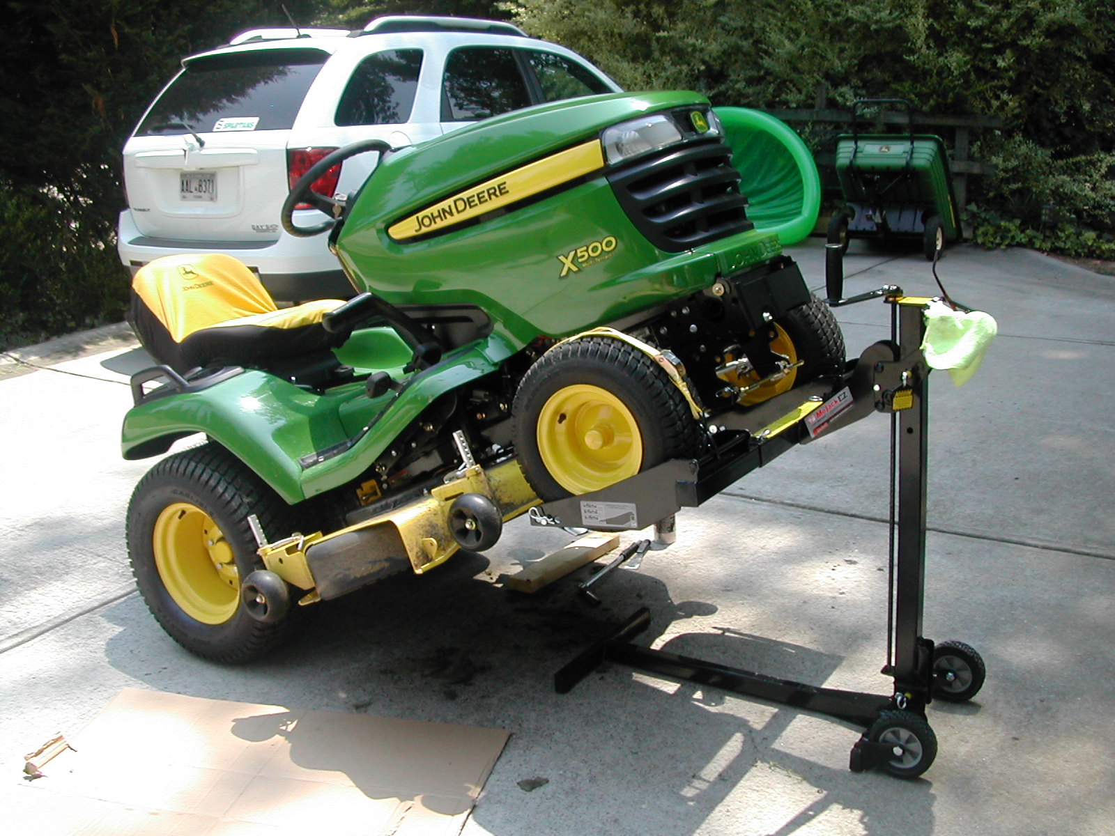

There are several steps involved to remove/install the deck and you should follow the owner's manual to do it properly. If your reason for removing the deck is cleaning and/or sharping the blades I would suggest investing in a Mojack Pro to save your 66 year old back.

i too would suggest the mojack..use it on my x500...they are now on sale at tsc

Thanks much, men. Mojack it is.

/ JD X500 mower deck #13
Makes life really easy!
