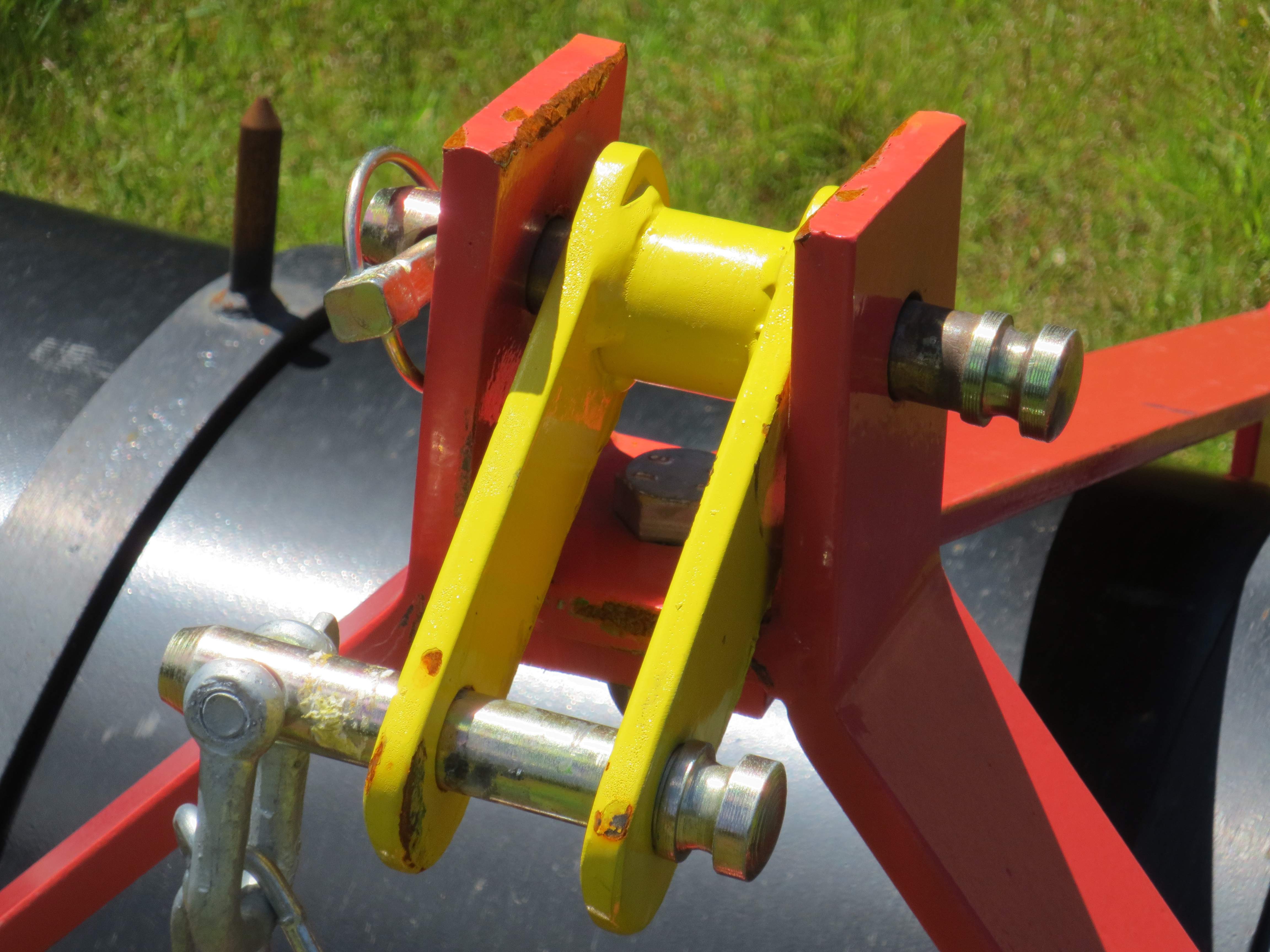

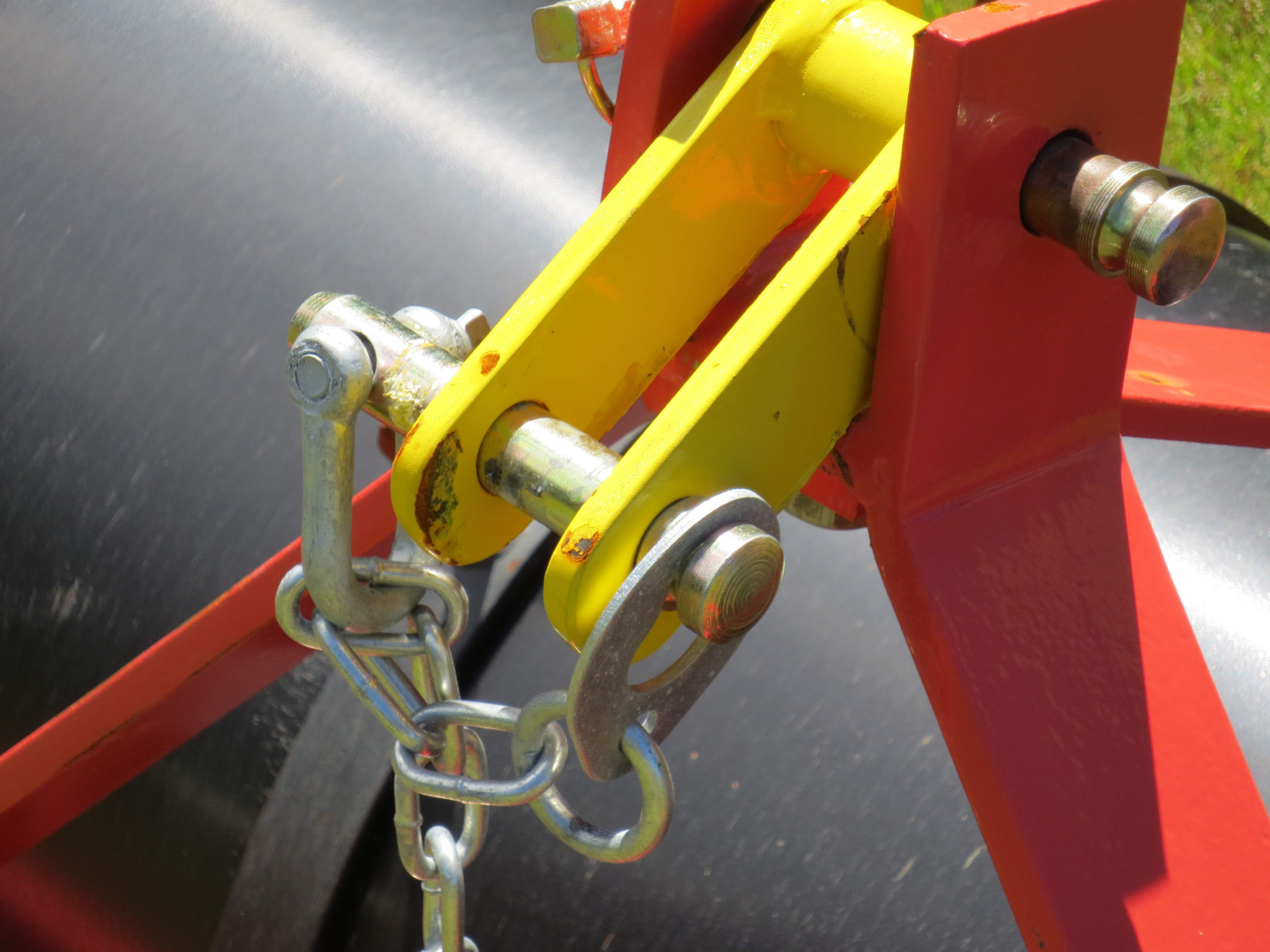

Hopefully 'They' did explain that all of the 3PH implements will require "bushings" for both of the lower connections/'pins'. I also needed to get specific, longer and capped, bushings for my "iMatch" ballast box.
Fortunately, all of my implements (purchased new) fit my iMatch... with one exception. [of course, there's always one exception] My ballast roller/aerator experienced a problem that you're having with the top hook. I solved that with an extension + I added a curb-chain to keep it from popping out.

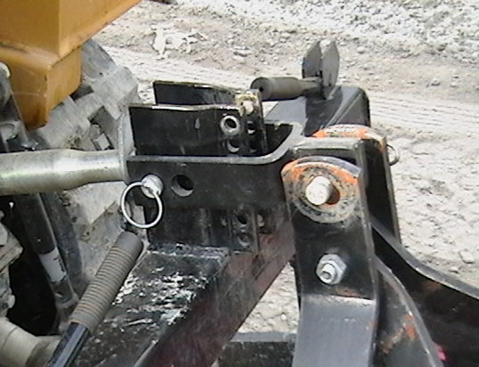

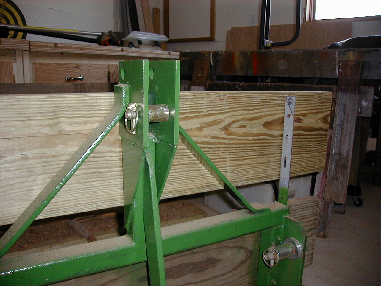

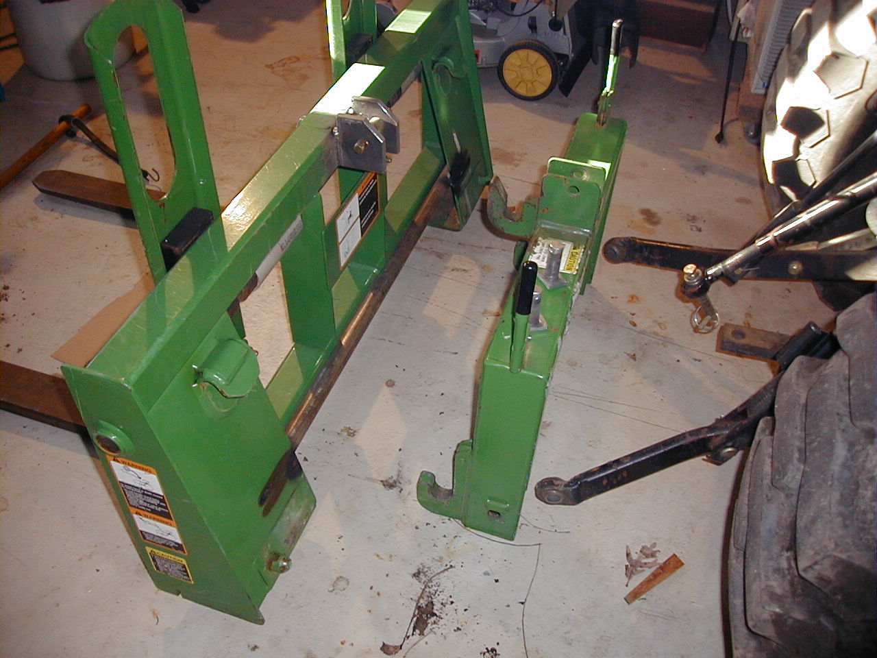

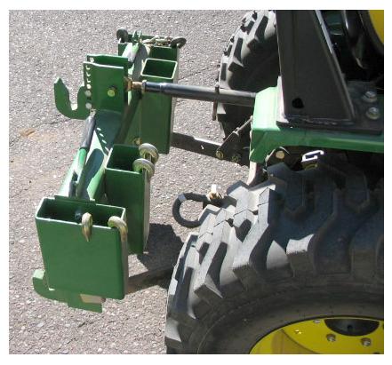

A couple pics of my mods to get my attachments copacetic with the invaluable iMatch.. quick dropping of the ballast box and picking up the forks for moving a pallet of wood to the house when it is below zero F is a real treat.. 5 minute job.
Pic of bushings for lower arms which you may have. There is sometimes a split driven pin to secure them.
Modification added to carry-all for the top hook, showing a bushing.
Mod to my forks to be able to easily attach using the iMatch (having the hyd. top arm is helpful when using the iMatch too).
Some ideas (from other TBN member) for adding "parts" to the iMatch for carrying chains and such.. I also added grab hooks for using the iMatch to pull logs out of the woods.
Hope this helps with your decisions...
