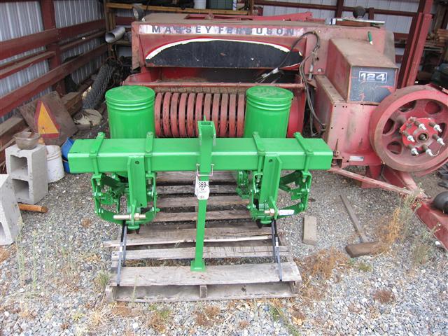

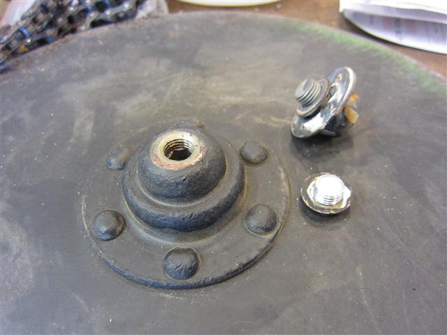

I bought my 71 a few months ago.
I found that the double disc openers tend to clog in my soil (gravely loam). So I removed one of the discs to make a single disc opener. Worked OK. I had a devil of a time getting the hex caps removed so I could get to the hex key bolt that holds the disc to the hub.

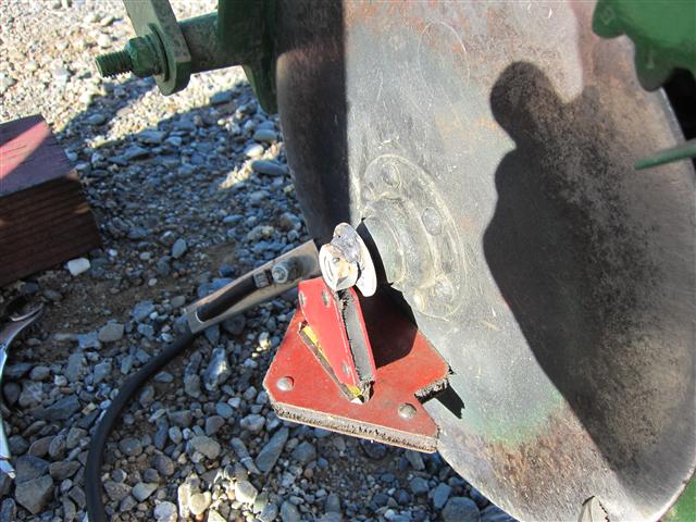

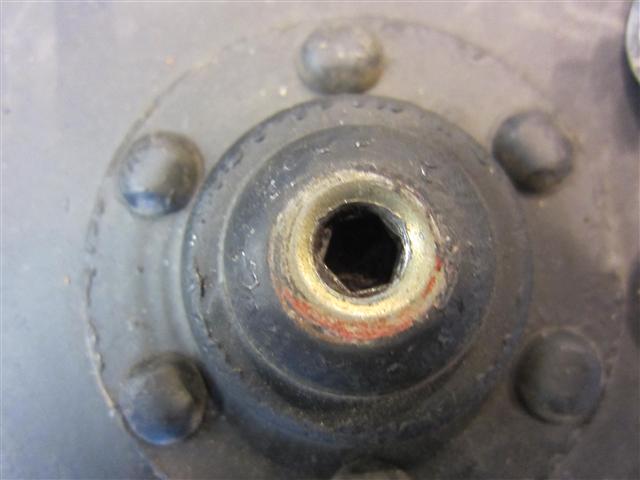

Oops-hit the submit reply too soon.
The heads on those hex caps were very short and the corners of the hex had been rounded over the years. It was obvious that the guy who sold me the 71 never serviced those disc openers. I had to weld a washer and nut to the hex cap to get it off. Did this on three of the four discs. I replaced the hex caps with a longer hex bolt with a beefier head so I can get a wrench on them the next time I need to adjust/replace the openers.

Nice looking unit Flusher!!!

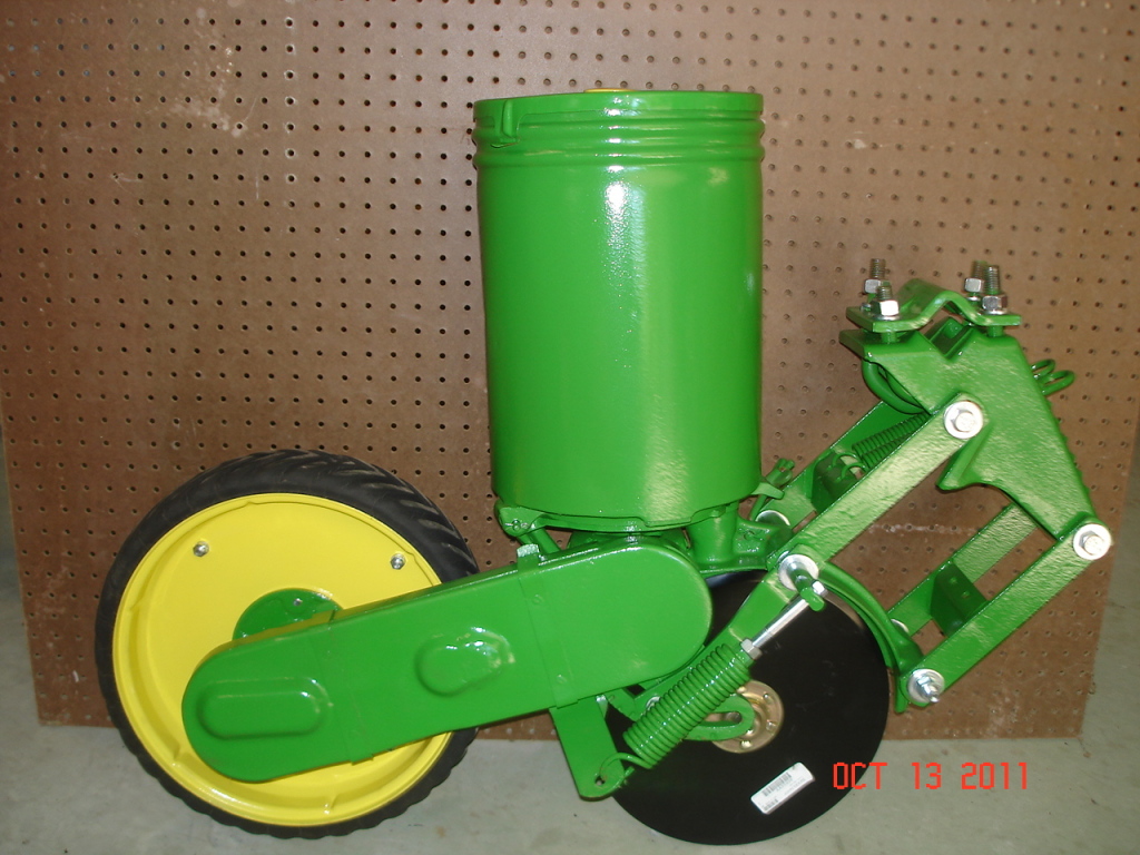

On the 70 Flexi units I rebuilt, there is a thin washer that rides between the disc opener and the seed boot. It's part # M17520, it's listed as obsolete for the 70, but the 71 part #B29159 is the one I used. Without the washers, the new openers ran together so tight, they'd hardly turn. The parts guys at the local JD dealership were very helpful. You can also go here, John Deere - Parts Catalog , and find the parts breakdown for a bunch of JD planters. I printed off a complete set of the parts for my 70s, and took it with me to JD when I needed the parts. Many of the parts for my older 70 Flexis we were able to reference to the same part on a 71, and they worked just fine. Good luck with your rebuild. Mark
