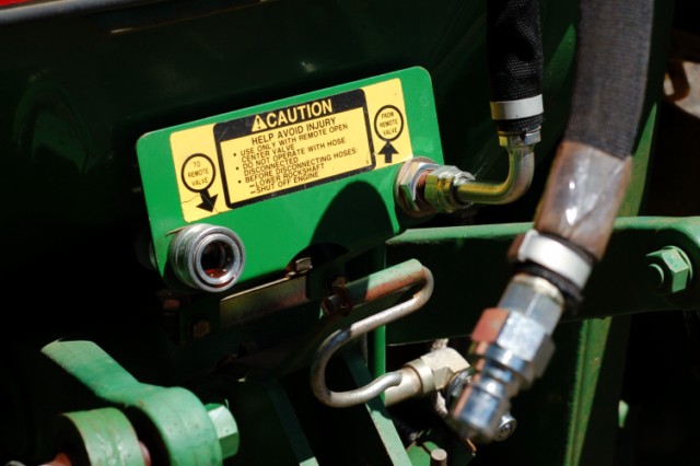

I got the valve and have selected a location for mounting. Now connecting to the Power Beyond...the Inlet to the valve from the Power Beyond is pretty obvious but I end up with two return lines so which one do I connect to the outlet or return on my joystick? Do I use the 3/8" male quick connect that was removed from the supply quick connect or the pipe plumbed 1/2" male quick connect into the rockshaft? Hopefully this makes sense to anyone that has seen a Power Beyond on a JD970. Do they use both 3/8" and 1/2" quick connects so it cant be connected wrong or does the return need to be 1/2"? Without going and looking I believe they are both 1/2" hoses.
I assume that like with the BH I would use the 1/2" male quick connect at the rocker shaft for the return and just leave the 3/8" male quick connect unconnected?
   / JD 970 Power Beyond Plumbing...want to add valve for flail mower side slide cylinder
#16
After further looking I dont see why I can't just use the 3/8" male quick connect (removed from the PB 3/8" FM quick connect) for the return and just use the 1/2" male quick connect for the Backhoe return, it appears that they both end up in the same place. Am I wrong or correct?

I am getting confused...why do you have 2 return lines? Can you post a picture?
#18

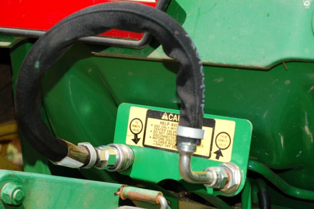

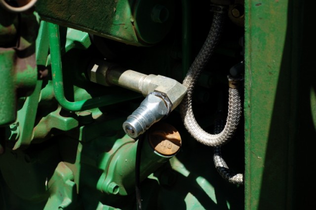

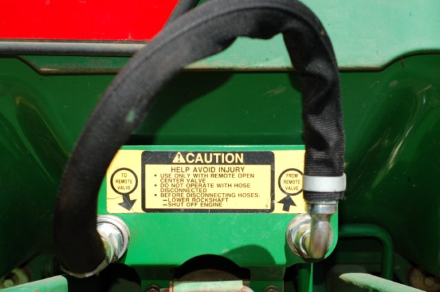

Here are some pictures...maybe one of them is not a return line?
2nd picture shows the 1/2" quick connect that the hose from BH connects to, only used with the BH otherwise it has a dust cap on it. The other pictures show the 'loop' hose...the FM 3/8" QC on the left connects to the BH, the Male 3/8" QC that is left doesn't hook to anything with the BH connected. 4th picture shows 3/8" QC disconnected and ready for BH>

OK, pictures worth a thousand words:D
You do NOT need the other return for the backhoe-it bypasses the 3PH so it's inactive when the BH is mounted.
You only need to plumb the new valve between the "loop" hose and 3/8" QD's.
#20
Ok sounds good. So as long as a person continued to use 'Open Center' type valves you could add more into this same loop right? That could come in handy if I wanted to put a hydraulic cylinder on the backhoe thumb someday.
