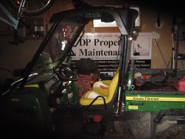

I am thinking of buying a used 850D gator with 500hrs. I have never owned anything like this and would like some input from those who have one.
Are they underpowered
Are they usefull
Are they a good buy or a glorified toy?
Any comments are welcome.
Also what should I look for in a used one.
Not a toy I use mine for jobs all the time and I am commercial business. The 850D gets me back into the thick of things when I need to do bylaw weed control, the 850 cuts my man hour time in half or more, it hauls garbage out of my empty lots that I maintain, It moves leaves into the dump trailer and has a dump bed itself to save your back. 500 hours on that machine and motor is nothing if you get a good deal on it. I do recommend the front strut upgrade to the heavy duty front strut you can do the job yourself (it is so you won't bottom out the front end on big bumps or holes in your landscape) It makes the machine ride smoother and brings the front end up to the same height as the rear. I loved this upgrade. It is also plenty fast enough for me and when you want to use it for a toy it is still fun but a real workhorse. The 850D in my opinion is a much better machine then the 620i I have read to many bad stories about the 620i mixing oil and gas.
Most important thing is maintenance records have oil changes and filter changes been logged, was the previouse owner a cowboy who beat the **** out of it or was it used for commercial operations these are questions I would ask.

I just love it!!!! So easy to get in and out, goes plenty fast rides smooth etc....etc...:D:D
The front strut up grade???? How much does it pick up the front.?
Any chance I can get a side view of yours farther back so I can compare. I don't know if I have the heavy ones or not.
/ JD 850D Gator users #35
I think you get about 4 more inches in the clearance between the top side of the front tire and the inside of the front fender it becomes the same as your rear tire clearence. Stock the Gator sits a little low in the front you can tell if you look at your machine and the front sits lower then the rear. If the front is as high as the rear then it may have had the upgrade. If you ever find when you hit a decent size pothole with some speed and the front bottoms out into the fender then you have not had the upgrade because with the heavy duty front strut this never happens. I will get you a picture of the side of the gator further back this afternoon.
