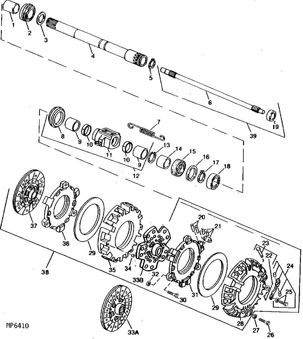

Well I did some more research on this. I priced out a replacement clutch from John Deere on line. Part# AM878710 cost $1976.27 not including shipping and handeling!!! This is for the entire clutch minus things like throwout bearings and assorted stuff that should probably be replaced at the same time (OUCH). To replace just the Drive Disk P/N M802499 they qoute $275, and for the PTO Disk P/N M804454 another $295. Now I would hate to cheap out on this and only replace the Disk/s to later have additional clutch issues in the future. Lets face it, the labor to split this thing has got be a sizeable chunk as well. I guess this is what happens when purchasing used. I will think this through some more. ANyone know of a good Tractor Mechanic that hangs his/her shingel in Nrothern Vermont?

I have found a rebuilt clutch for little less than half of a new one. (now things are getting a llittle more reasonable). But I still need to locate the special tools needed, the Clutch disk alignment tool and Finger height alignment tool. I could probably just turn down a piece of shaft on the lathe for the disk alignment tool and mimic the transmission input shafting, however I am unsure of the Finger alignment tool. This too could be made pretty easily, if I had the proper demensions. JD parts on line list these puppies out at $63.53 and $72.17 (not in stock either!). Not trying to Cheap out here, it's just that this project was not in this year's budget, So I need to keep it as low as possible before presenting this to the family Finance officer, if you catch my drift.

The job I did on mine was a couple of years ago but I used both the inner and outer drive lines as the alignment tools, worked perfectly. Removed these to change the throw out bearing and springs anyway. Setting the fingers on the pressure plates was done with a square and, again, turned out perfectly, no special tools needed. Yes, I did get my clutches and pressure plates rebuilt localy and it seams I paid less than $130 for all. Time has a way of changing prices though. Even if you buy a alignment tool and a setting ring you will still be way under the cost of having someone else do the job and you will have the tools for the next clutch change. Think that will be many years in the future though. If your tools are limited or you don't have a place to work, might want to think about paying for the work. Good luck,

It looks like your pto clutch disk is rusted on to it's drive and driven plates from none use over a long period of time. This is not unusual on tractors, especially the Yanmar built JD's. A lot of clutch disk's have metallic wire woven lining's that simply rust up to their drive plates with a little bit of moisture.
Before splitting tractor try to break disk free by doing what you did earlier
(running down t/o bearing adjustment all the way). Then put on a pto drive shaft (bush hog, etc.) and finding a way to lock the shaft up (long pipe wrench etc.). The next step is to bump the starter and hope that this will break disk loose. And even better way is set tractor, with bush hog over a large grass clump and then lower hog unto the the clump while holding clutch pedal all the way down. Hopefully this high shear load on disk may break it free.
Also, when lining up tractor bell housing to engine it is helpful to get at least 4 extra long coupling bolts, cut their heads off and use them as dowels for lining up the two faces. Chamfer ends and put two blades on hacksaw and cut a screwdriver slot on dowels for removal. This will make the job much easier. Be sure to keep the two flanges equally parallel all the way around housing while bringing it together.
On height adjusting tool, be sure to measure finger height on old clutch before disassembling and set new one the same or close (new disk will have less) and you should be ok.
On the spline alignment tool, universal clutch alignment tools are made by Snap On and others which use variable tapered nose's. These are not as good an OEM pilot tool or shaft but will do most of the time.

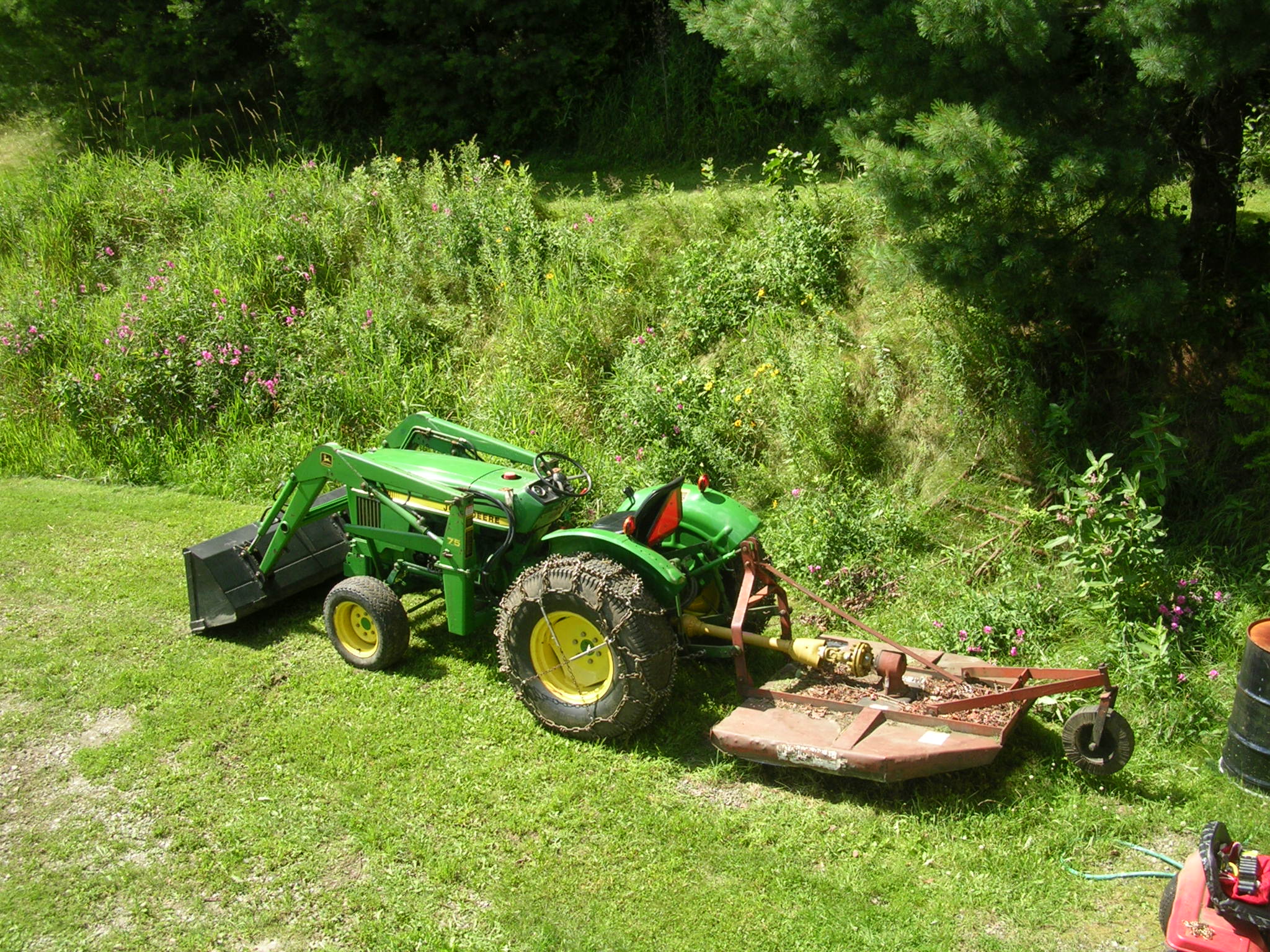

First I tried lowering the Brushhog on to a few maple trees while holding the clutch all the way in. This attempt did not break the clutch loose.
I was able to disengage the PTO clutch by over adjusting the clutch pedal linkage. Unfortunetly, with the linkage over adjusted the driven clutch was disengaged all the time. I did this to make sure that the PTO clutch disk was not frozen to the fly wheel. When I bought the tractor (used) I was told that it was mainly used as a loader. I suspect that the driven clutch disk is well warn from this use and has been adjusted out to its limit. Your suggestion on the extra long bolts used as dowels is a good idea. I'll have to remove one of the bellhousing bolts as a sample and go visit my local metric bolt supplier.
