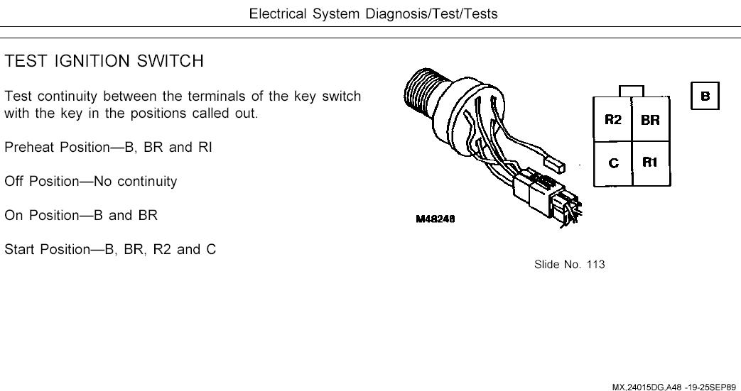

I found a wiring diagram in another thread. Awesome, by the way, thanks. Does anyone have a detail of the ignition switch and its contact tables?
Right now, I'm leaning towards a bad intake heater or an internal fault in the ignition switch grounding everything out. I'd like to confirm that, if anyone has details on those two components.
Here is a test procedure for the ignition switch from the tech manual.

beenthere, that page is great! Thanks.
