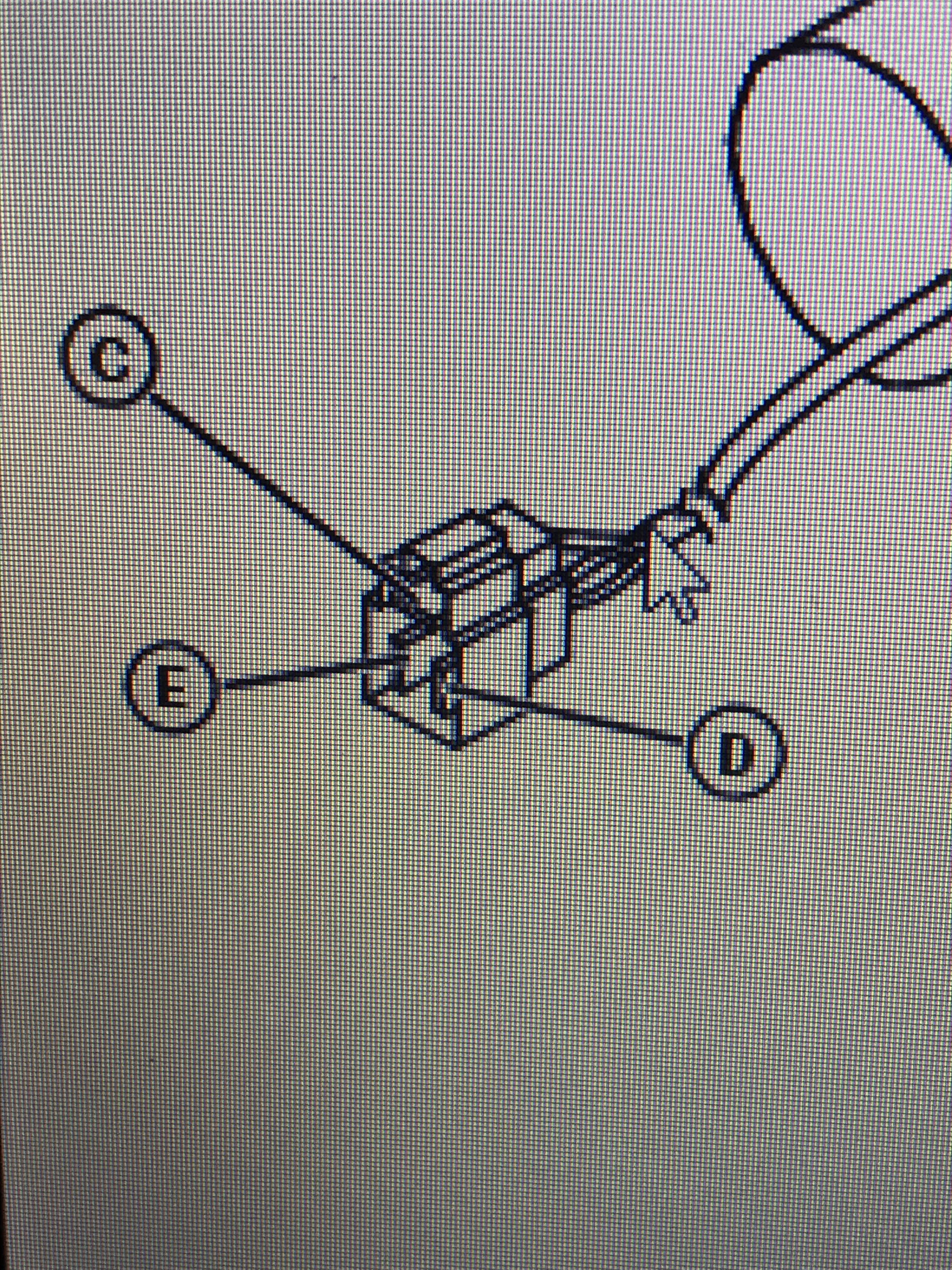

How many terminals in your solenoids 'Pigtail'?
There are two (2) circuits in the Fuel Solenoid. You tested the 'Pull' circuit. It "Pulled".
There is also the "Hold" circuit. There are literally hundreds of posts on here detailing 'Pull' & 'Hold'.
Reads like oil has got past the seal on the plunger pin. You can press the plunger with your finger a few times and purge the oil out as a temporary solution.

So check the resistance on the terminals in connector. Should be 3. See pic.
As stated in Tech manual some numbers don’t match so this is what you need to see if your solenoid is good.
Fuel shutoff solenoid—
C to D ..........0.5 ohms
C to E ..........23.5 ohms
D to E ..........23.5 ohms
