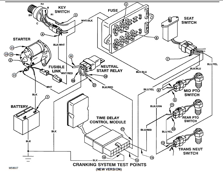

I'm new to this forum, and I know the JD 770 is an old topic, but I have a PTO problem and could use advice. I recently bought this tractor (1990) with a JD model 70 loader, and about 2200 h on it. It has 4WD, and is in pretty good shape, both cosmetically and operationally. I've been using it for a couple of months for general dirt moving and other duties, with no problems. I was attaching my snow blower when I discovered that, even with the clutch all the way down, all I got when pulling up either PTO lever was gear grinding. Of course I stopped pulling on the PTO lever! The first advice I got was to adjust the clutch free play. I found that the clutch linkage was already as short as it could go. I've read that the clutch plates sometimes stick, but when I push down the clutch pedal, I don't "feel" the second clutch. Other than pulling the tractor apart - which is not likely to happen this winter - I can't think of anything else to try.
One mechanic suggested I defeat the rear PTO interlock by pulling apart the connector and installing a jumper. Then I could start the tractor with the PTO engaged, if I made sure the PTO would turn freely first. He directed me to the interlock on the right side, below the PTO output shaft. I tried this, but the tractor still didn't start if the rear PTO was engaged. I see there is a second interlock switch on the left side, below the seat. Haven't tried that one yet.
Does anyone have a suggestion? Do you know which interlock switch does what?

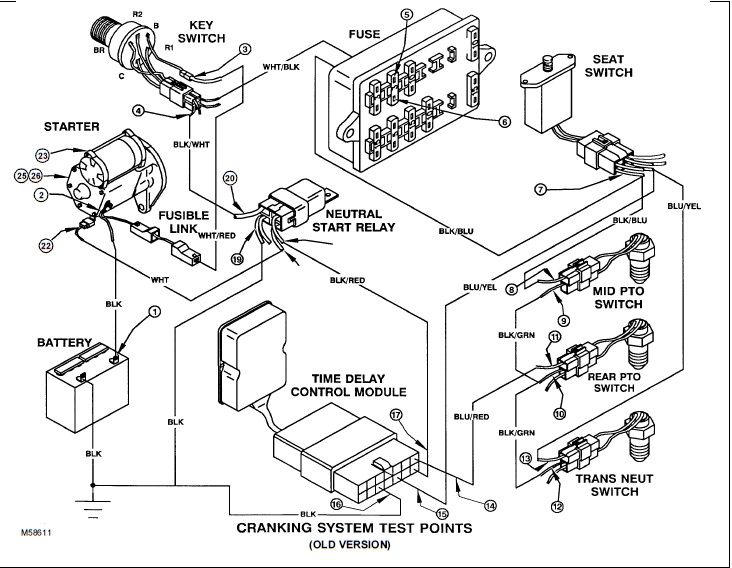

If it may help, here are the 770 electrical circuit drawings (old version and new version) from the tech manual showing the interlocks. Ignore extra image, can't delete it for some reason.

The pto interlock is the one on the left side under the seat. Since you don't feel the second stage on your clutch, most likely the transmission clutch is worn out. That is one disadvantage to the two stage clutch. Typically, most people wear out the transmission clutch much faster than the pto. This makes the relationship between the two to get out of sync. The only adjustment you can make on the outside is free travel. If you could get to the pressure plate, you could readjust it to make it work properly even with a worn trans clutch. Unfortunately you need to split the tractor to get to the adjustment and it would be foolish to not replace the worn clutch while it is apart.

Now I need to get the motor started with the rear PTO engaged. I tried one interlock switch to defeat the PTO interlock, which didn't work. There's only one left. Thanks.

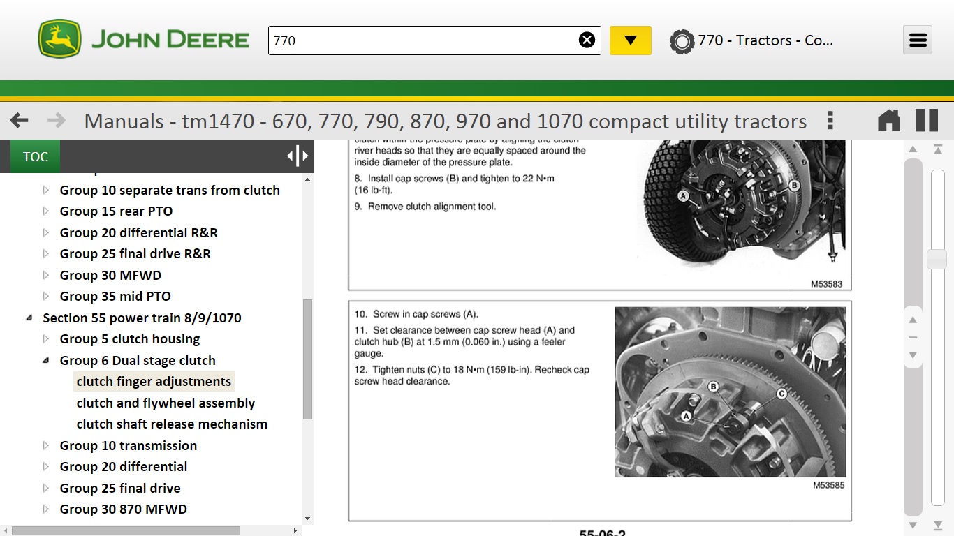

I770 clutch.jpg had forgotten there is a screen on clutch housing on the 770. On the 870, 970, and 1070 I have adjusted The pto though the holes in the clutch housing. I am attaching the picture of the adjusting screws. If you can see theses screws (3 of them) through the hole and can get wrenches on them to adjust them, you can get it fixed without splitting the tractor. Adjust these three screws to .060" under the head of the bolt. You will probably find this clearance now more than that.
/ JD 770 Can't engage PTO #15
If you can see that the pto clutch is releasing then I'm thinking that the clutch disc is rusted onto the flywheel. If that is the case then forcing a strong pointed knife between the flywheel and the clutch disc while holding the clutch pedal down might be enough to release it.

IView attachment 405426 had forgotten there is a screen on clutch housing on the 770. On the 870, 970, and 1070 I have adjusted The pto though the holes in the clutch housing. I am attaching the picture of the adjusting screws. If you can see theses screws (3 of them) through the hole and can get wrenches on them to adjust them, you can get it fixed without splitting the tractor. Adjust these three screws to .060" under the head of the bolt. You will probably find this clearance now more than that.
jd110 - Thanks for the photos. Very helpful. I might be able to get to those bolts. I haven't figured out how to turn the assembly more than just a little using the PTO. If it were a gas tractor, I'd take out the plugs, but with the diesel, hand-turning the engine is a problem. We're going to have a few days of very cold, bad weather, and I'm working outside. When the weather improves a little, I'll give this a try. I might be able to "bump" the engine around with the starter. I saw that your photo is from the TM1470 manual. I went ahead and ordered the manual on CD from John Deere. Thanks.
