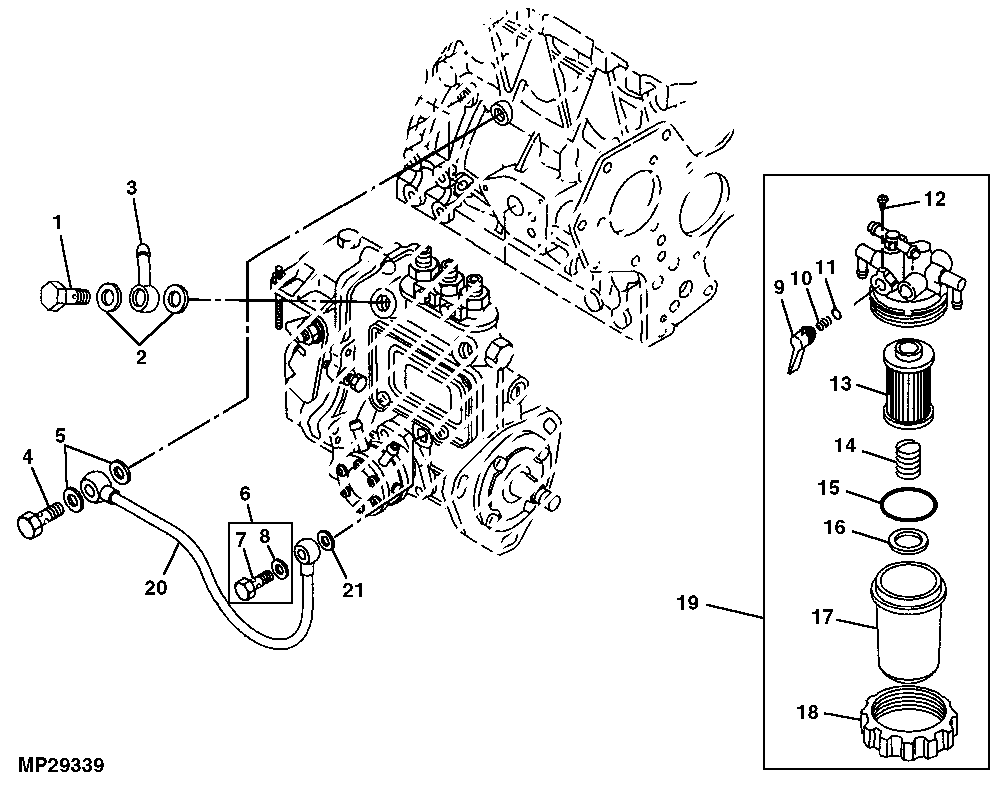

No, no.. Just the filter element. Pleated paper thingy. Install with the hole in one end upwards. It fits on the stub in the top of the housing head and will stay there while you fit the bowl and screw-ring over it.
I have seen several fitted upside-down. (Don't ask...) :eek:
What happens if installed incorrectly? Curious, as don't think I've been aware of the fitting to the stub on my 4300, but do see that one end of the filter is open (hole) and other end closed.
   / JD 755 Project #33
The 'hole' fits over an O-ring on the stub which is the outlet to the injection pump.
Push it up. If it stays up, you're good. If it falls off try again...
With the bowl fitted the filter element is pressed up by the spring for security.
Diesel fuel enters the filter bowl, passes through the filter paper and is drawn up the middle to the IP.
Upside down - the closed end sits against the outlet hole in the stub, pressed up by the spring again but blocking the outlet, nearly. It usually sits a bit crooked and fuel can pass but it is not filtered as it, effectively, goes around the outside of the element.

In the 4300 you have the benefit of the 'Red Ring' which indicates the presence of water when it floats up off the bottom of the bowl.
Item 16 >
The central hole in the 'top' of the filter element is also shown here:
I mis-wrote. :ashamed: The O-ring seal is in the 'hole' of the filter element. It grips onto the outlet stub.
