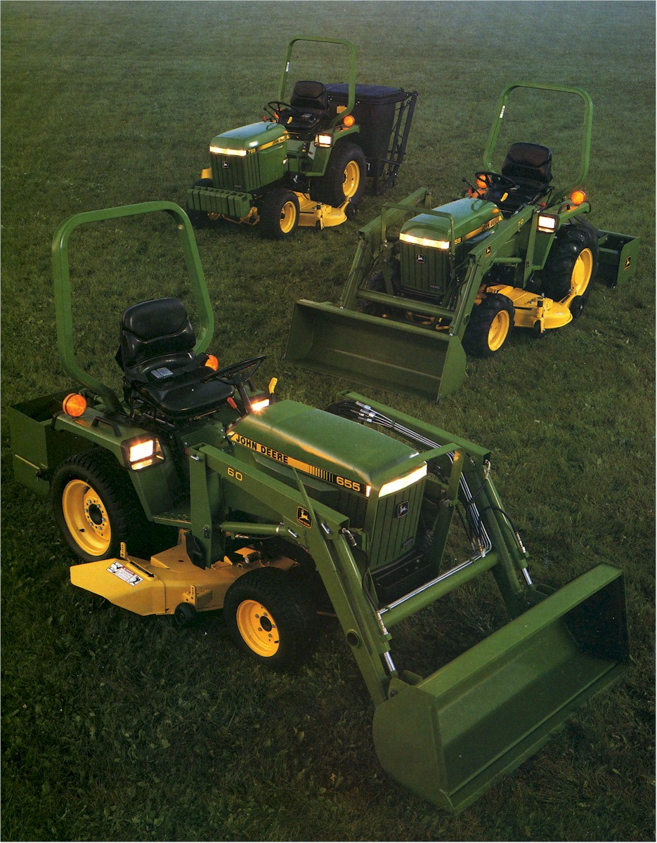

Looked at a 655 with a 70 loader on it today. Whats $5350 for it with almost 1200 hours and a new Howse 4' box blade. The loader seems to be in good shape, the bucket may have been replaced or at least the edge recently.

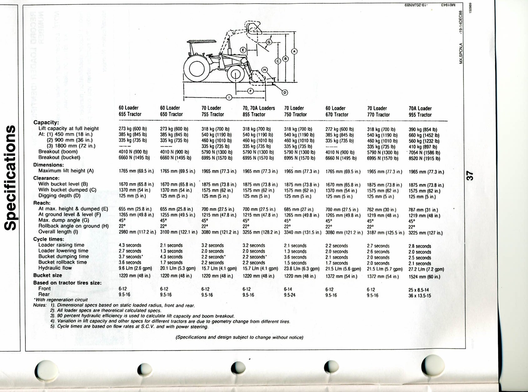

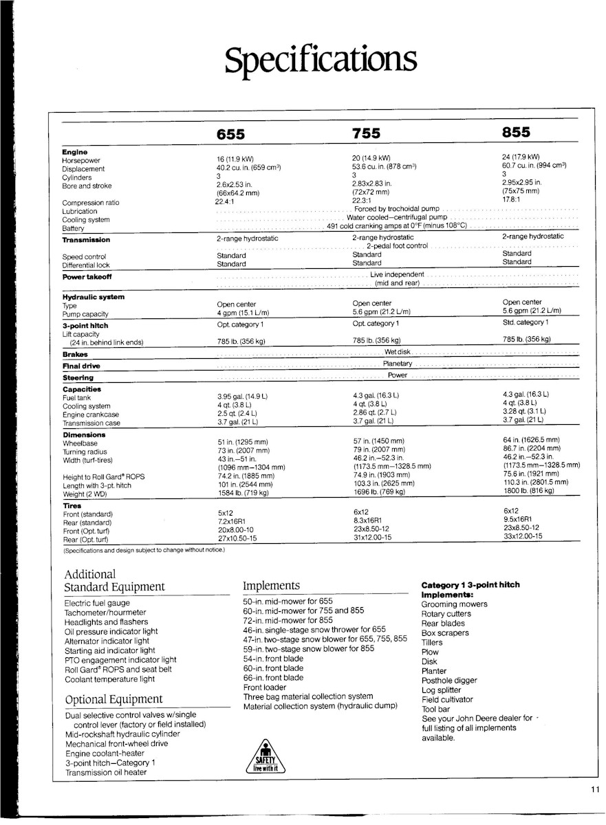

I doubt that is really a 70 loader. The 70 loader is designed for the longer wheelbase 755, just as a different model (70/70A) is used for the longer wheelbase 855. The 60 loader fits the 655 and 650.

Some specs on the loaders....
