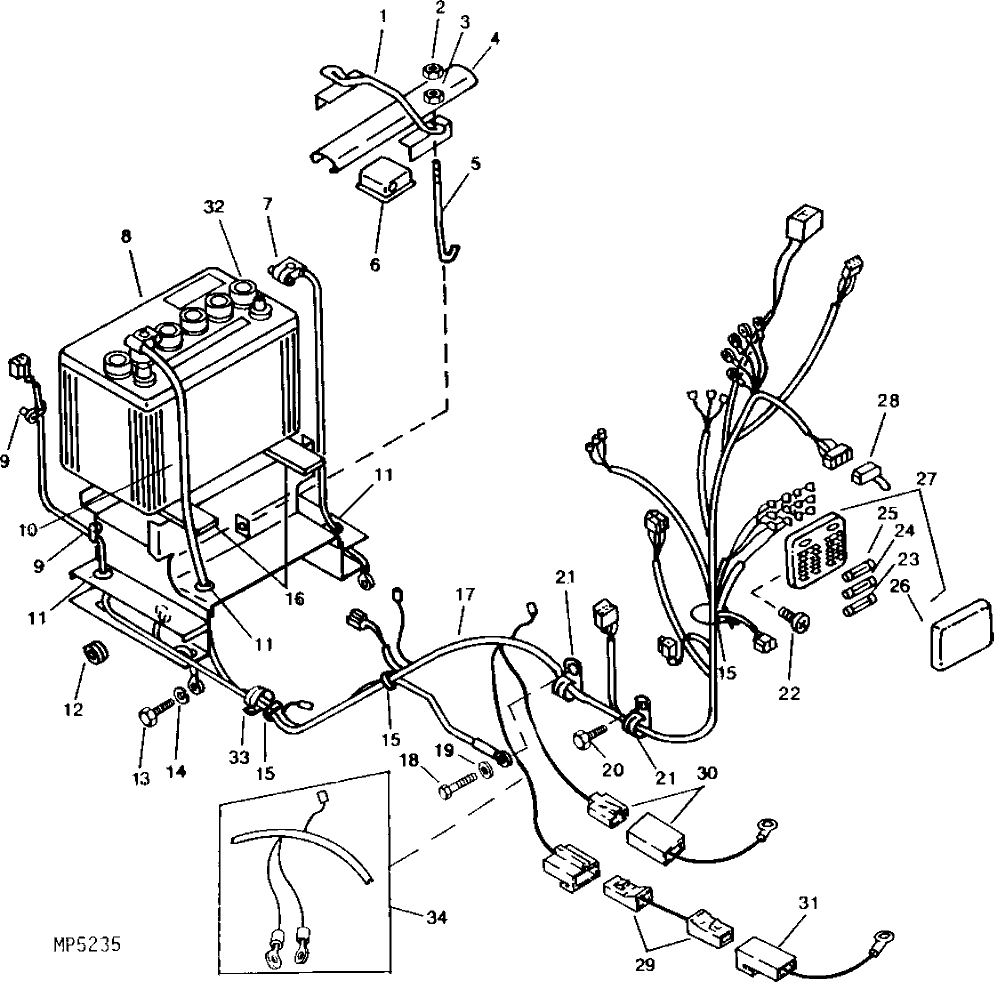

JD 650/750's came from factory negative ground on battery. Parts key # CH15195 Cable POSITIVE

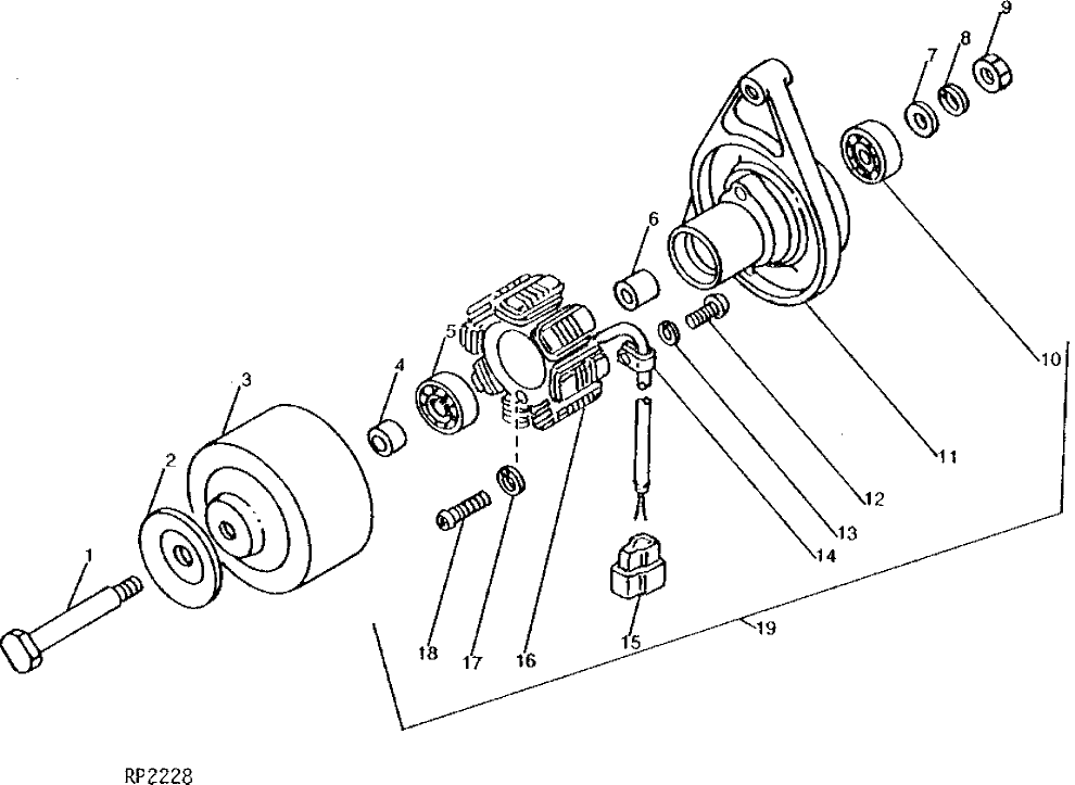

   / JD 650 Battery Polarity Issue #13
I'm not trying to argue either but there are very,very few positive ground alternators and I think the one on the 650/750 isn't one of them. MIA10312
