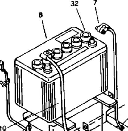

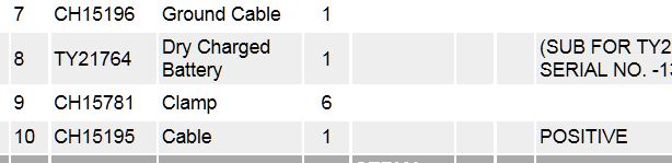

John Deere Parts clearly shows the US market 650 tractor with round, top battery terminals has a negative ground. The parts description indicates the polarity of the non-grounded cable that connects to the main cluster. The Euro version is also clearly negative ground.
There is a china model having flat battery terminals that could be positive ground. So, are your battery terminal flat and are the frame and fenders heavily corroded? Also check to see if you have 3 forward gears and 9 reverse gears....:laughing:
   / JD 650 Battery Polarity Issue #24
JD 650/750's came from factory negative ground on battery. Parts key # CH15195 Cable POSITIVE

   / JD 650 Battery Polarity Issue #25
Could you post the parts key that corresponds to the parts pic you posted earlier?
Thanks,
CM
parts key #7 ground cable
parts key #10 cable positive CH15195
