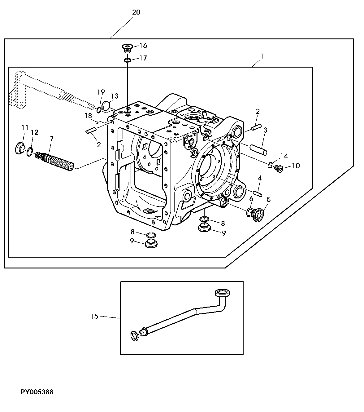

I'm trying to find find the drain plug with the intake screen on my 6420 syncroplus 12-4transmission. The ops manual shows it on the right side. On page 115-3. No. 7. Does anyone know where it is and what it looks like. Thanks

Can you post that page?
My guess is a round plug with an inverted hex. Behind (to rear of) the filter, below the right axle housing.
/ Jd 6420 syncroplus trans question #3
When standing behind the tractor looking forward, it is just in front of the left axle housing near the bottom. The plug is over 2 inches in diameter and you will need a 7/8" socket to remove it. The plug is made from a type of plastic, so I recommend a 6 point socket.
Actually from the picture I just found, maybe I'm wrong. It looks like it is on the left side in the same area I mentioned. The screen is #7 in picture and plug is #11. On a 6400, the plug to remove is #5.
