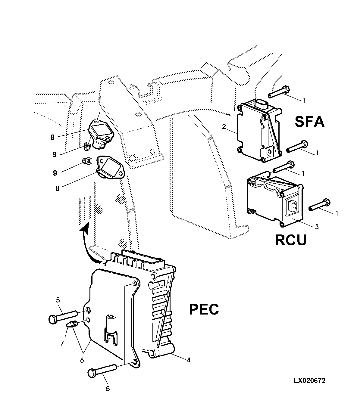

Can anyone help me locate the RCU unit?
/ JD 6410 Power Reverser Problems/Won't Move #13
I assume cab tractor
#14
Yes, cab tractor!
